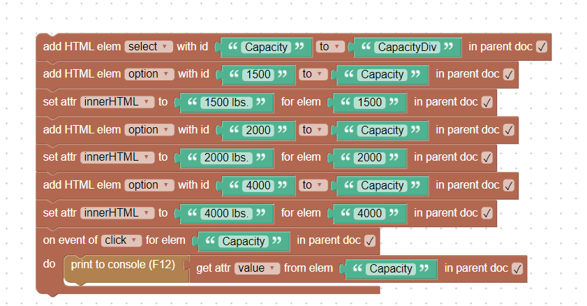

    This is probably a newbie question. I am adding an HTML element ‘Select’ and building the drop down content ‘Options’. How do I get the ID of the Option returned. I can get the value easily, but not the ID of the option selection. Screen shot of some of the puzzles below.
    Thanks,
    Jon

    You might employ the new exec script puzzle that is available in version 3.4 preview.
    So you can put the following into this puzzle:
    var mySelect = window.parent.document.getElementById("Capacity");
    VARS['myVar'] = mySelect.options[mySelect.selectedIndex].id;
    In puzzles, create a variable with the name myVar, to which the ID of the selected Option will be saved.
    #32707
    jdock
    Worked perfectly. Thanks!

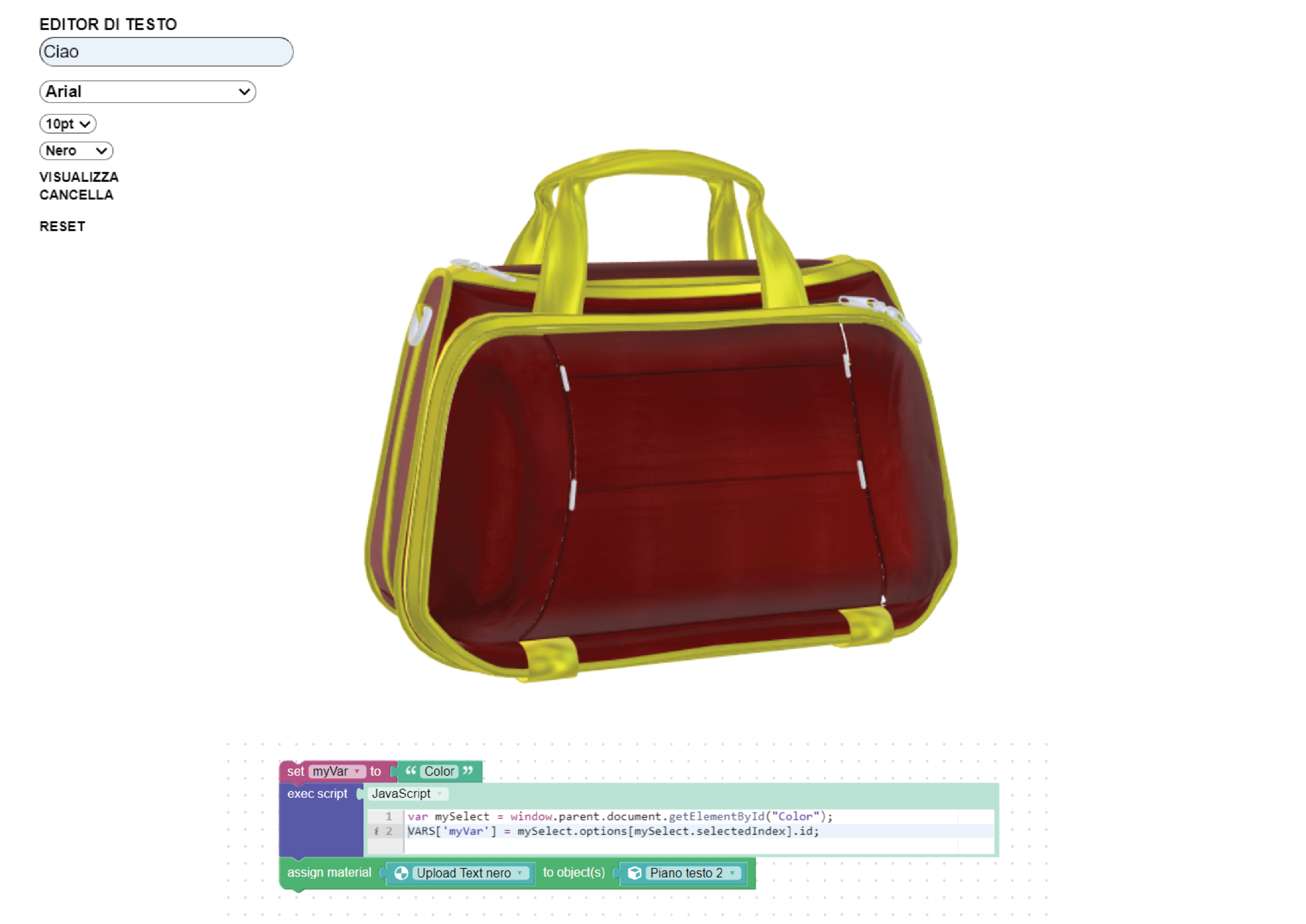

    hi,
    i’m trying to do it but i can’t.
    I have to get the ‘Nero’ entry working with which you can change the color of the text.
    I tried to recreate the recommended code, but I don’t understand where I have to put my options, in this case the ‘Nero’ id.
    Where am I wrong?
    Thanks

    kreattiva
    Hi Yuri,
    the text editor works.
    The problem is that the elements in the drop-down box (example: black, white, red…) do not work.
    The other items outside the box work perfectly.
    Fonts work thanks to Verge3D puzzles.
    I assigned an ID to each of those elements (example: black, white, red…) but I can’t get Verge3D to understand it.
    I tried to do what you recommended above but it didn’t work.
    I attached the photo of the problem in the previous message.
    How can I fix it?
    Thanks

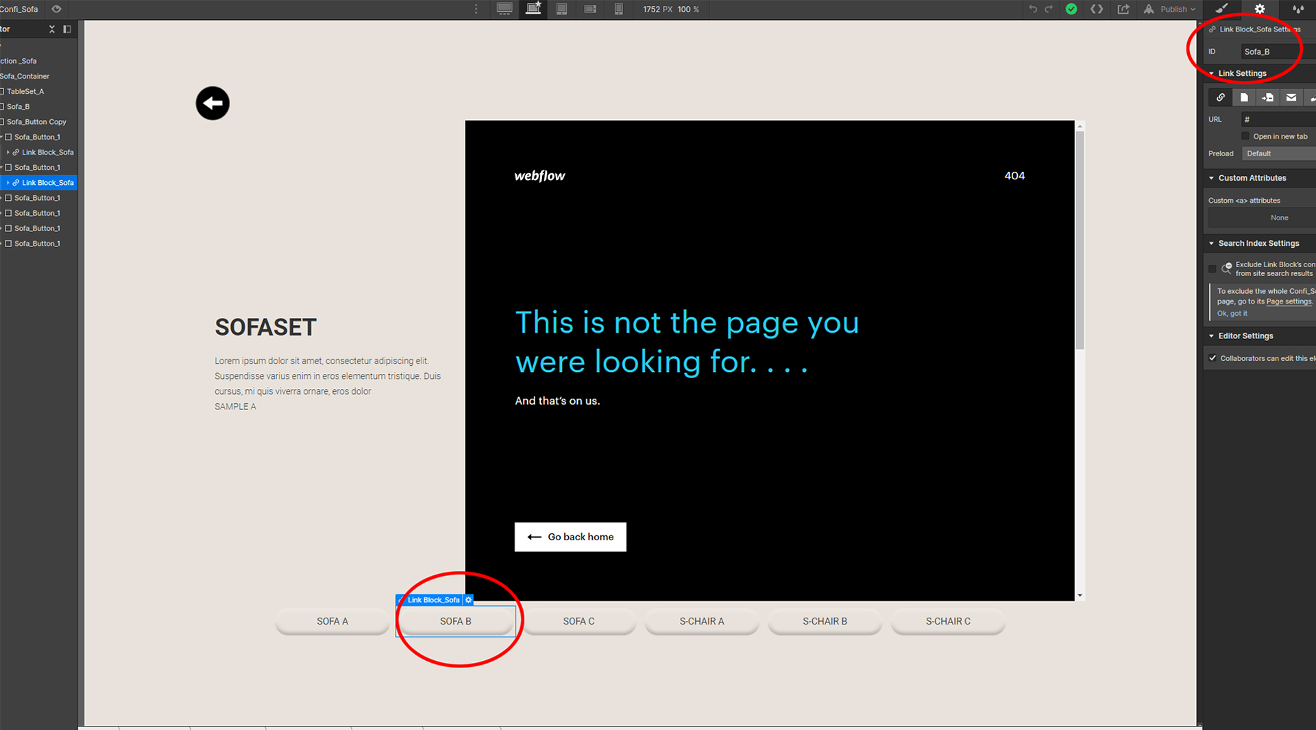

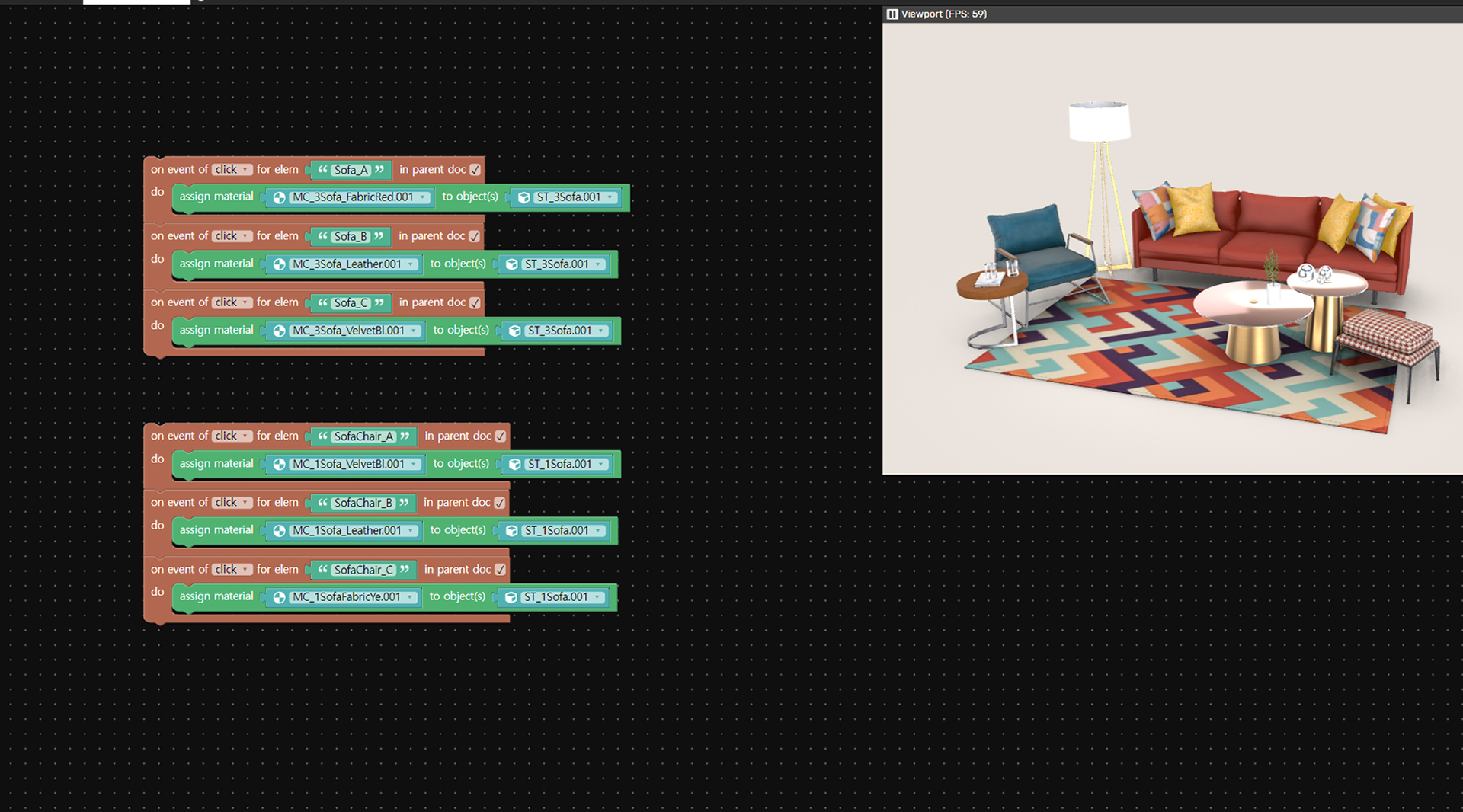

    I have a question for the masters.
    I’m working on changing the material through the ID value set in the Web Editor (WebFlow), and when I click the button with the ID, something works fine and something doesn’t work. I don’t think there’s a typo, but I don’t know where the problem is.
    Please. (I’m not good at English)
    You can check it out on my homepage
    http://www.widat3d.com
    Configurator -> sofa
