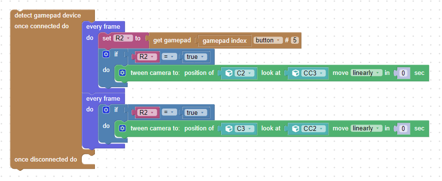

    hello, i’m preparing a demo that uses the gamepad, i would like the buttons to be pressed only once, now when pressed the action is pressed infinitely, how should i set it?
    Thanks!
    #62096
    cralex75
    The problem is that the every frame function passes all the commands directly, I would like them to be passed one at a time for each single click of the gamepad button.

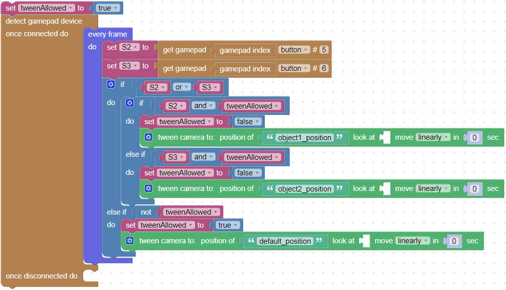

    #62098
