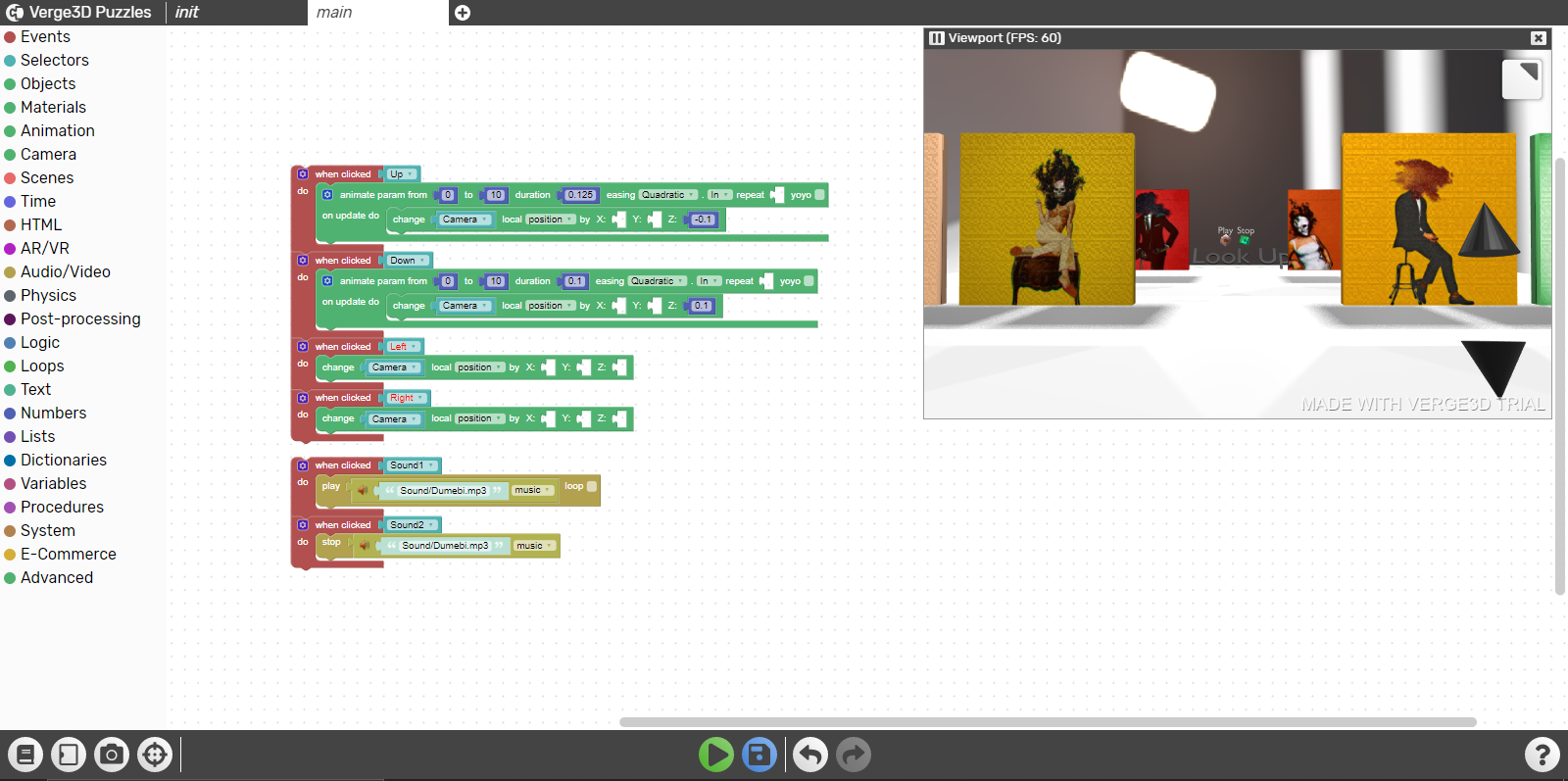

    ma77hew
    I have also looked for configuring WASD controls like this but cannot find the exact puzzle piece.
    https://www.soft8soft.com/wp-content/uploads/2021/11/puzzle-set-camera-param-keyboard-controls.jpg
    #49165
    hi,
    you can download an FPS example using the link in the blog post
    #49181
    ma77hew
    Ok, so I’m assuming that it is this puzzle set under “Main” that I can replicate on my own project to achieve WASD control? `
    #49197
    yes

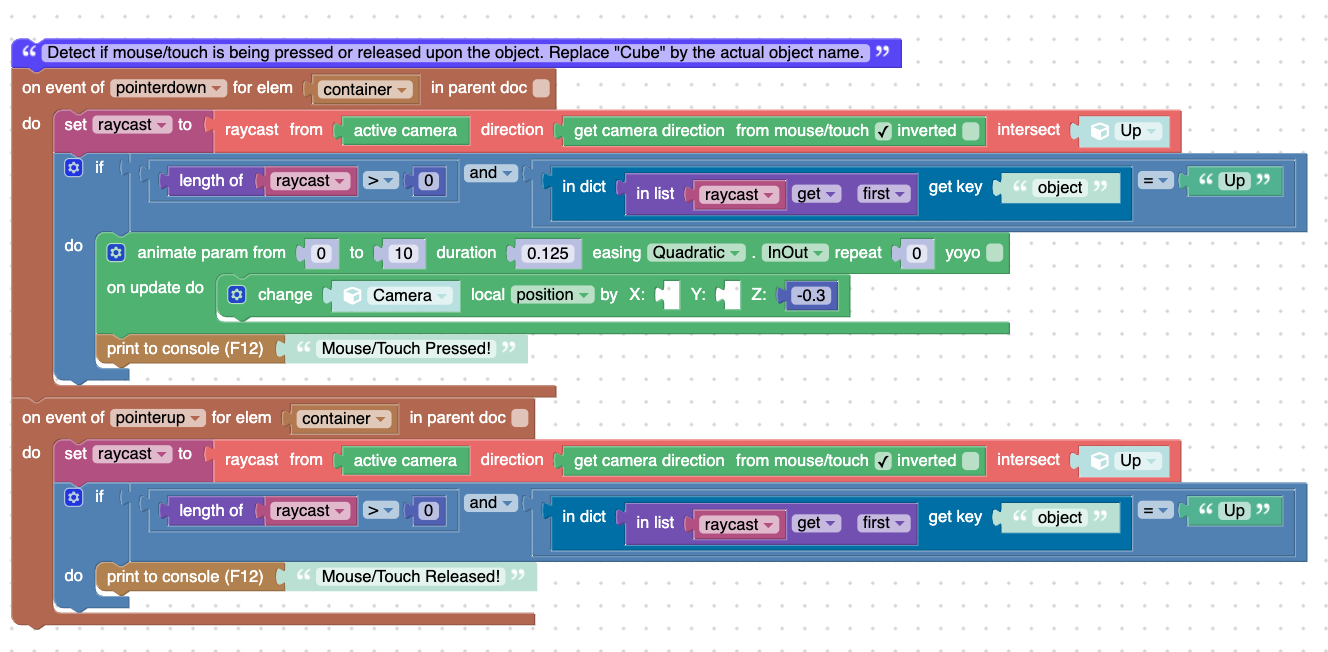

    #49435
    ma77hew
    I’m using the puzzle setup in the comment mentioned above to achieve movement on mobile. This puzzle moves the camera every time the Up or Down button is tapped. However, you need to tap the Up / Down button constantly to move.
    I’d like to configure the Up / Down buttons to move as long as the user has their finger tapped on the screen. When they remove their finger, the button stops. I’ve used the detect touch / tap puzzle library to recreate this control, but even if I hold the mouse down / keep finger tapped on screen, the camera movement stops.
    What am I doing wrong?
    #49462
    ma77hew
    So i’ve been using the “every frame do” puzzle piece to continue the action once the Up buttton is pressed, however this needs to be stopped when the user lifts his finger. What makes the most sense?
