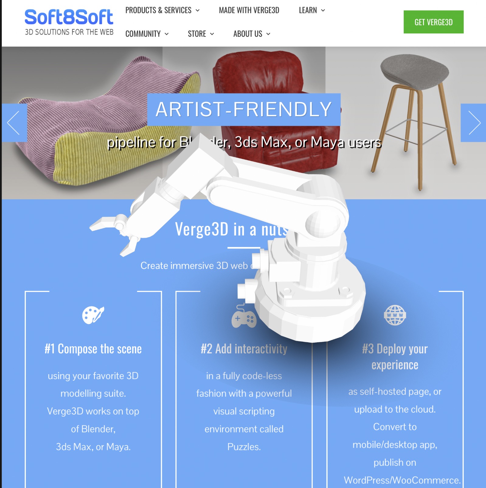

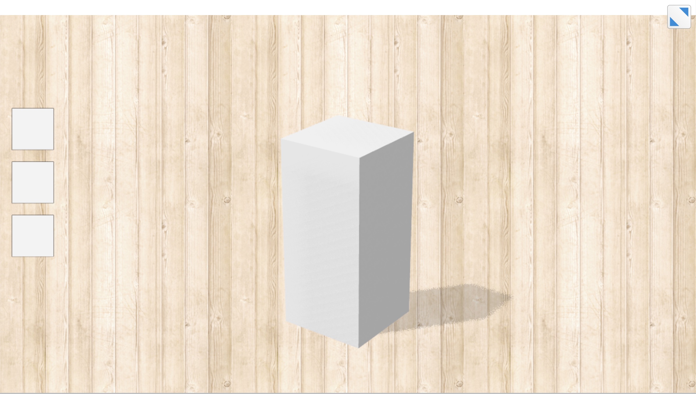

    I hope to make like attached image. it floating over site with shadow. I think it is shadow catcher in blender. Is there way to do this in verge3d? any suggest will be appreciates.

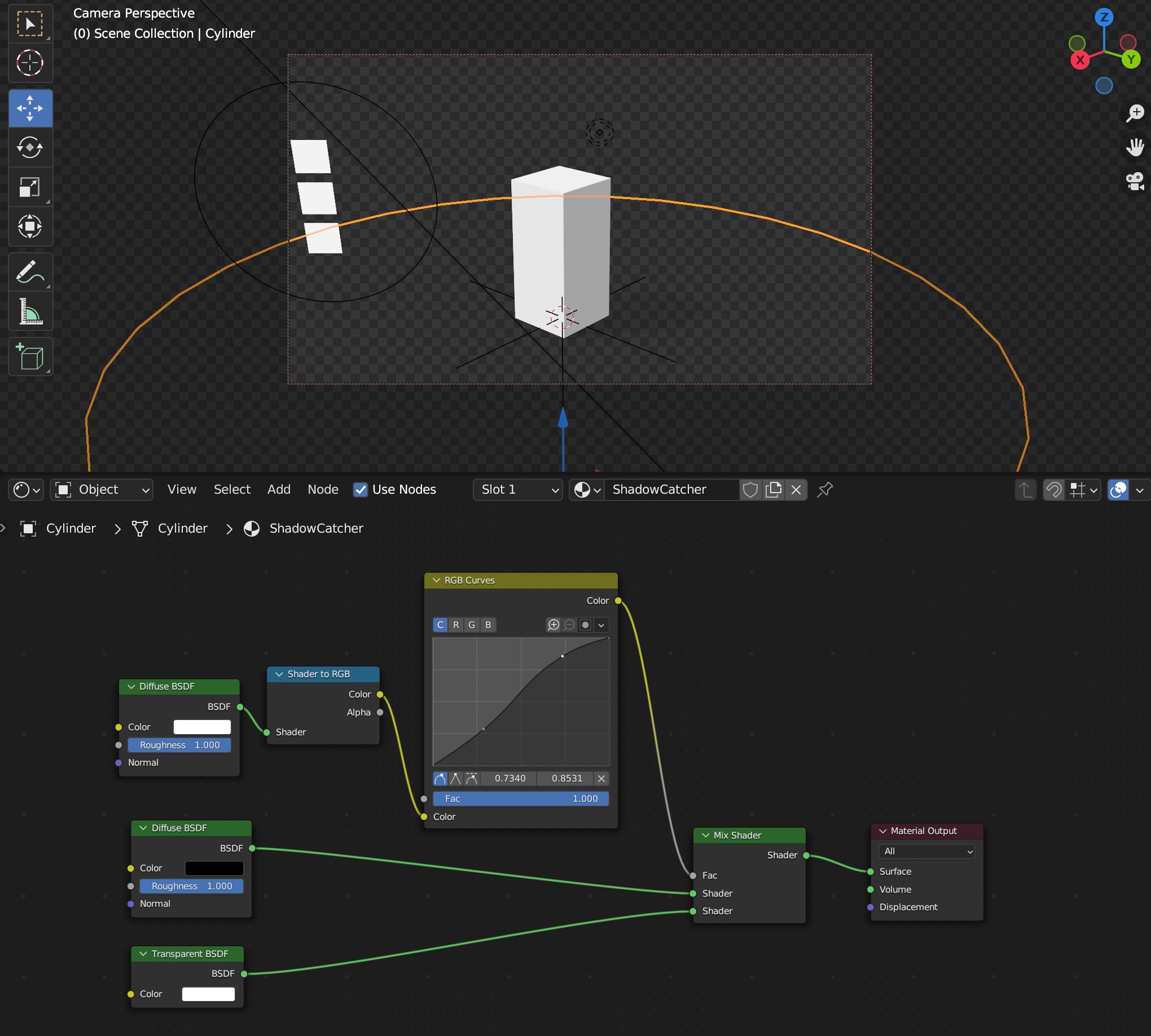

    Anyway, i found some way for eevee too using shader to rgb mode in blender
    and it works somehow. I attached blender setting screenshot.
    not satisfy, but i need dig more.

    The effect you present in your image a2. Could be done with a simple light and plane as a background and you would bypass the entire need for a Shadow Catcher. Lighting may be something you don’t want to use due to performance issues but if your application fits…that might be the better option based on the graphic you provided.
    The sample image you also provided at the start with the robot can easily be created with a plane and an alpha texture under the object. You will notice there are no shadows for the robot arm…just a generic circle under it. You could do the same thing for your object as well.
