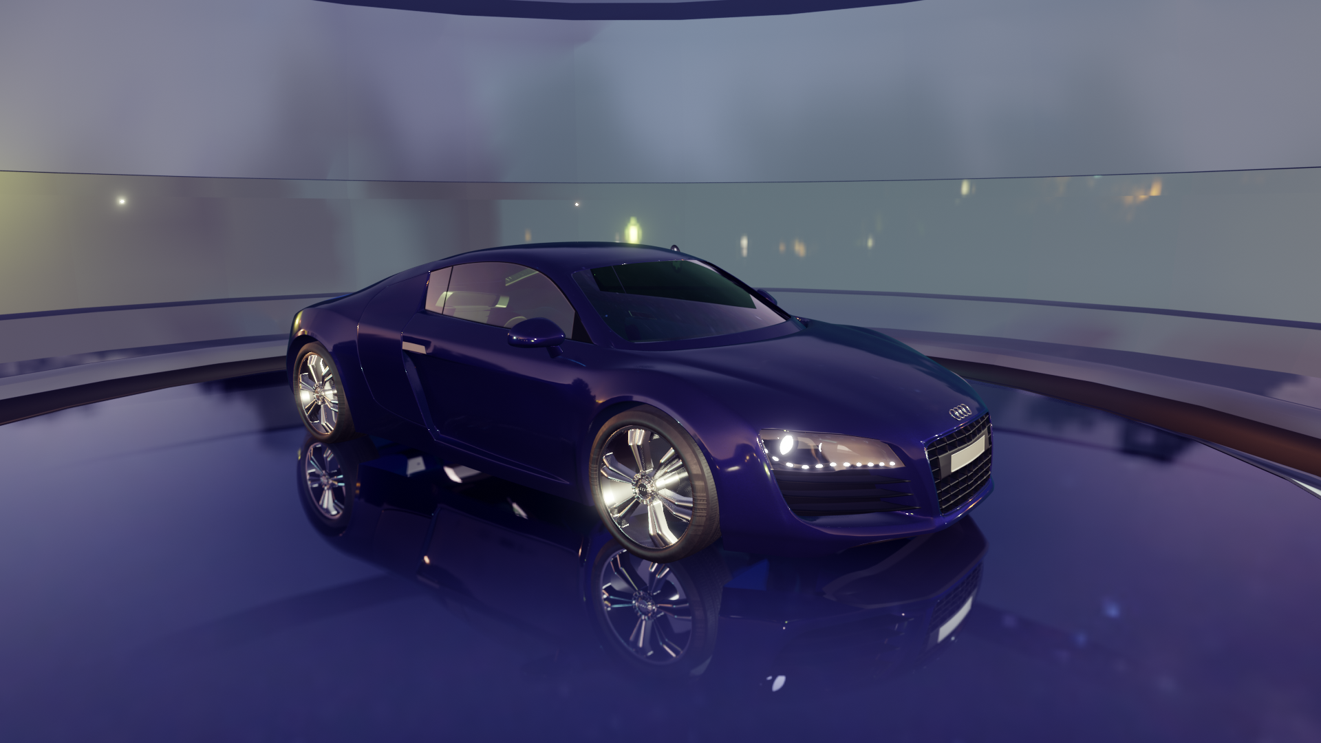

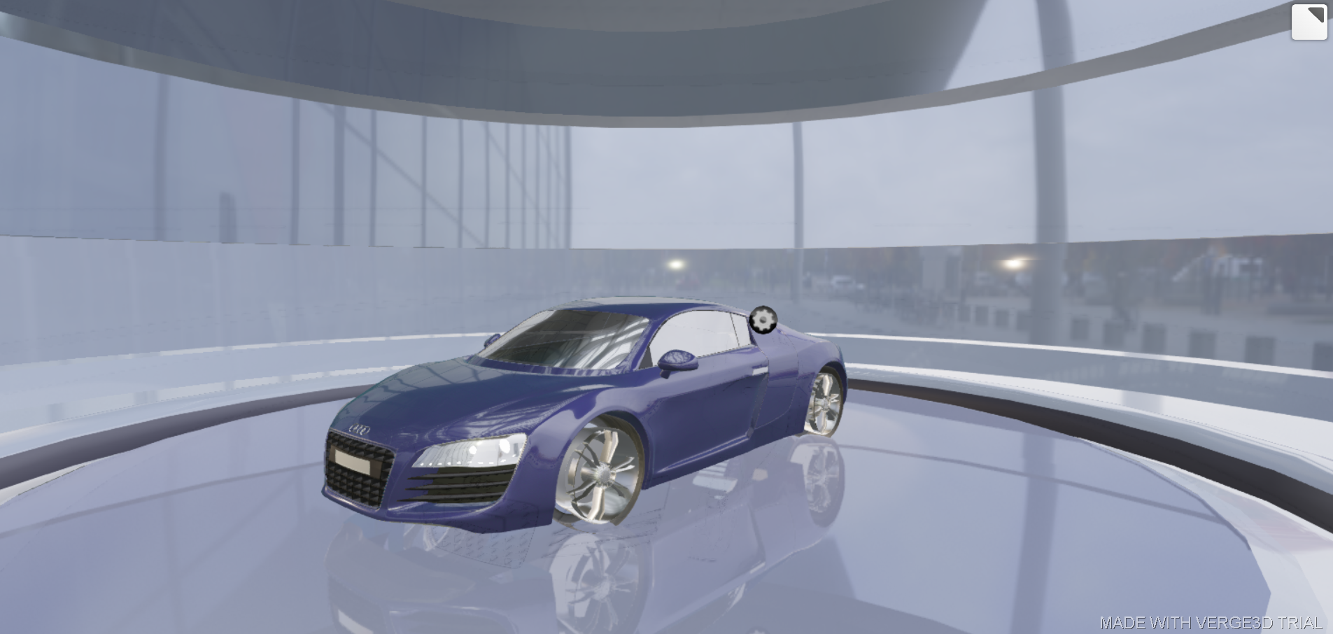

    I am need of some help regarding graphics, turns out my scene in Eevee has a lot of quality lighting and compositioning, but the Verge3D renderer makes everything look so flat. How can I remedy this?
    I attatched two different snapshots, one inside blender and the other in verge3d (ignore missing faces).

    There’s two not supported things on first look^
    1. exr image, that converts to PNG on export so you’ll get the different result, use hdr.
    2. Look parameter from Color Managment also must be set to none, all other not supported.
