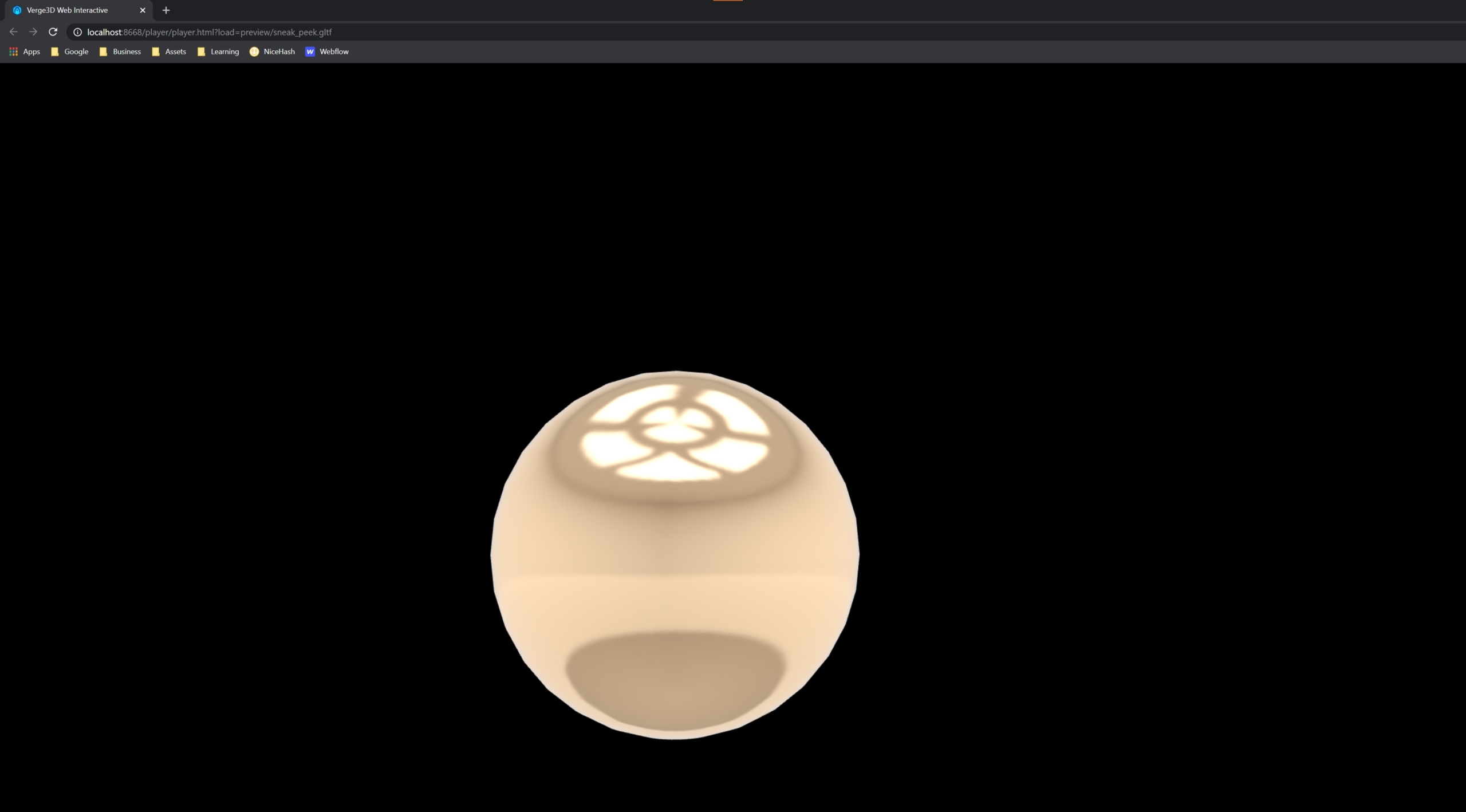

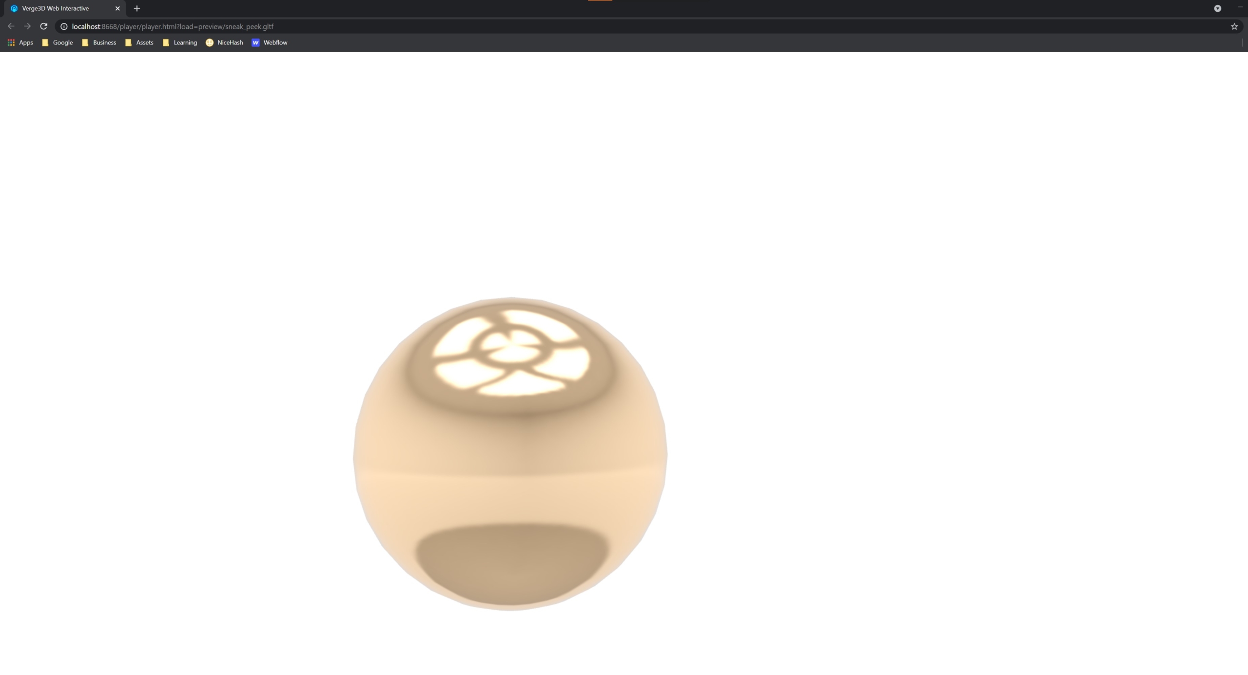

    I was told Falloff map node is in fact supported to create materials with Fresnel/viewing angle effect, but I cannot get it to work, I’ve tried every setting available to me but I cannot produce anything in sneak peak or exported except pure black/pure white/or a simple grey shaded material.
    I’ve attached the 3ds max file below with the HDRI along with screenshots, can someone help me I’ve been pulling my hair out over this issue for over 3 weeks now.
