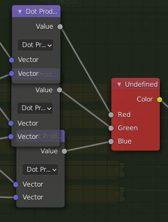

Customerwe have a very specific issue with a node setup that no longer exports in verge 4.2.0 and blender 3.4.1:
the file did export in earlier version, but not in the current version. we narrowed it down to the nodes used by the decalmachine shader.
i couldnt find the specific node causing the issue, but it seems to be somewhere in the parallex effect. attached file only contains the material causing the error:
TypeError: Cannot read properties of undefined (reading 'name') at v3d.js:1:925848 at _u.updateNodeGraph (v3d.js:1:925999) at new _u (v3d.js:1:937542) at v3d.js:1:1278946 at async Promise.all (:8668/player/index 0) at async Promise.all (:8668/player/index 0) at async Promise.all (:8668/player/index 0) at async Promise.all (:8668/player/index 0) at async Promise.all (:8668/player/index 0) (anonymous) @ v3d.js:1 player.js:57 Can't load the scene /sneak_peek/sneak_peek.gltftested in chrome 110.0.5481.178 on windows 10

2023-03-09 at 9:00 pm #60966kdv
ParticipantFix nodes replaced by Blender 3.4.1 before exporting
2023-03-10 at 10:05 am #60980thomasup
Customertrue, that will fix the exports. but it is hard to fix all the nodes by hand.
we will roll back the versions, and sticking to blender 3.3 as of now, and await the next verge release!
2023-03-10 at 10:41 am #60982kdv
ParticipantIt was the right decision )))
