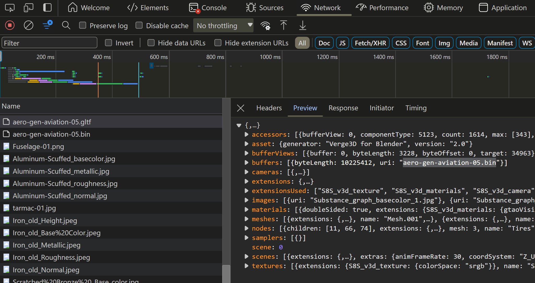

jefferywrightParticipantAnyone can crack open the javascript file and locate our models used in the scene to freely download our assets. In browser DevTools our model files are visible.
Is there a way to protect our properties from being looted from our Verge3D websites?
Thanks.

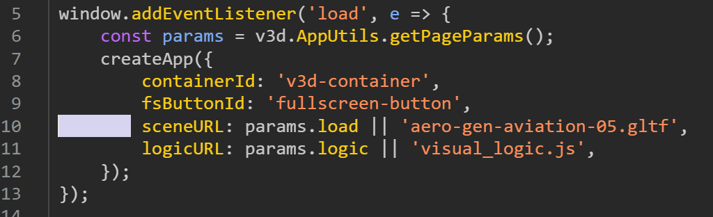

jefferywrightParticipantFrom what I can tell, it looks like the geometry protection is contained here https://apps.kaonadn.net/4559009/core/product.js
Does it look like they are storing the reference to the geometry as a variable and loading it by constructing a path by assembling a string?
