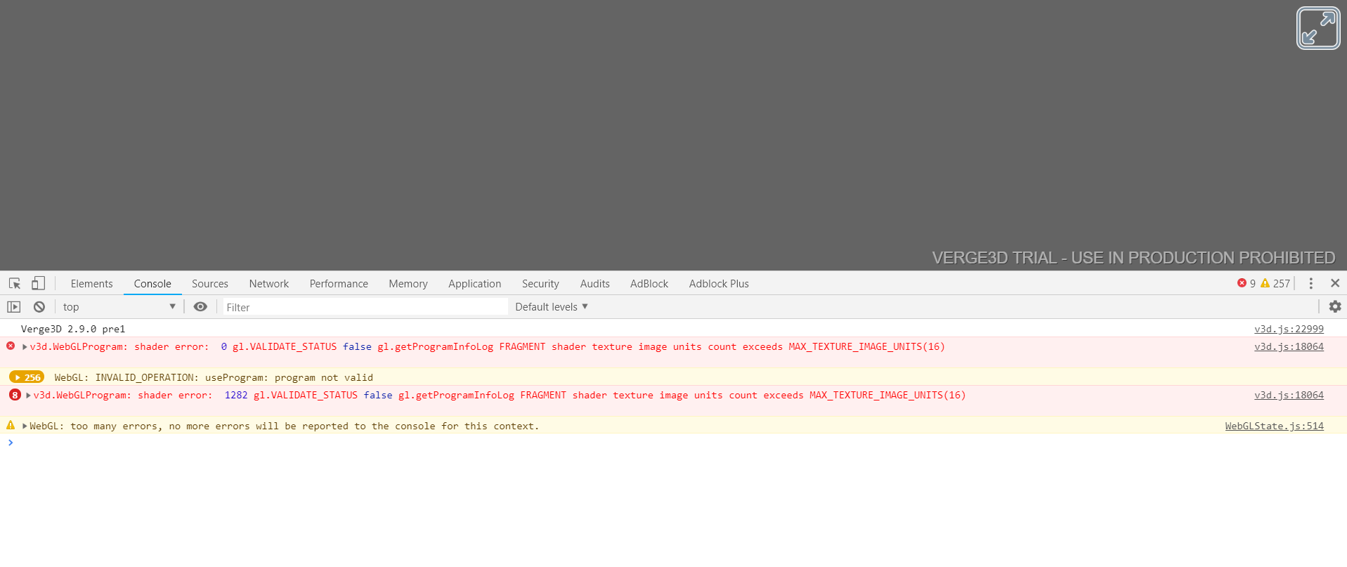

We tried exporting your file and indeed, it crashes on one of our computers. If you open the browser console (which is always a good idea when something goes wrong), do you see MAX_TEXTURE errors as in the attached screenshot?
Looking in your file, I see many light sources, too many for use in a WebGL scene. Each of them requires using a texture unit under the hood, so your scene exceeds the hardware limit. I’d recommend keeping the number of lights below 8 at least (ideally 2-3) otherwise your scene won’t work on low-end computers and iOS devices.
