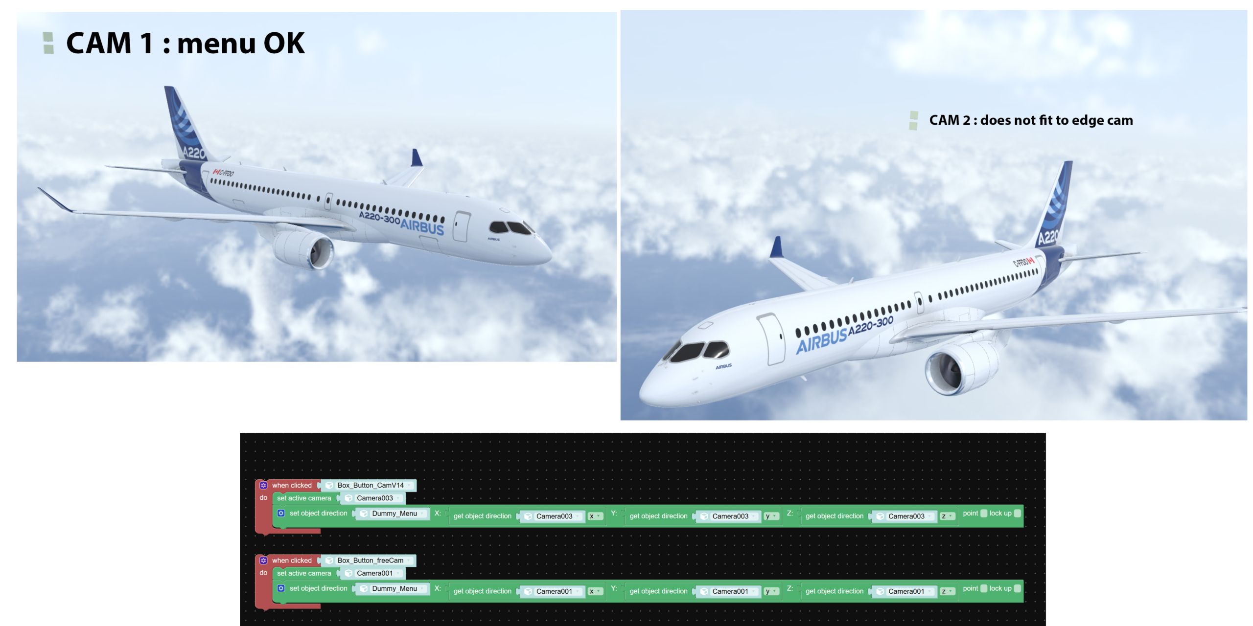

    Two cameras in my scene, when a switch to the second one, the dummy with menu don’t fit to camera edge. how can i fix this please ?

    The second dummy should work when switching between the two cameras. Perhaps you have not cleared parent inverse for that object :unsure: – check out the browser console, perhaps some errors printed there.
