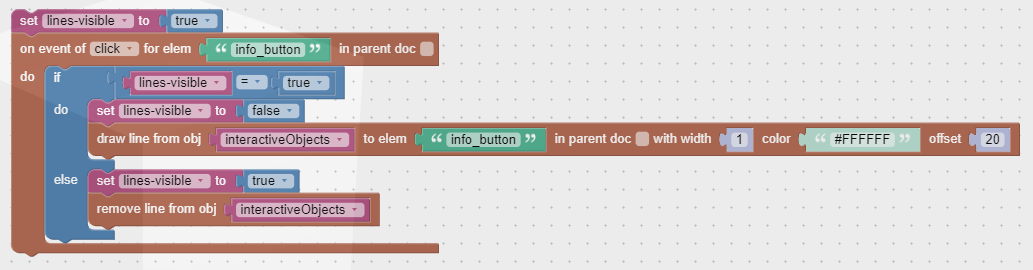

    In my setting I’ve created button for showing all interactive objects.
    On click, it draws lines to objects but not remove them, when clicked once again.
    This my puzzle set for that. It looks like I miss something :)
    #21643
    Hi abin,
    I think you need to change the variable “lines-visible” in the if-do-else puzzle when both drawing and removing lines, for example like this:
    #21649
    Anonymous
    Inactive
    yes. it works but only one time and with doubleclick on button. I have big delay between clicks. Don’t know howto understand is.

    I made a simple example with that puzzle setup and a button that should switch lines on/off on click. Here it is: draw_lines.zip
    #21654
    Anonymous
    Inactive
    Thank you, Ivan,
    I reproduce that but I have the same issue. So I think, it must be elsewhere some problem. I will generate the project again and debug each file later. Thanks a lot. I let you know what I’ll find.
    #21681
    Anonymous
    Inactive
    Dear Ivan, I couldn’t find the problem, so I generated a new project and program everything new very carefully. It was definitely a wrong puzzle setting in some other part of the project, thank you again. This way I could even spare the Bytes. :)
