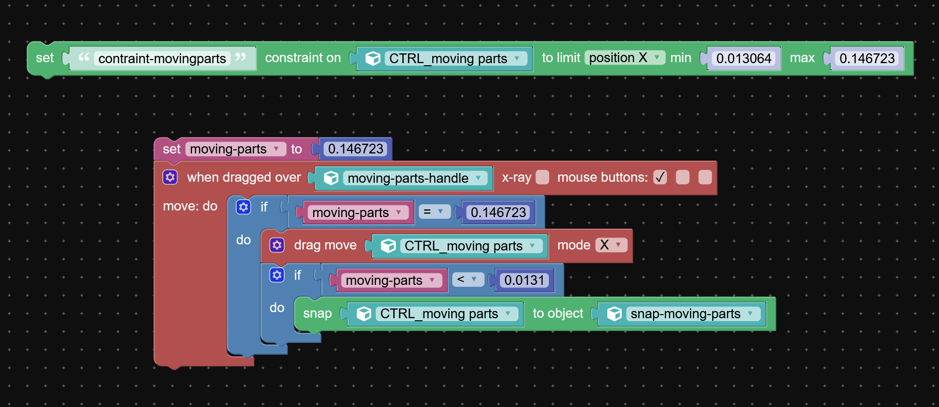

    I have difficulty with snapping object. I have attached my puzzle image. When I drag my object I want it to snap to the other point. It is based on constraints. In my case I can drag because but it does not snap to the other value?
    #71561
    Your variable moving-parts is not changed while dragging and is never less than 0.0131. The condition is not met.

    My approach is wrong. I want my object to continue to slide on x-axis until is requested value. Right now if condition is met it just snaps to the value. So the variable needs to be continuously updated. Does the ‘get vector’ puzzle work in this case. How do I apply it in my scenario?
    #71596
    hamza3d
    I solved it by using a get position puzzle of the object (store it in variable) in combination of every frame puzzle. :yahoo:
    #71600
    You could just place that get position puzzle right after the drag move puzzle, before the condition.
