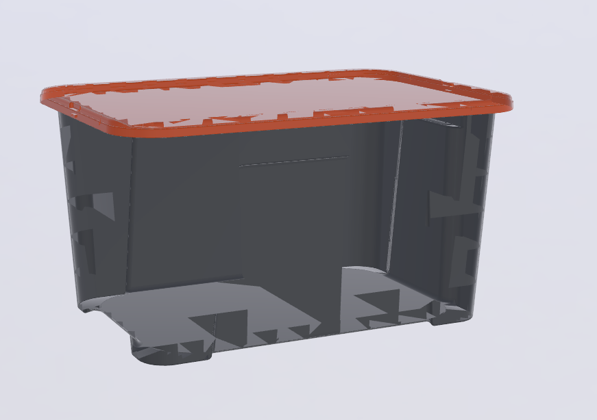

    Can one expert tell me what is going on here ?
    (see picture)
    The object comes from Cad program, and have been polygon-exported (using Moi3D, great 3D software btw).
    Within 3dsmax it is nice (see attached).
    My only thought is that as it is cad file, the thickness is modelled (1-2 mm), so maybe the gltf graphic engine has some issues with very thin models ?
    Any help would be nice, as it could come to a quite nice project for me.
    Regards.
    PS : max file (please keep it secret) : https://we.tl/t-EJbogRxBcB
    #43547
    NaxosCG
    I’ve tried to scale up the object to x10, same display issue…
    #43550
    NaxosCG
    Ok, i think i got it : “Depth test” in the shader…
