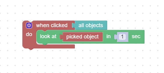

    Hi. You can put inside Click on Puzzle Tween Camera puzzle and connect Picked Puzzle with Look At point slot.

    This will look at any objct you click, instead of All objects you can set only some o them using List.

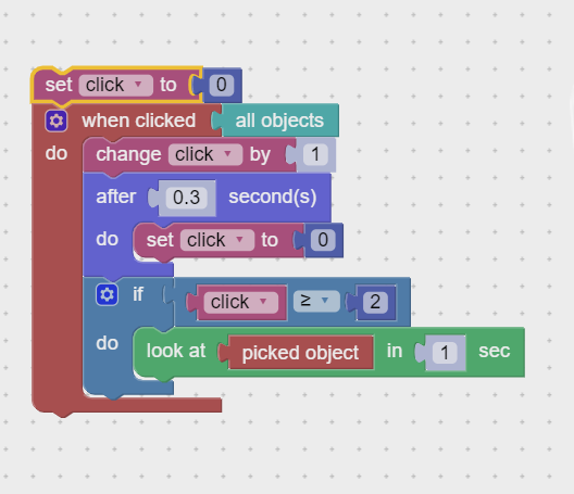

    kiisaku
    but i want double click instead of click, because when i want to orbit aroud i have to click first but that click change my current camera target and i cant orbit around
    #17235
    ok< then this version. Seconds will determine how faster you need to click, then lass than faster need to click.
