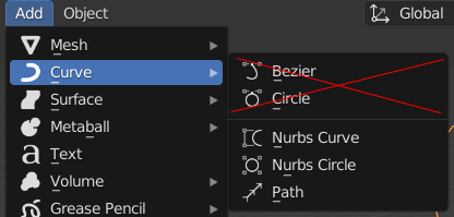

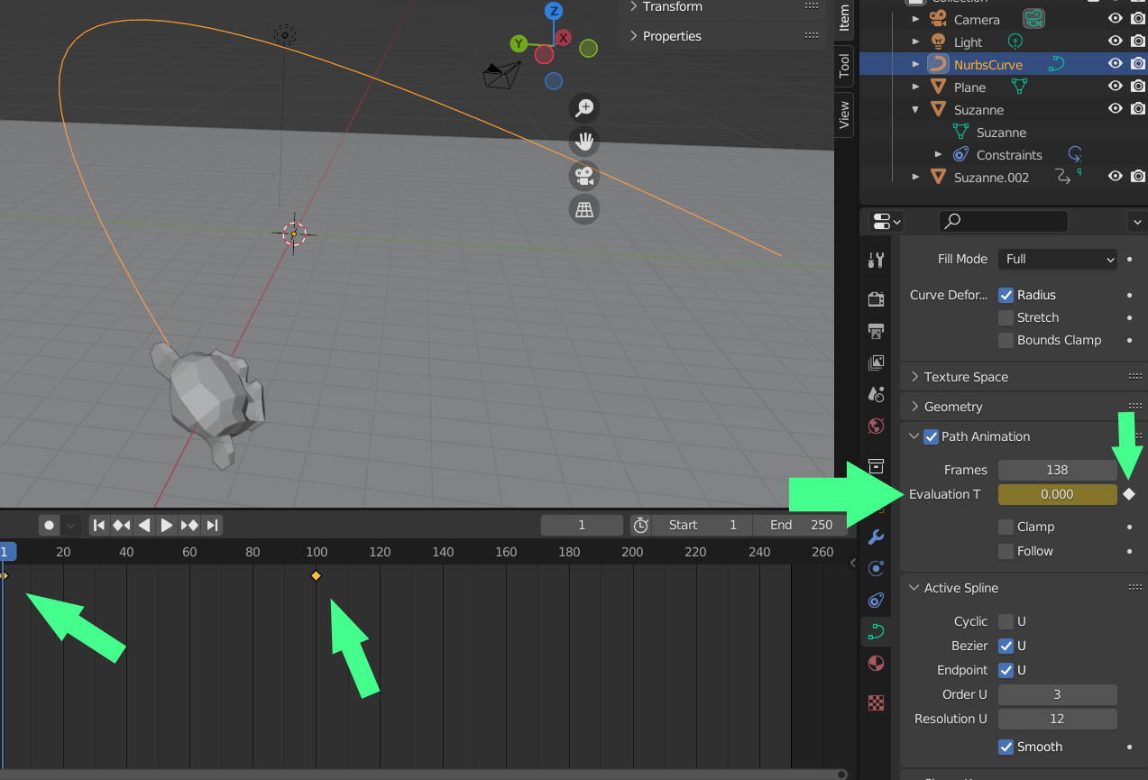

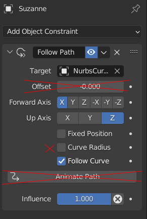

    1. Please make sure you have set animation keyframes directly on curve’s Evaluation Time parameter, Animate Path button in constraint settings is not supported.
    2. In constraint settings Offset value does not supported, but Offset Factor should work.
    3. Bezier curves are not supported, but will be in next pre-release.

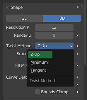

    4. You have to use only “Z-Up” Twist method in curve settings
