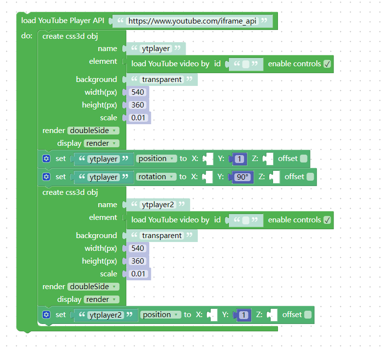

2021-12-24 at 2:56 pm #48283mc78
ParticipantHi Zjb,
It’s possible to have more than one Css3dObj Youtube videos in different places of the scene? If yes, how?
Attached my loser approach :D
Could you give me a little help.Attachments:
2021-12-25 at 11:24 am #48292
zjbcoolCustomerHi mc78,
You should move your puzzles into the ‘load YouTube Player API’ puzzle. See the attachment.Attachments:
2021-12-25 at 5:01 pm #48299mc78
ParticipantYes,
studing just a little I find this configuration, that works!
But on my tablet the video freeze, I have to touch the screen to solve; meanwhile the audio is stable. Is there a trick to lighten streaming?
Another question, I tried to put all the “load youTube Player API” in “when click” puzzle, so that the videos don’t load all at once, but it doesn’t work, the video don’t load. Any suggestion?
ThankAttachments:
2021-12-26 at 2:35 am #48301
zjbcoolCustomerBut on my tablet the video freeze, I have to touch the screen to solve; meanwhile the audio is stable. Is there a trick to lighten streaming?
Maybe I should add more settings for player to control size, playback rate … I’ll update this plugin later,if you need.
You can use ‘set visible’ puzzle to do that.

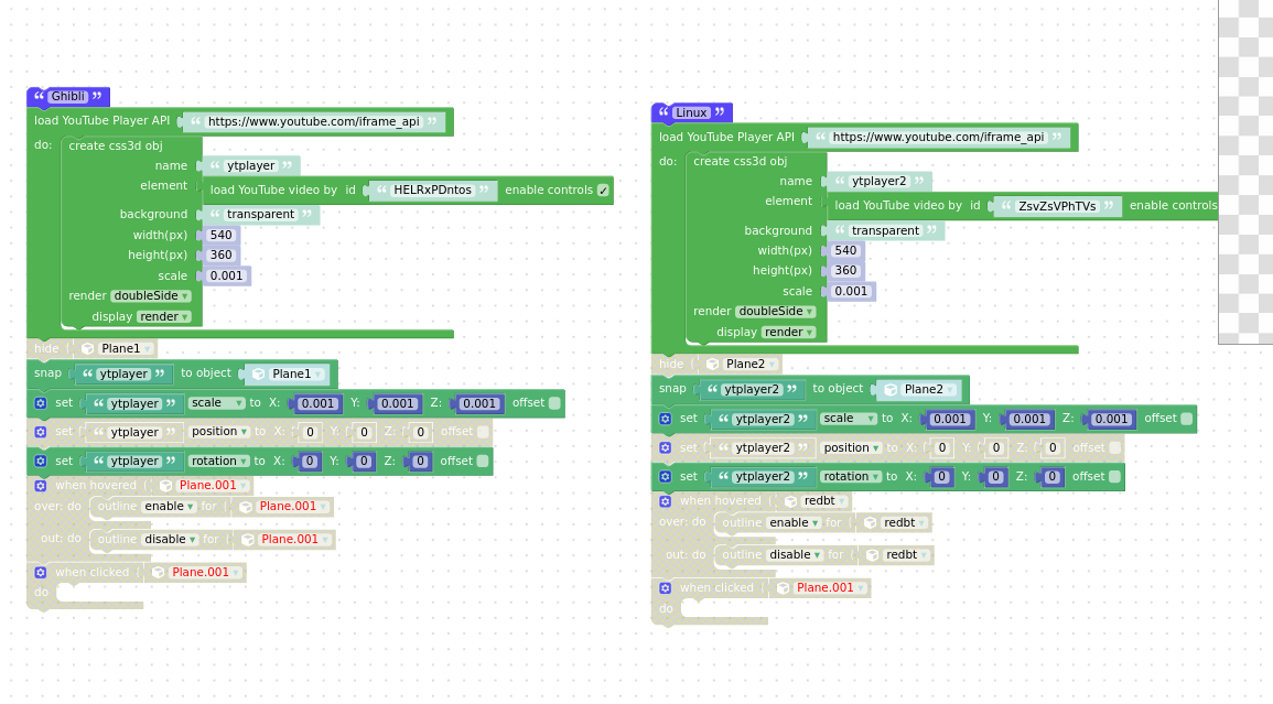

2021-12-26 at 4:58 pm #48311mc78
ParticipantI’m not the master of programmers so maybe I can get this functions yet (and just I don’know) and I don’t know how is complicate add them if not present yet… but the apotheosis of this plugin in my opinion would be at least:
1) possibility to have many many (youtube) videos in a scene that remain light,
2) so possibility to control when loading and unloading videos
3) and maybe, yes, control resolution and playback rate.
4) possibility to drag the time line like in Youtube
Maybe it’s out of your support but I wonder if in your opinion it is possible to lighten the code by always calling the same puzzle block without copying it for each video.
Thank you :)2021-12-27 at 3:38 pm #48324

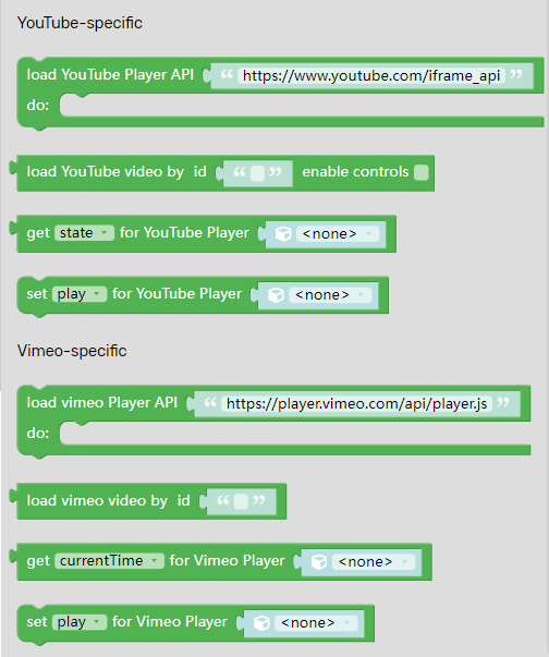

2022-01-08 at 4:47 am #48531
zjbcoolCustomerHi, @troskhy
Yes, you can use YouTube and Vimeo videos with CSS3D plugin.Attachments:

2022-01-08 at 5:12 am #48534

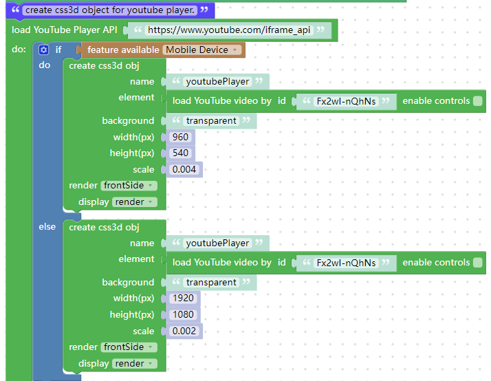

zjbcoolCustomer1) possibility to have many many (youtube) videos in a scene that remain light,
4) possibility to drag the time line like in Youtube1) it’ll be only one video remain light at the same time
2) using ‘element’ param to load/unload video
3) using ‘width’ and ‘height’ params to control resolution, so you can use different resolution for devises. see the attachment
4) using ‘enable controls’ to display palyback controlsAttachments:

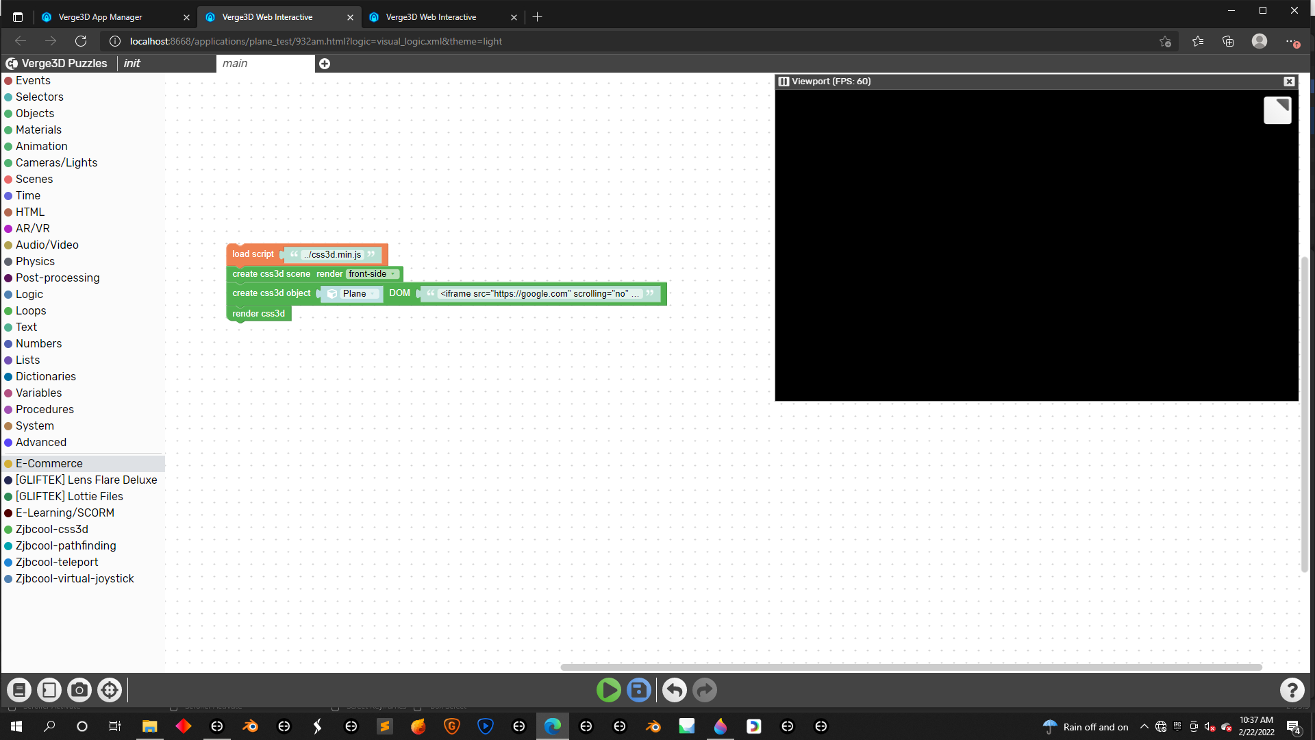

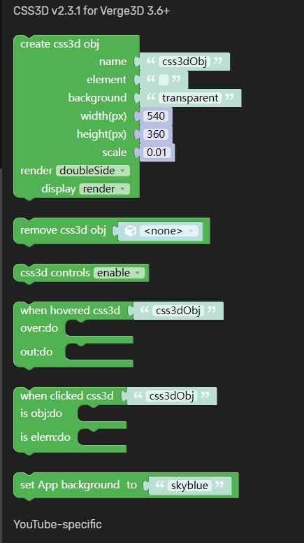

2022-02-22 at 3:34 pm #49504
JohnsonCustomer@zjbcool I’m having issues getting a website to appear on a plane, can you please tell me what I’m doing wrong?
2022-02-24 at 2:54 am #49566
zjbcoolCustomerHi, @Johnson it seems you are using a previous version, please download the latest version(2.3.1), and follow the example along with the plugin.
