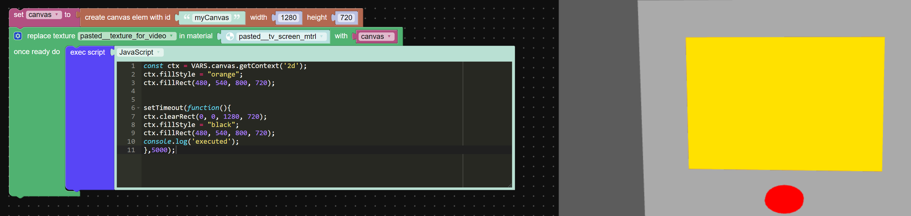

2022-11-03 at 2:35 pm #57054noname
ParticipantWow this is awsome. I tried your code and it works. However after testing a little I was not able to manipulate the canvas after the initial setup.
Lets say i want to clear the canvas and draw another Rect on it. Is that possible? My goal is to build like a little gameboy that runs with a html/javascript canvas and that you can also control with the real buttons on the 3d model.

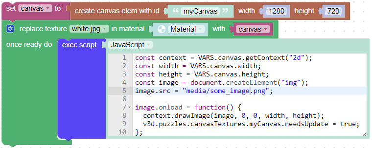

2022-11-03 at 2:56 pm #57060kdv
Participantdraw a new image and update the canvas texture again.

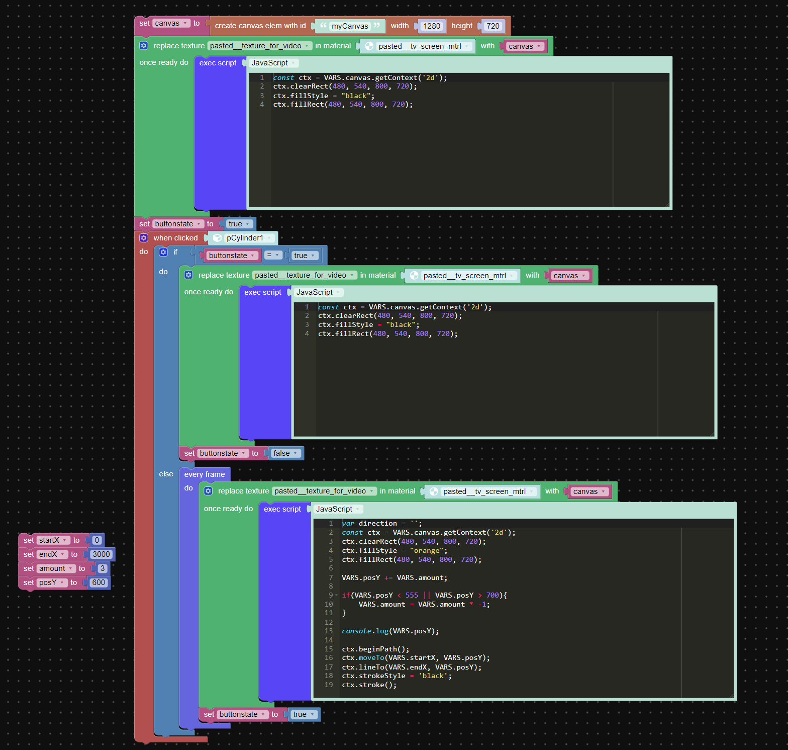

2022-11-10 at 3:23 pm #57265noname
ParticipantSorry for having to ask again here @kdv77kdv
I was playing around with it but im not able to draw animations to the textures. Replacing the texture with a new static image is okay but how do I create an animation on it, using setInterval?
2022-11-10 at 3:54 pm #57267kdv
ParticipantWhat kind of animation you’re trying to draw? A sequence of images or a video file?

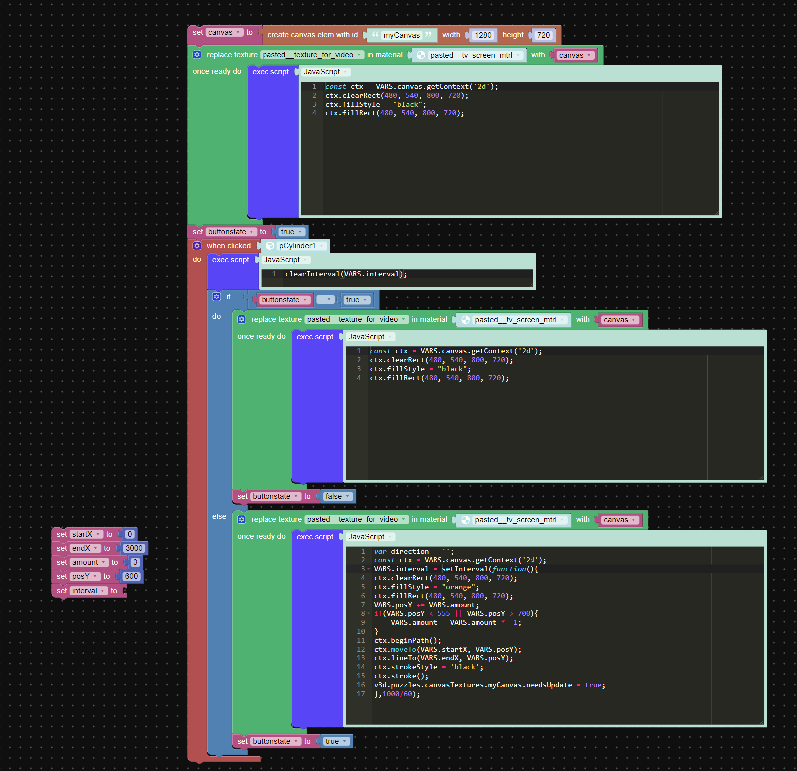

2022-11-16 at 11:21 am #57373noname
Participant@kdv77kdv
It’s more like a javaScript manipulated drawing.Example JsFiddle:
https://jsfiddle.net/7mvq29xa/1/var canvas = document.getElementById("myCanvas"); var c = canvas.getContext("2d"); var startX = 50; var startY = 50; var endX = 100; var endY = 100; var amount = 0; setInterval(function() { amount += 0.05; c.clearRect(0, 0, canvas.width, canvas.height); c.strokeStyle = "black"; c.moveTo(startX, startY); c.lineTo(startX + (endX - startX) * amount, startY + (endY - startY) * amount); c.stroke(); }, 30);2022-11-16 at 12:22 pm #57375kdv
Participantdo you update the canvas texture after every frame?
2022-11-17 at 2:58 pm #57434noname
ParticipantOkay when using the setInterval as Puzzleblock and not in the Code-Block it seems to work doing animations.

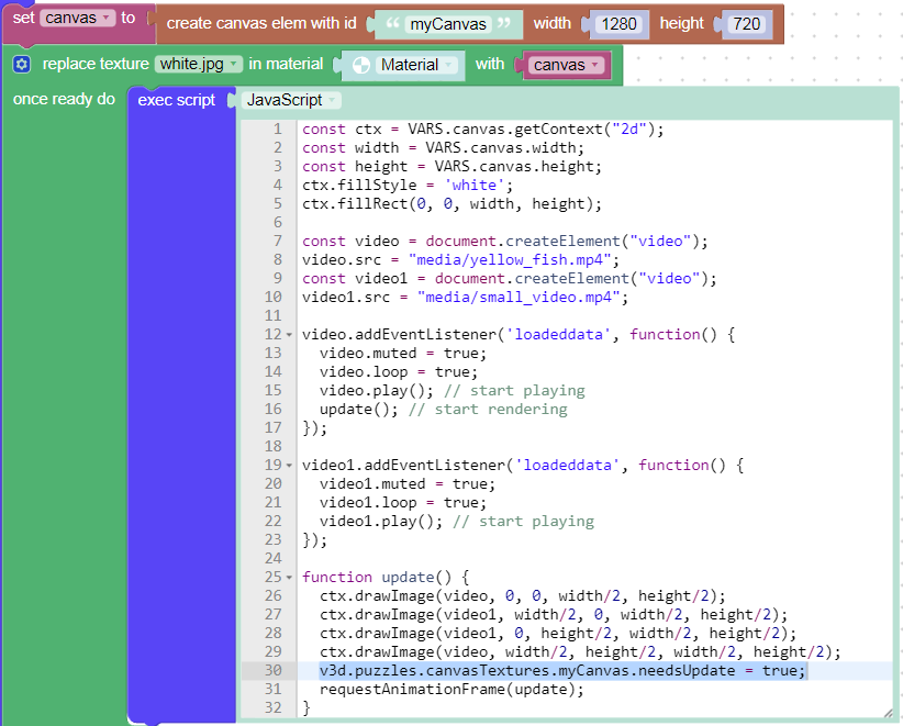

2022-11-17 at 3:07 pm #57436kdv
ParticipantReplace texture every frame??? That’s a cruel solution ))) As I’ve said, you just need to update the canvas texture every frame.
This script draws two videos to the canvas texture
