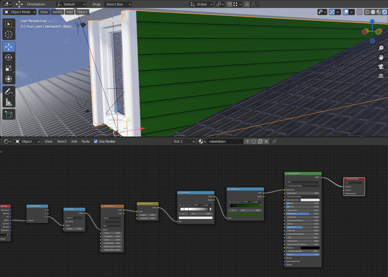

    Hello, hereby find attached a procedural material of “tongue and groove boards” I like to change the colour of it in 3DVerge Puzzles, but the main colour is controlled by the second ColorRamp.
    Is there a simple way to controll this ColorRamp or an other way to set up this material, so I can change the main colour with puzzles?
    Thanks in advance!
    Martin

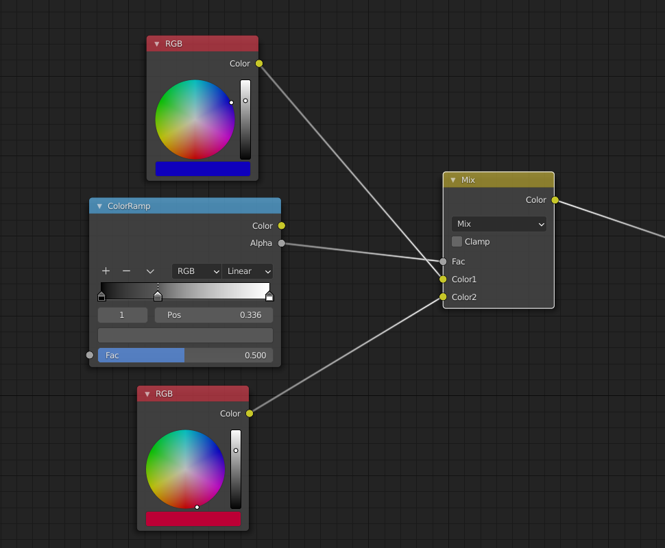

    Sorry but unless Color Ramp has no value or color inputs there’s no way to control it outside blender. The only thing you can do is to prepare few color ramps in one material and switch between them using a mix color node and a value.

    There are to many colour options for this material, so I don’t think this will solve my problem, is there not a way I can use the RGB puzzle for this material by using some other nodes?
    If you need only to color a color ramp you can use this setup.
    #45579
    CPQ Factory
    Thanks Mikhail!
    That will do the trick :good: .
