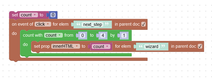

    Hi, I have read the documentation on the Loops Puzzle, I have an issue which is I create a variable, put it in the loop, but the value is always the maximum value of the loop. I tried to say Variable=0 before but the result was still the same. The output is always 4 and Im at a loss why.
    Any help would be greatly appreciated. I want to create a 5 step wizard where the clicking of the button “Next_Step” will add one to the count until I reach 4, then set the variable back to 0.

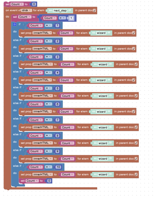

    I have it working, but in a different way. Please let me know if this is correct or if this is a bad way of doing it. Thanks

    First of all,you can use the increment variable puzzle to count up. (Top of variables puzzles menu)
    Then use just 1 if statement of if count = 4 …
    Set count = 0.
    No need for a loop here I don’t think.
    Tell me how it works out for ya.
