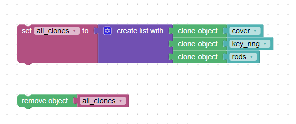

    It’s better to assign a cloned object to a variable and call it by variable name.
    #28548
    Akylbek
    I tried but it doesn’t work (you can show an example for several cloned objects (for example, after cloning there will be a separate command to delete all clones)
    #28552
    Here ypu go.
    #28559
    Akylbek
    interestingly it deletes the last clone and the rest remain in the scene
    #28573
    You have looped an obj variable to itself. It can cause unexpected behavior. Use simple construction that I’ve shown before.
    #28600
    Akylbek
    in your method, it only deletes the last created clone and not all, I found a way to find out the future names of the clones and delete everything at once
    #28603
    Example that I’ve shown you works fine. It may not work because of another reason in your code.
