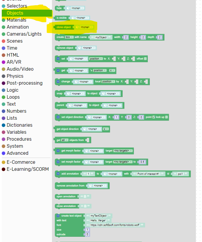

Does anyone worked with *Clone_object* puzzle?
It creates a copy of object and gives unique name for it. But is it possible to know the exact name of the copy, so I could further control it?

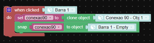

ParticipantI tried setting a variable to the clone and then snapped it to another object, but that made the cloned object scale up like 10x to 20x automatically. What did I miss here?
2024-06-13 at 5:08 pm #74846kdv
ParticipantLook at
Barra 1 - Empty‘s scale. Compare it with the scale of your clone.Snapped objects copy all three transforms: position/rotation/scale. Have no idea why they in S8S decided to copy scale

ParticipantLook at
I see. Well, for future reference, I just set the snapped object’s scale back to 1 after snapping. That’s the best I could figure out to work around this issue.
