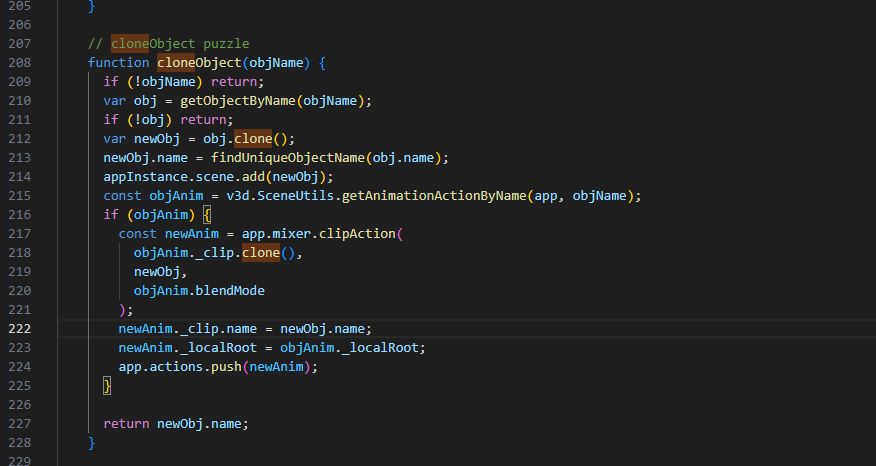

    saurav
    I have added the suggested lines in the visual_logic.js as per the first link that you shared but it is still not working.
    I have attached the screenshot of my function after adding the suggested code lines. Please have a look and point my mistake if any.
    #66698
    This code should be added 2 lines upper, before
    appInstance.scene.add(newObj);
    And this code doesn’t play the cloned clip automatically, just clones.
    Add this piece of code for auto-playing
          if (objAnim._mixer._isActiveAction(objAnim))
            newAnim.play();
    before
    app.actions.push(newAnim);

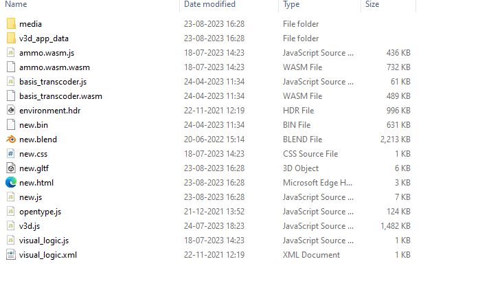

    Whenever I am adding the clone object puzzle and then ‘Save’ & ‘Play’ in the puzzle editor to see if the animation is getting cloned as well or not, my visual_logic.js file gets reset.
    You said to add this in the puzzle_min.js file as well but in my directory it is not visible.
    I have attached the screenshot of my directory as well.
    #66702
    It won’t wotk in the puzzles editor (visual_logic.js is not used when in puzzles). After manual changing in visual_logic.js run the app itself to see how it works.
    puzzles.min.js is located in the Verge3D installation directory.
