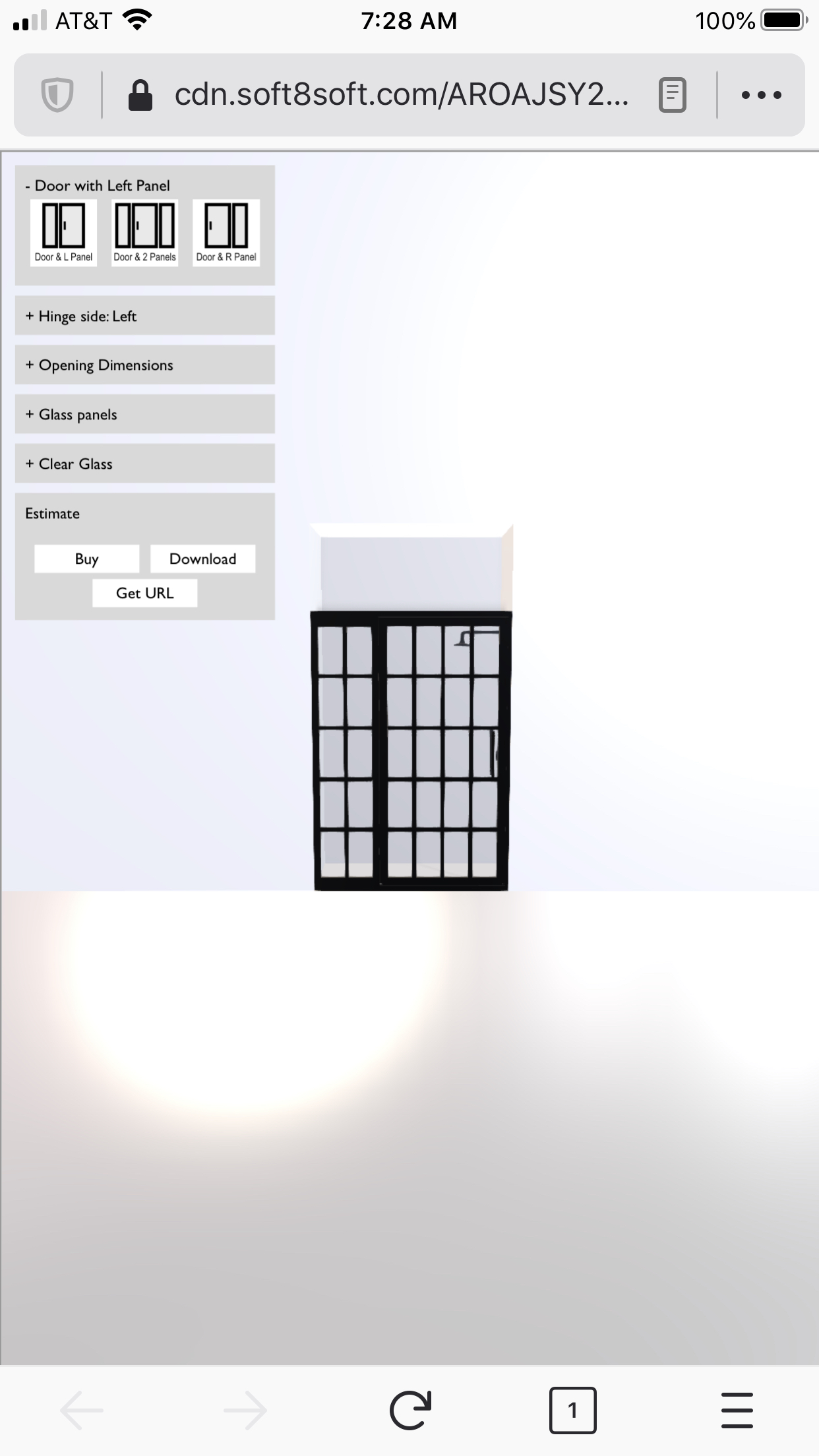

CustomerI’m trying to create an AR version of an app, and I think I’ve copied it over correctly from the ‘Augmented Reality’ sample, but it doesn’t work. I’m trying it on iOS. I have a button that’s supposed to show up if AR mode is available, but it doesn’t show (see attachment). Since everything depends on that button being clicked, nothing happens. Even in XRViewer, I just get a red bar at the top that says “Click here to enable iOS VR mode”

Alexander KovelenovStaffHi,
This module is shown because you activated VR compatibility module for your app. It will try to initialize the required iOS features for cardboard devices. To remove it simply delete webxr-polyfill.js file from you app and remove the following 2 lines from your app’s html file:<script src="webxr-polyfill.js"></script> <script>var polyfill = new WebXRPolyfill();</script>2020-10-05 at 5:04 pm #33842johngrigni

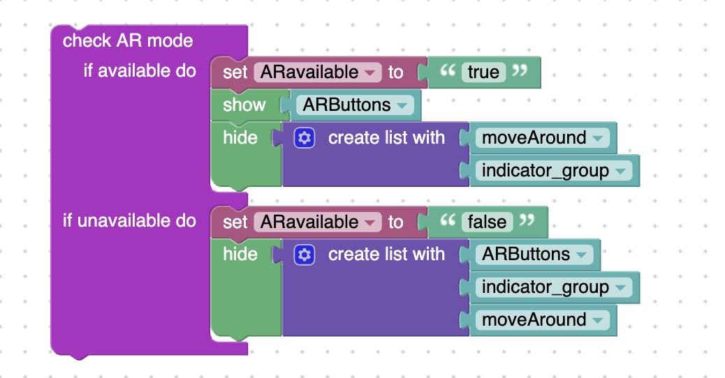

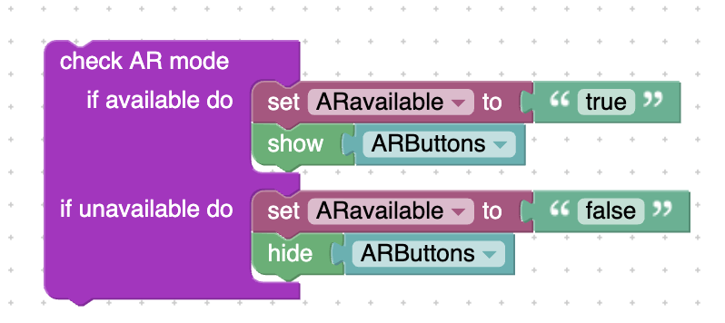

The buttons don’t show up. In fact, I remade the puzzle so they should show up, but get hidden if AR is unavailable. In other words, they are visible in the blender file, and only hidden by the puzzle. The first ‘show ARButtons’ is redundant.
It works with the ‘Augmented Reality’ file with the same app on my phone.
