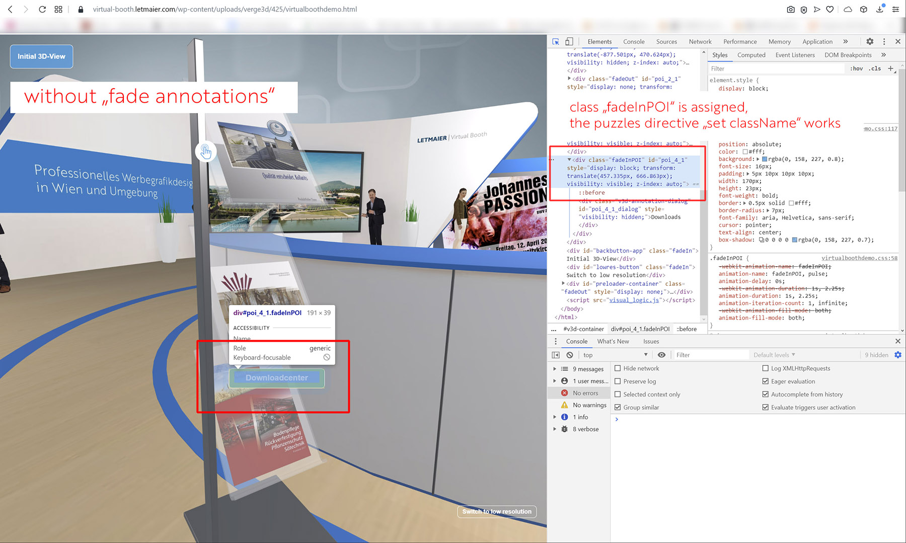

Disable fadeAnnotations:

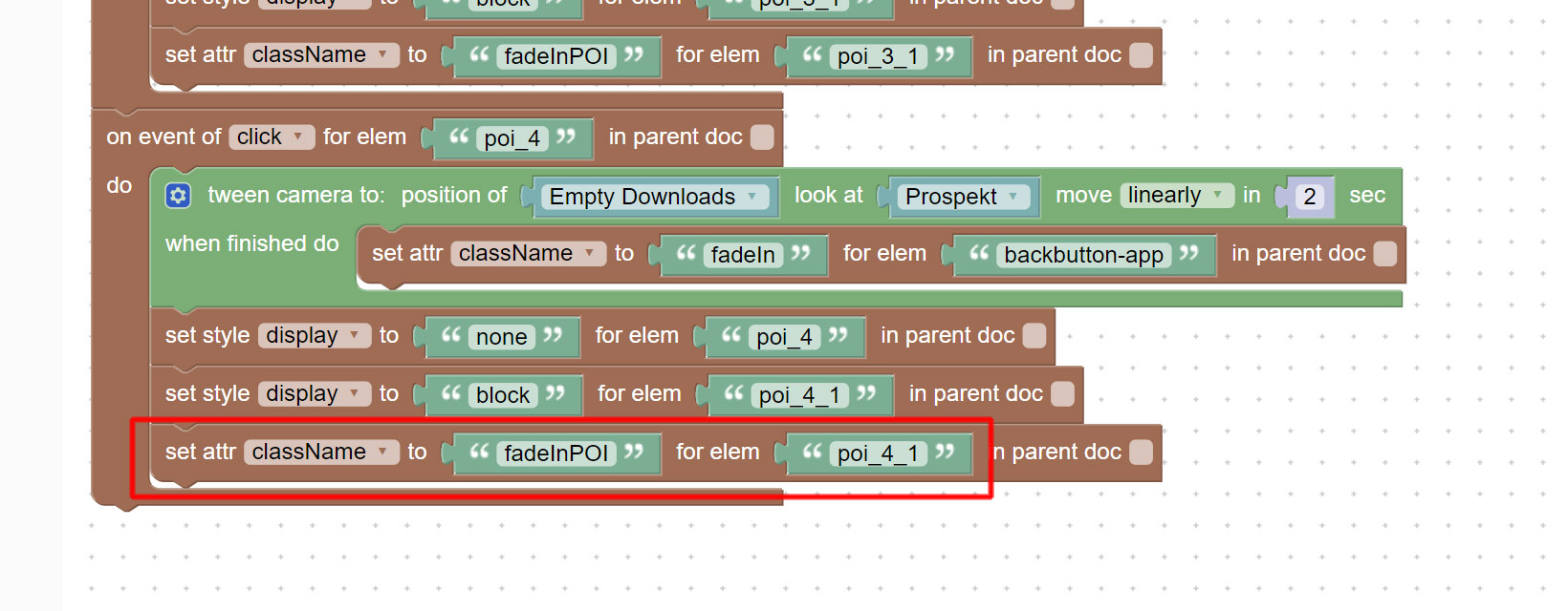

I assigned the annotations within puzzles and added an click event with a fadeIn CSS class to another annotation “poi_4_1”, which fades in smoothly if zoomed in via the “parent” annotation “poi_4”.

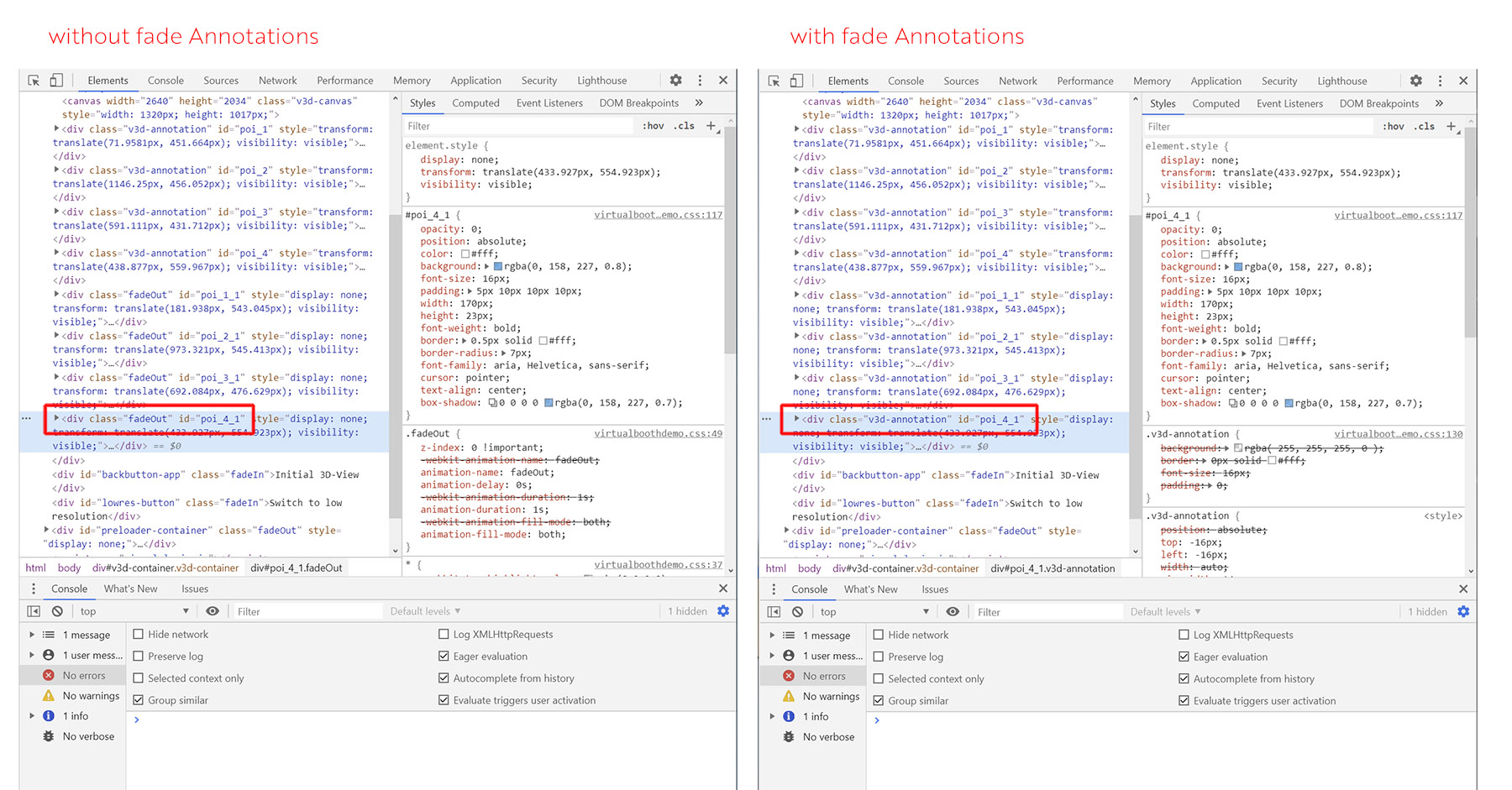

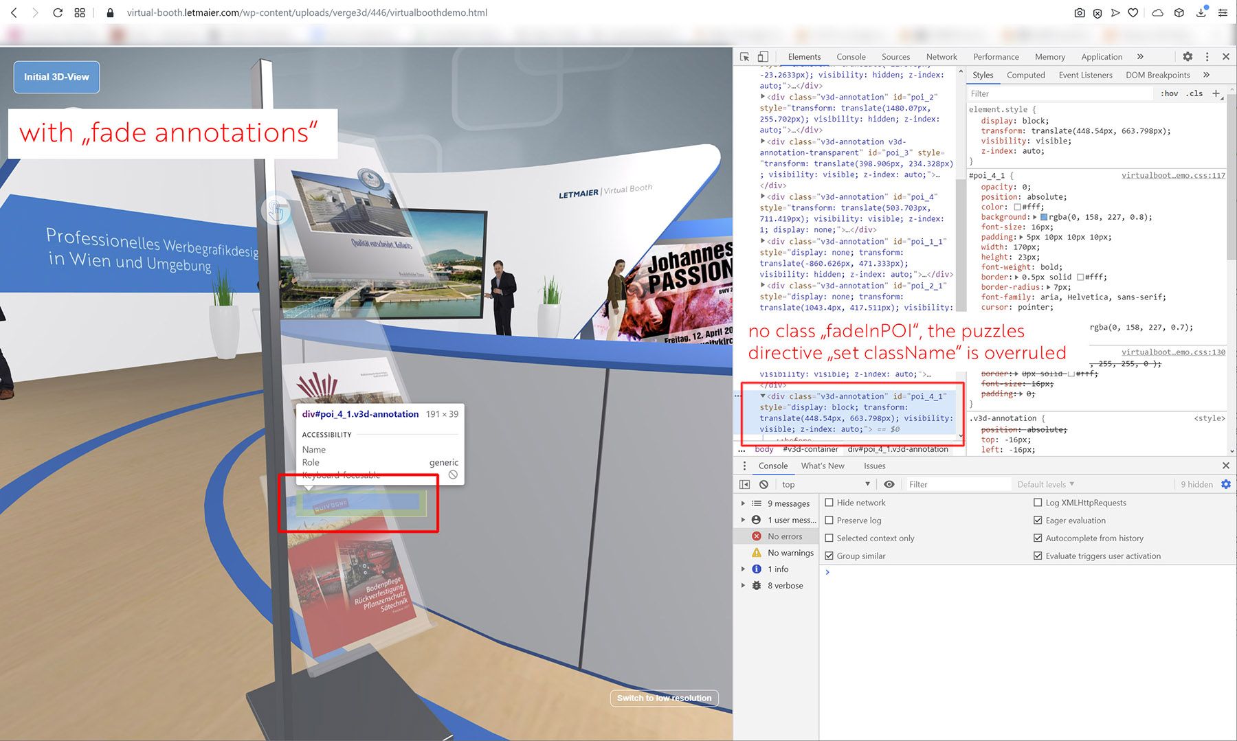

Enable fadeAnnotations:
The puzzles “set attr className” doesn’t longer work, the class for “poi_4_1” is overwritten with the class “v3d-annotation”.
What is the solution for that? I want a smooth annotation fade, but the annotations should be also faded out if behind an object. Then, with the variable “annotation.obscured” as you proposed I could disable the click event.

I think this is not possible. With “fade annotations” active, the class name “v3d-annotation” is inserted at startup into the annotation div AND overwrite my startup class name “fadeOutPOI”. Strange is, that every attempt to change this class name later is not possible. Why?
I guess you are using the Javascript function element.setAttribute() for assigning the class “v3d-annotation” – which delete other class names. You should rather use element.classList.add() (pleeeease provide Puzzles elements “classList add” and “classList remove” for this), so custom classes can coexist with the “v3d-annotation” class.
