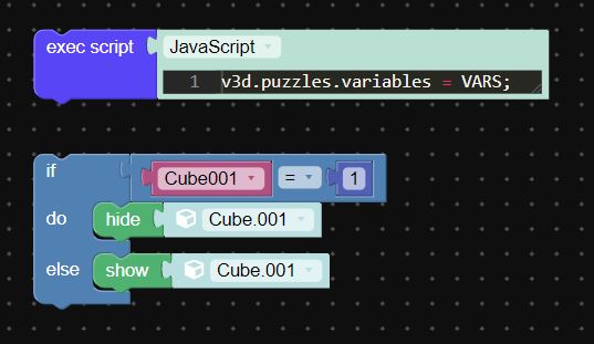

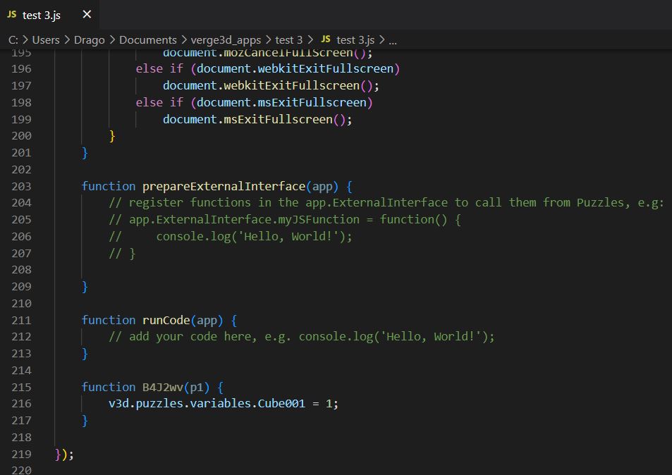

I have done as attached pictures. But still I got error “Uncaught ReferenceError: B4J2wv is not defined in https://cdn.soft8soft.com/… (Line: 1)”
What am I doing wrong?
2022-09-15 at 12:40 am #55859kdv

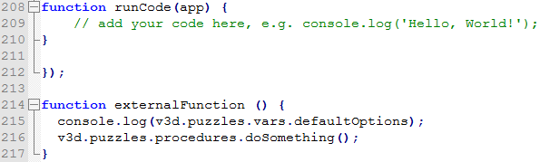

ParticipantYou should use a procedure to change visibility. Your
if elseworks only once on the app loading. Place it inside a procedure and call this procedure. And your function must be declared outside the functionwindow.addListener, below this line});.Like this
