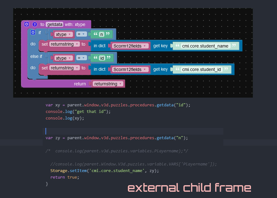

    How could I access a variable set in puzzles from within a separate script loaded in child iframe (same origin, same server)?
    Help! thanks
    #55755
    Do you want just to read this variable?
    #55763
    Crunch
    yes. Just read the value.
    As a workaround until i can find something better, I called a puzzles function that returns the value of the variable I want to work with on the external script – again, external script is located in child frame of my main verge app.
    var xy = parent.window.v3d.puzzles.procedures.getdata(“id”);
    #55768
    It looks like a solution not workaround ))) Using v3d.puzzles as an intermediate link you can read/write any variable… And according to your screenshot you know about it. What else do you want?
    #55769
    Crunch
    how so? say i wanted to just read a variable i have in puzzles, whats the syntax? Assume vname is variable set in puzzles to “hello verge”.
    window.v3d.puzzles.variable (vname);
    window.v3d.puzzle.VARS[‘vname’];
    thx in advance
    #55771
    read
    const dir = v3d.puzzles.variables.direction;
    write
    v3d.puzzles.variables.direction = 150;
