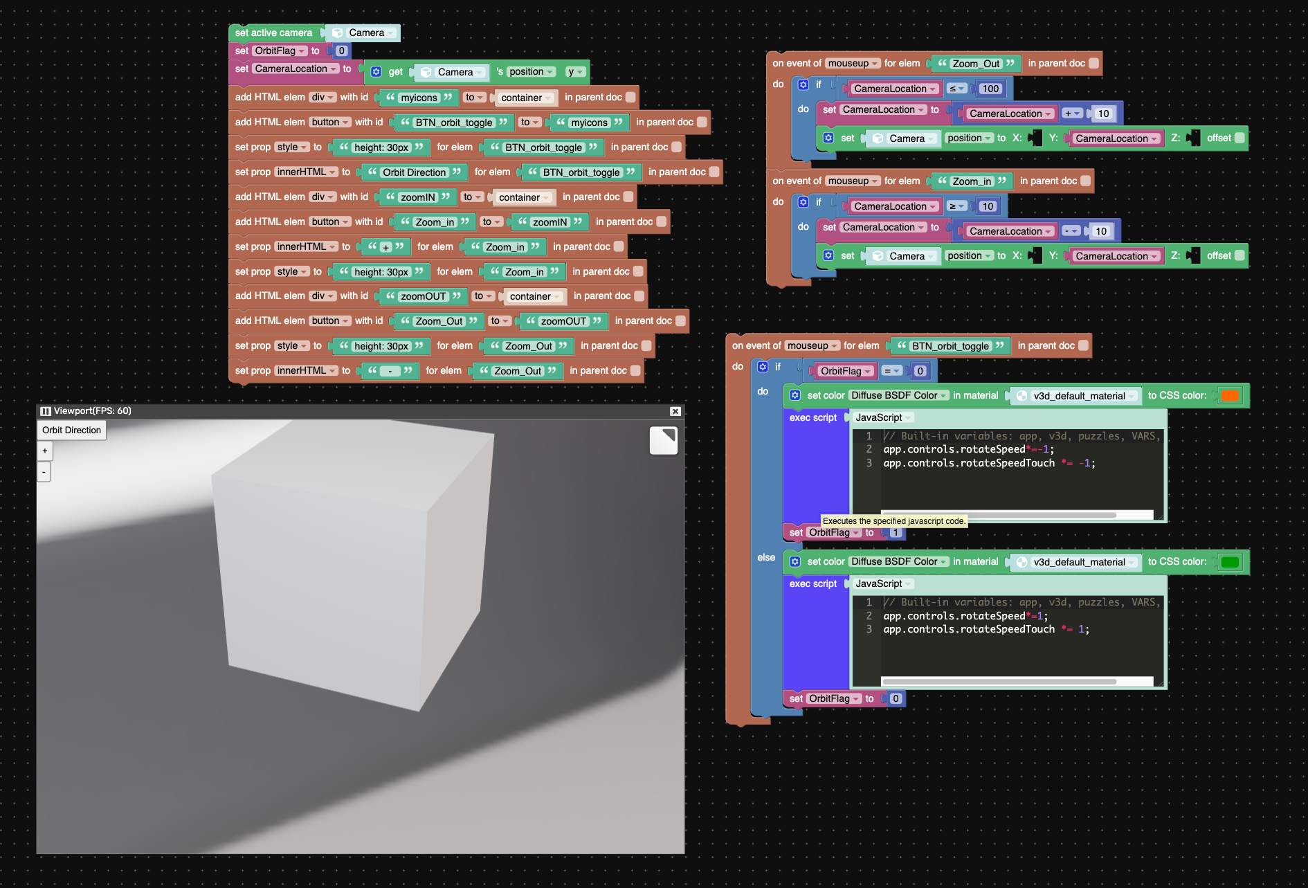

It will depend on your budget obviously and what your client really wants.The following is an extremely simple project that uses Google controls. You can flip the camera rotation direction, zoom in and zoom out based on buttons. Not sure why this would be preferred over pinch zoom or scroll but works nonetheless.
You would probably want to implement a form of deciding where the center point of zoom is..but based on the location of the map they are on.
Puzzles for the entire project are shown in the attached image.
Works on desktop and mobile.
All code in puzzles… not pretty but it should get on on the right track to getting this done yourself.
Since this is for a client…I would suggest taking KDV up on his offer and having him implement the puzzles. You will then end up with a set of puzzles you can reference and you can hopefully make a profit on what he is offering his services for.
