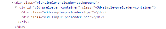

    Here are the elements of the simple preloader:
    preloader elements

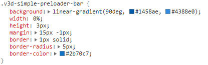

    Here are the default definitions of the bar and logo classes:
    Edit your project’s CSS file and override these classes as you see fit.

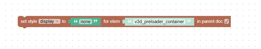

    Thanks a lot @jem. Actually, I want to set preloader display to none but I dont know where I can change it. how can I access these classes . Can you please guide me. I have tried using puzzle, please check the attachment. I tried with or without parent doc but its not working.
    Can you please help.

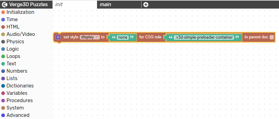

    @arslankhan, if you truly want to hide the preloader, set its display to “none”. You can set up a css puzzle in the init tab. Set the “display” style to “none” for the “.v3d-simple-preloader-container”. Do not check the “in parent doc” option.
    hide preloader puzzle
    If you look at the screenshot of the markup in my first response, you will see that this hides the container that contains the logo and the progress bar.

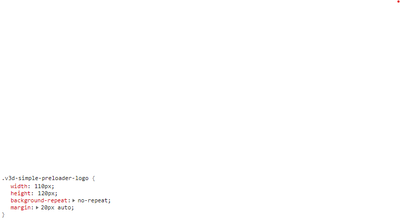

    Thanks @jem, you are a legend. You are right it is not the best way to remove default preloader. Actually, if I use preloader puzzle to remove default preloader, it makes the background black while loading with my custom preloader. I have tested it alot and I think problem is with preloader puzzle, because I tried using it without my custome preloader and it was still making the background during loading period.

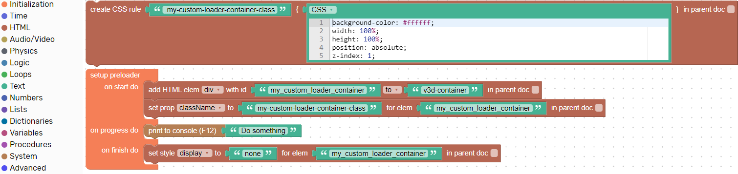

    If your custom preloader page is black, I might be able to guess why that is. The v3d-container is black. You need to draw your custom preloader in front of it and ensure that your custom preloader fully covers the v3d-container.
    Here is a simple setup that does just that:
