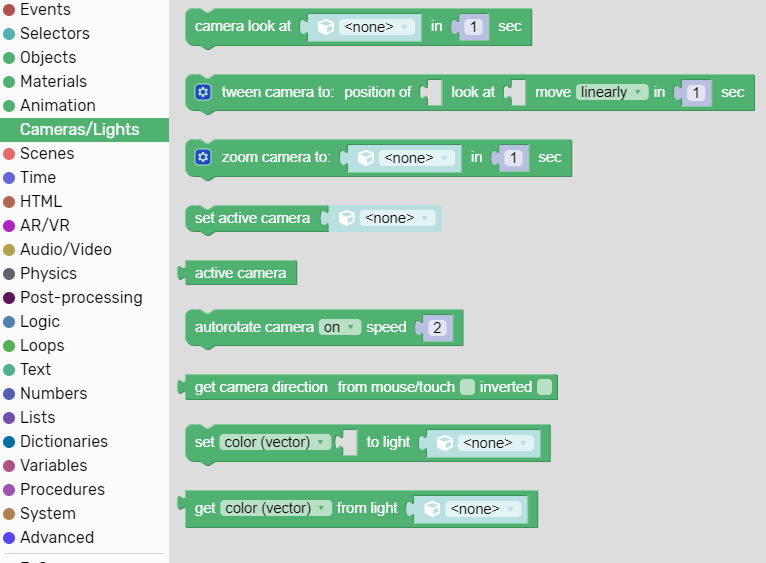

    For this you can use special camera puzzles like “Camera Look at”

    But doesnt the camera look at, centers the target to an object, which means that it will also be centered in the screen?
