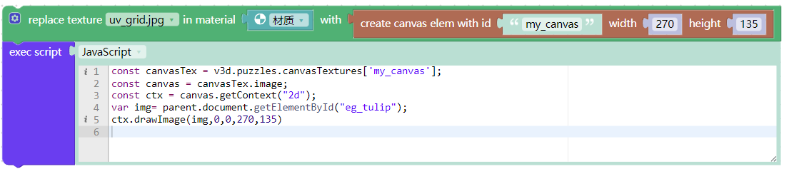

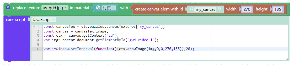

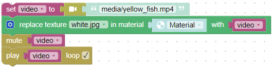

    picture as texture is work but texture is video don’t work

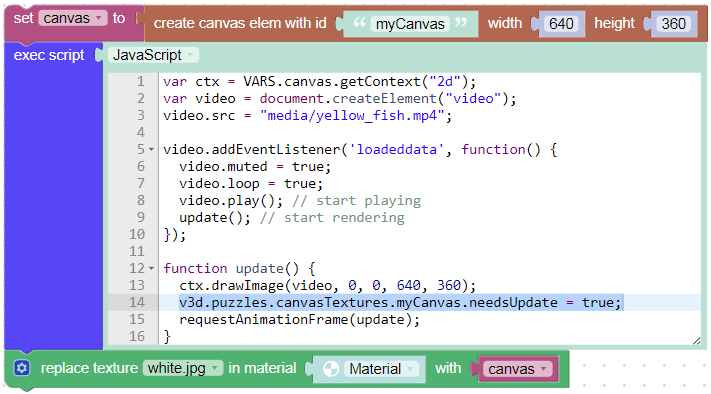

    You should update the canvas texture to see video playing.
    https://v3d.net/bk0

    #56603
    const ctx = VARS.canvas.getContext("2d");
    const video = document.createElement("video");
    video.src = "media/yellow_fish.mp4";
    const video1 = document.createElement("video");
    video1.src = "media/small_video.mp4";
    video.addEventListener('loadeddata', function() {
      video.muted = true;
      video.loop = true;
      video.play(); // start playing
      video1.muted = true;
      video1.loop = true;
      video1.play(); // start playing
      update(); // start rendering
    function update() {
      ctx.drawImage(video, 0, 0, 320, 180);
      ctx.drawImage(video1, 320, 0, 320, 180);
      ctx.drawImage(video1, 0, 180, 320, 180);
      ctx.drawImage(video, 320, 180, 320, 180);
      v3d.puzzles.canvasTextures.myCanvas.needsUpdate = true;
      requestAnimationFrame(update);
