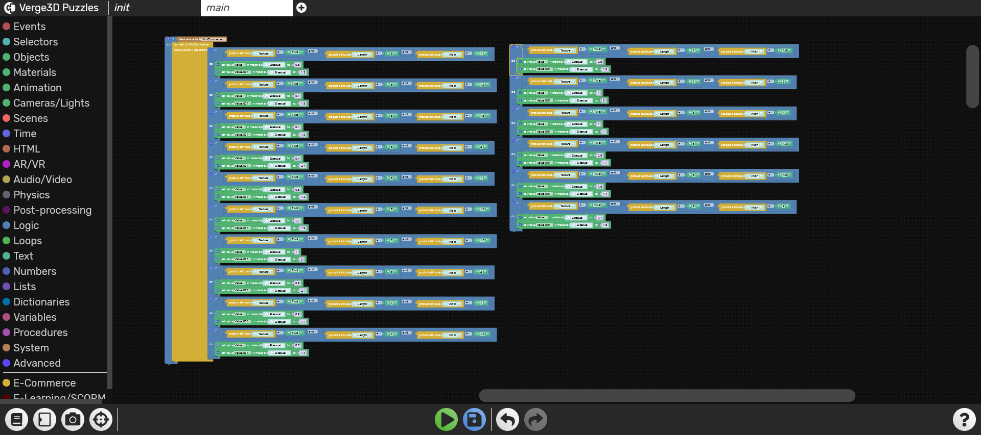

CustomerHello, I have a Woocommerce app where I need to set the scale and position of 9 materials to different values depending on the variant combination for the product.
I connected values in the materials nodes but the problem I am having is that I have 16 different product variant combinations, if I need to do this 9 times for each material that is a LOT of puzzles (I attached a screenshot with the puzzles needed for one material).
Is there a way to ‘set value’ for a group of materials, or is there a better way to make this work?
Thank you!

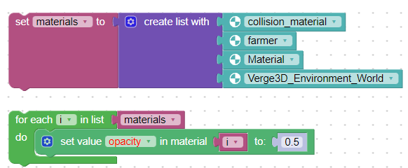

2024-01-16 at 12:59 pm #69730kdv
ParticipantCould you make a little more informative screenshot?
With letters readable…If your 16 materials have exactly the same values it’s quite possible to do the job using a loop for a list of materials.

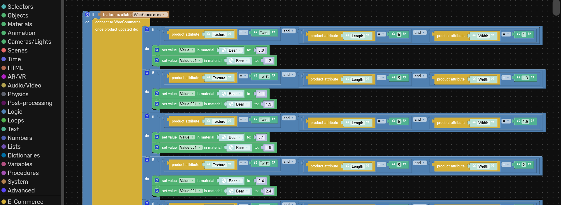

2024-01-16 at 1:02 pm #69732darstudio
CustomerSorry, here is a close-up. Basically, there are a lot of product options and I am wondering if there is a way to simplify the puzzles configuration?
2024-01-16 at 1:05 pm #69735kdv
ParticipantSee the screenshot above.

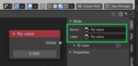

2024-01-16 at 1:12 pm #69736darstudio
CustomerThank you very much! I will try this. Also, stupid question, I am sure, but how can I rename the value nodes so I can tell them apart better?
2024-01-16 at 1:16 pm #69738kdv
Participanthow can I rename the value nodes so I can tell them apart better?

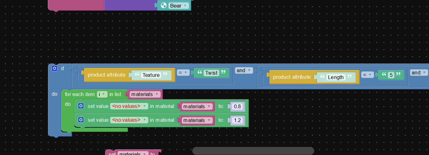

2024-01-16 at 7:27 pm #69748darstudio
CustomerHi, I tried this but it does not seem to allow me to select the value – the dropdown is empty/red. Have I done something wrong?
2024-01-17 at 2:55 am #69753kdv
ParticipantFirst, you’ve made a mistake. See my example with a little more attention. Second, remove variables from the “set value” puzzles, choose some material, choose values, put variables back.
2024-01-17 at 10:36 pm #69772darstudio
CustomerThat worked! Also, yes, my setup was wrong, once I followed yours exactly (first setting the value with one of the materials and then replacing it with i) it worked fine. Thank you very much
