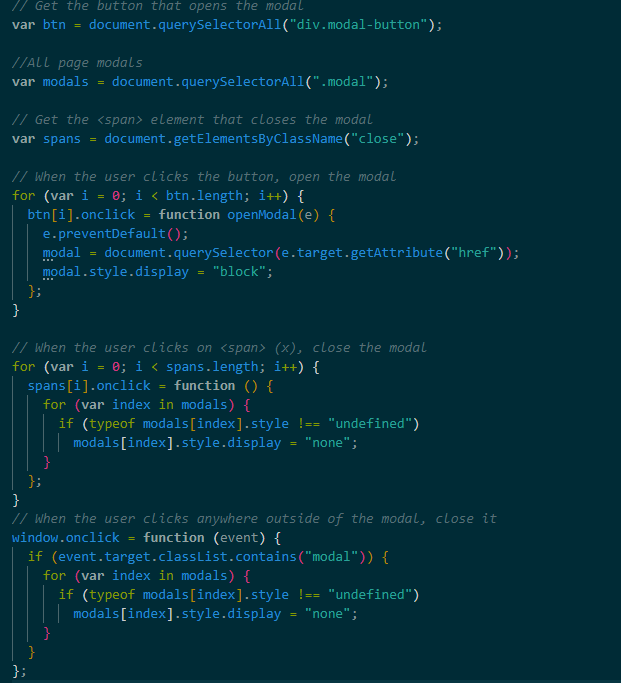

Ilia BgParticipantI have a JavaScript file with script for modal windows, i link this file to my Custom_UI.html – the UI file, where orginial “projectname.html” is embedded
I add annotation to my scene, it is there, i make simple puzzle setup – when clicked on this annotation -> call external function, that open modal window, i already find out that in order to use puzzle “call external function” i need to put my function in “projectname.js” file at “functionExternalInterface(app){} block.
But i am very bad at JS and can’t figure the right way of inserting my script.
Script for modal windows:
I will attach the same code as a screenshot in case it will be better to understand this way// Get the button that opens the modal var btn = document.querySelectorAll("div.modal-button"); //All page modals var modals = document.querySelectorAll(".modal"); // Get the <span> element that closes the modal var spans = document.getElementsByClassName("close"); // When the user clicks the button, open the modal for (var i = 0; i < btn.length; i++) { btn.onclick = function openModal(e) { e.preventDefault(); modal = document.querySelector(e.target.getAttribute("href")); modal.style.display = "block"; }; } // When the user clicks on <span> (x), close the modal for (var i = 0; i < spans.length; i++) { spans.onclick = function () { for (var index in modals) { if (typeof modals[index].style !== "undefined") modals[index].style.display = "none"; } }; } // When the user clicks anywhere outside of the modal, close it window.onclick = function (event) { if (event.target.classList.contains("modal")) { for (var index in modals) { if (typeof modals[index].style !== "undefined") modals[index].style.display = "none"; } } };Attachments:

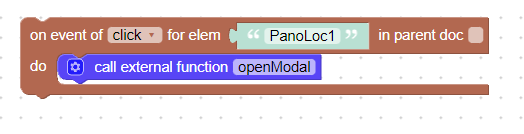

I tried what you suggested and find out that it will run this code instantly once the application is loaded.On the other hand, if i put my code inside of
function prepareExternalInterface(app) {}i then successfully called my function on demand, in my case – on event of click on annotation with the simple puzzle that was shown in “screen1” attachment.So i put my code into
And it doesn’t work, i guess the problem now lays in my code, since it needs variables to run but since i put the script simply infunction prepareExternalInterface(app) {}it can’t get elements by their respective class from my Custom_UI.html in order to declare? Or maybe it’s because i don’t specify what exactly modal i want to open, so i need to remake the script?Sorry for long text, i am just lost at this moment

I made tests with simpleconsole.Log("Hello, World!");I have tried your suggestion and find out that if i put my code into
runCode(app)it will run it once the app is loaded, this is not what i exactly wanted.On the other hand, if i put it in
prepareExternalInterface(app)function, i can then access it on demand with the puzzle that i have shown in screen1 attachment, in my case – on event of click for an annotation. So with simpleconsole.Log("Hello, World!");everything works.The problem now lays in my code i think. I have two guesses.
First one: becuase i put the code straight in
prepareExternalInterface(app)function, it can’t access my Custom_UI.html file to get elements by their respective class names and so it can’t declare variables and that’s why it doesn’t work.Second: it doesn’t work because this script is used for multiple elements, and if i am trying to call this script, it doesn’t know what modal i would like to pop up
