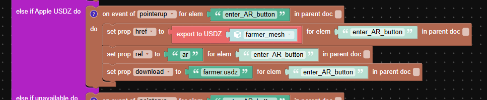

    #84625
    NaxosCG
    Here is the puzzle for now…
    #84627
    and again… read this topic, the very top of the second page…
    #84628
    NaxosCG

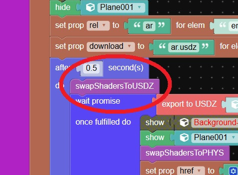

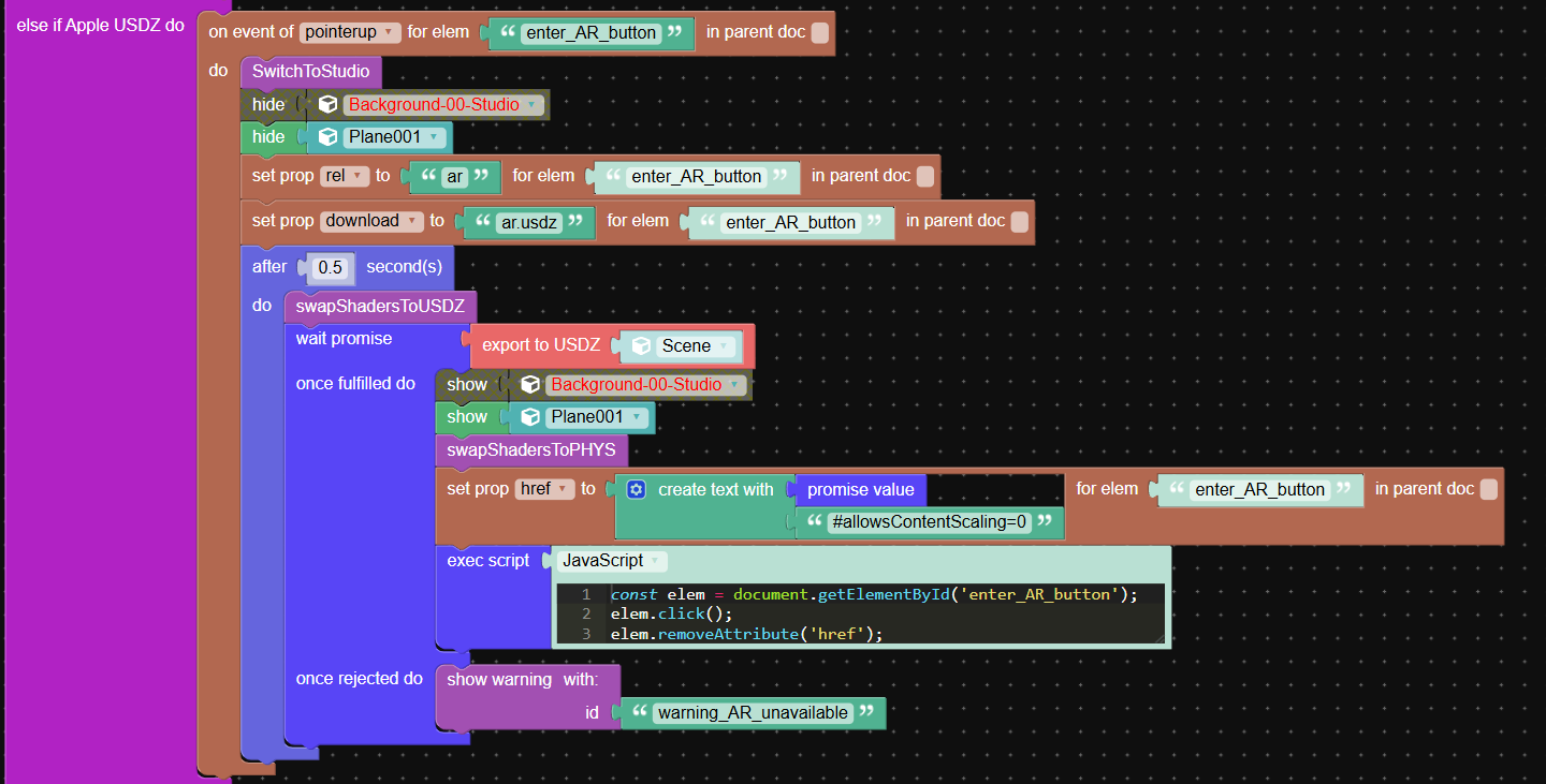

    Ok, i went in my apps archives, and changed the puzzle for the old one (see screenshot), and it seams to work now.
    I don’t really understand the “wait promise” and other puzzles here, but it works.
    The new puzzle was very simplier for me, but it does not work.
    Any idea would help to go back to simple puzzle…
    #84630
    it waits for USDZ exporting to be completed before downloading the result. just use it “as is” and it will work as expected.
