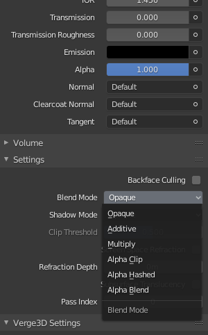

GLiFTeKCustomerYou can place a semi-transparent plane in front of the camera and add some sort of darkening to it’s corner to get vignetting effect, but this may cause problems for rendering another transparent objects in the scene. But you can try to set this plane to Multiply Alpha mode this may help in some moments.
where exactly would i find the blending mode option for applying “Multiply Alpha”? in blender, Verge3D, or actually just in written code?

Mikhail LuzyaninStaffwhere exactly would i find the blending mode option for applying “Multiply Alpha”? in blender, Verge3D, or actually just in written code?
It’s in the material settings.
