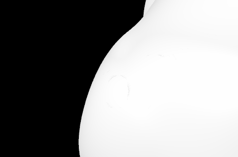

    OMG I just had to wait a long time for the sneak peek to appear! It appeared! It’s working! I still have 3 questions though:
    Why is this weird banding appearing? (example on the GIF)
    How can I change the background color on the Verge export?
    How can I make the animation run way slower?
    #51669
    Not sure, can’t reproduce it. Can you give some specs of the PC and gtaphic card where the issue appear?
    In world section of material editor.
    You can change it in puzzles byt changing speed, or add more keys, or scale keys in key editor.
