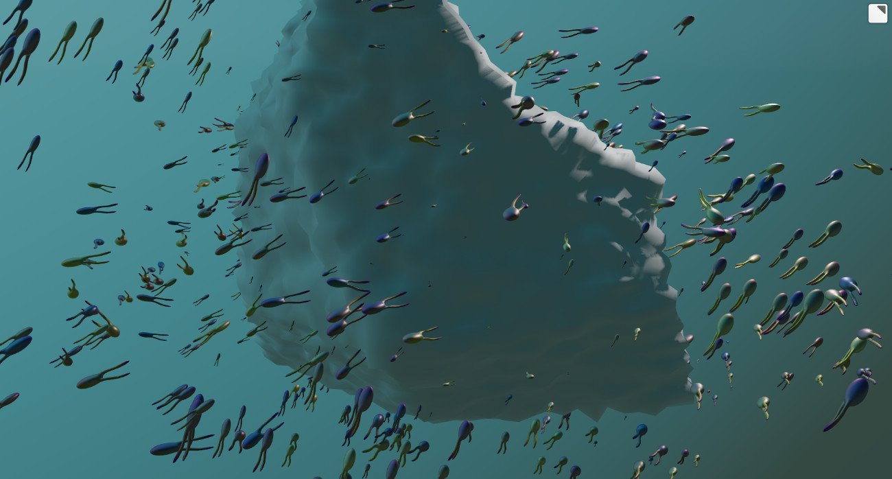

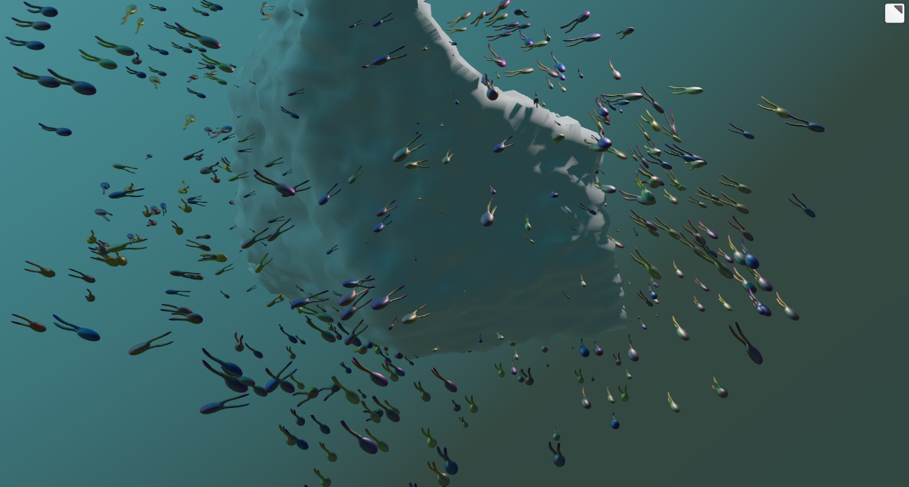

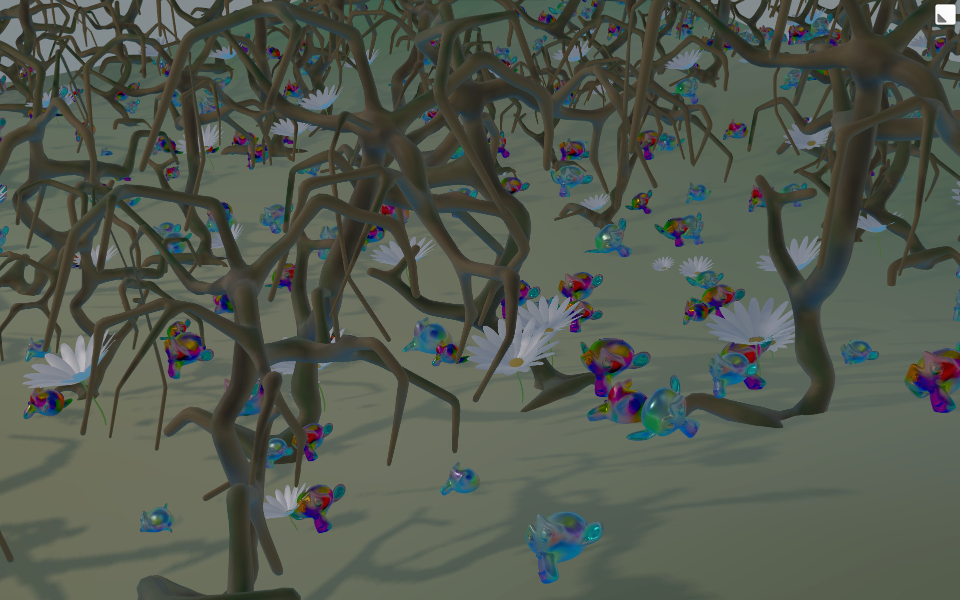

    Blender 2.93 Geometry Node results can now be exported to Verge3D. I have a tip!
    If you have used GN to scatter objects, don’t apply the modifier but go to Apply, (Ctrl A) Make instances real.
    That way all objects are instanced. (Make sure you immediately put the instanced objects into a new Collection.)
    If you apply the GN modifier, all objects are joined into one large inefficient mesh.
    I have included some screenshots of some test results.
    Enjoy making good use of this great new Blender feature in your Verge3D projects. :yes:

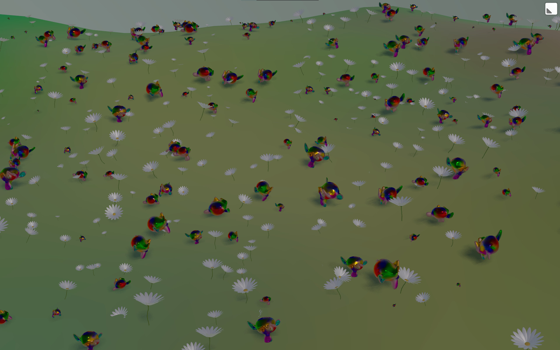

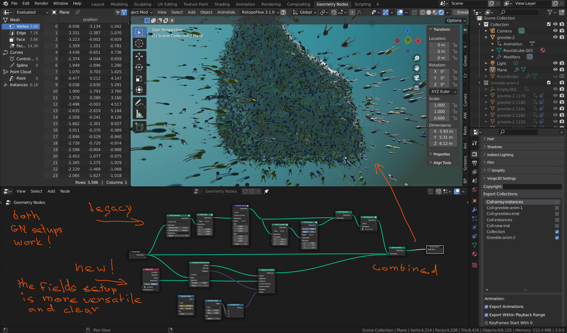

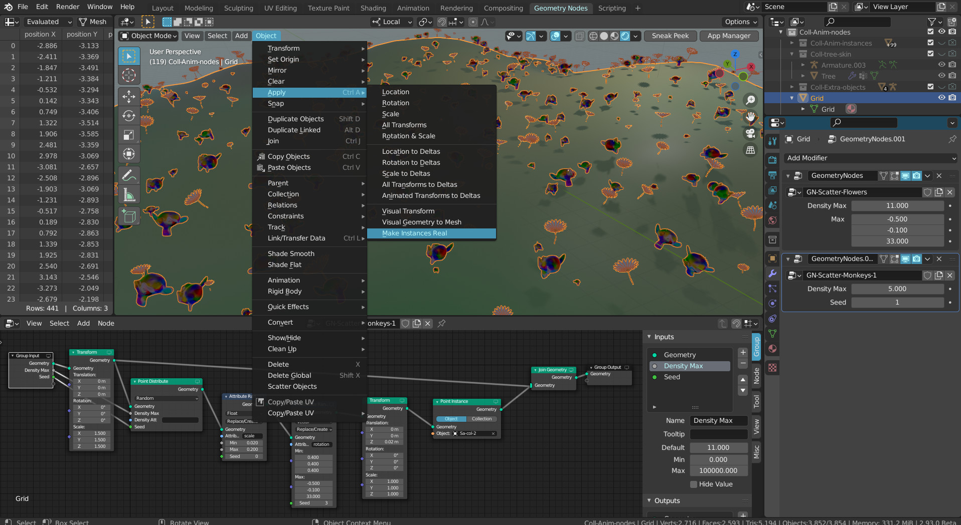

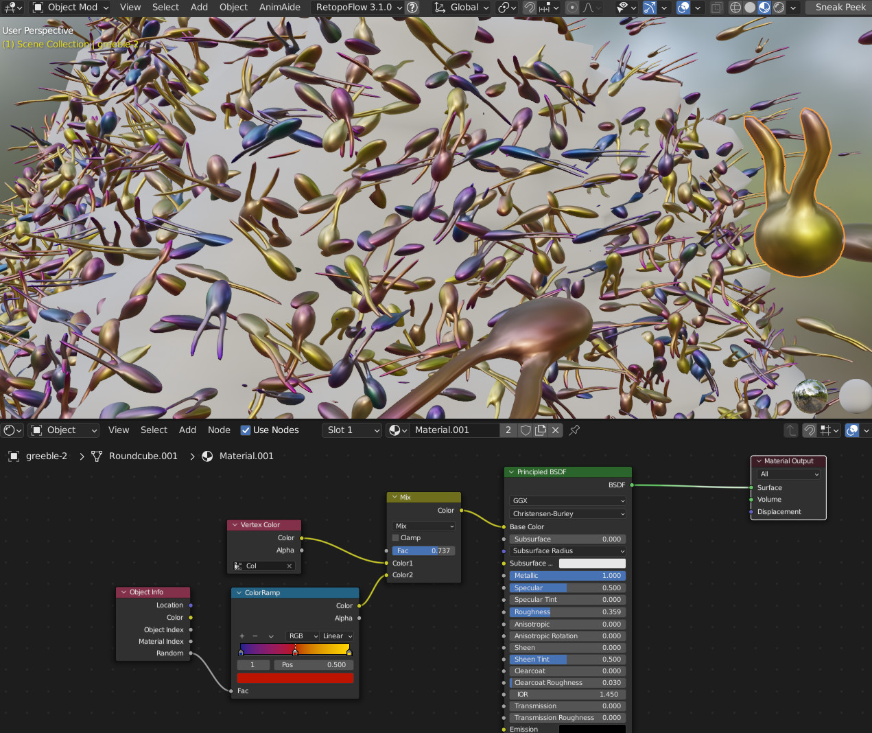

    I’m working on different kinds of projects now, so I hadn’t tried it out yet. I assume it works in quite the same way for both legacy and the new Fields setup.
    After the Geometry Node setup just, Apply: Make instances real.
    I quickly did a test in Blender 3.0. And the result is you can even combine both setups. It works great! :good:
    I would advise though, to learn the new, more versatile and practical Fields setup. In the simple example (see attached image), you can see both setups combined and working alongside.
    I distributed only one object but, you can also distribute different objects from a collection. Possibilities are endless.
    Make sure when you make the instances real to immediately place them in a new collection. If the original has animation, transfer animation data to the instances by linking the animation data.
    Verge3D can handle quite a lot but don’t overdo things! :wacko:
    Just start experimenting, try things out and check that the frame rate doesn’t drop too much in the browser.
    By the way, the Displacement modifier and the Material node: Object Info for random colouring, both work well in Verge3D. :heart: I both used them in my little example.
    Have fun experimenting!

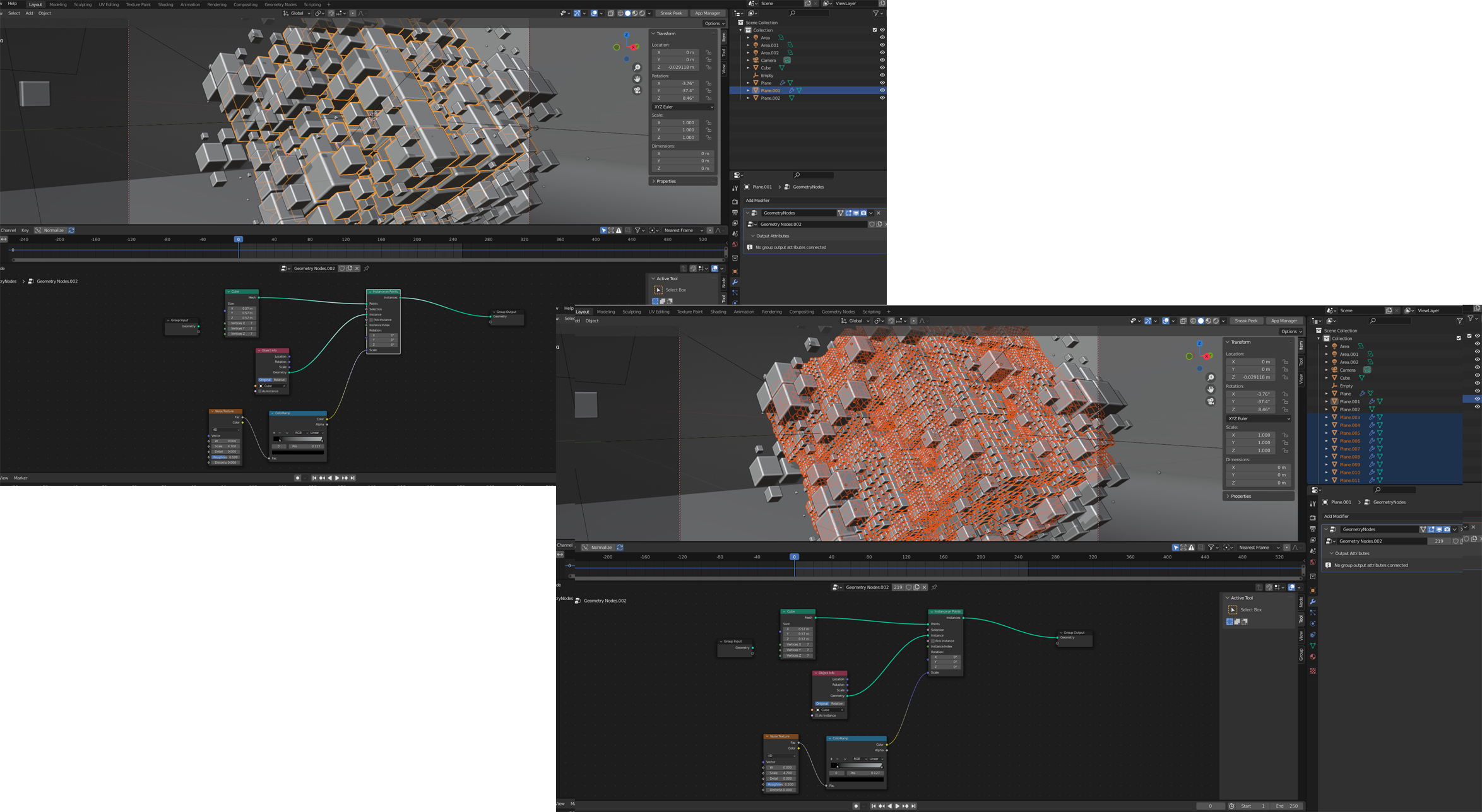

    dusik geum
    Please take a look at my work.
    I followed it exactly the same way, but I got a strange result. Post your photos before and after. I can’t find a way out of my head.
    I also got some weird results as like you said.
    illussimo,
    How did you did you get it & with specific version as you said?
    I tested in Blender 3.2 & V3D 4.4
