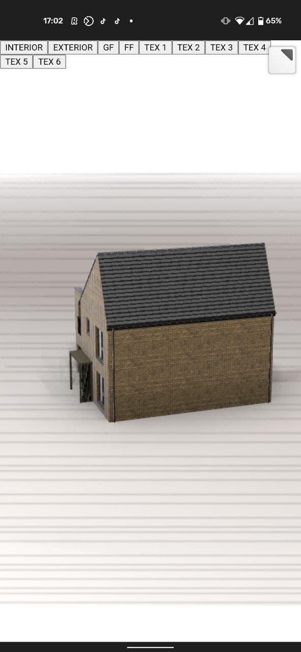

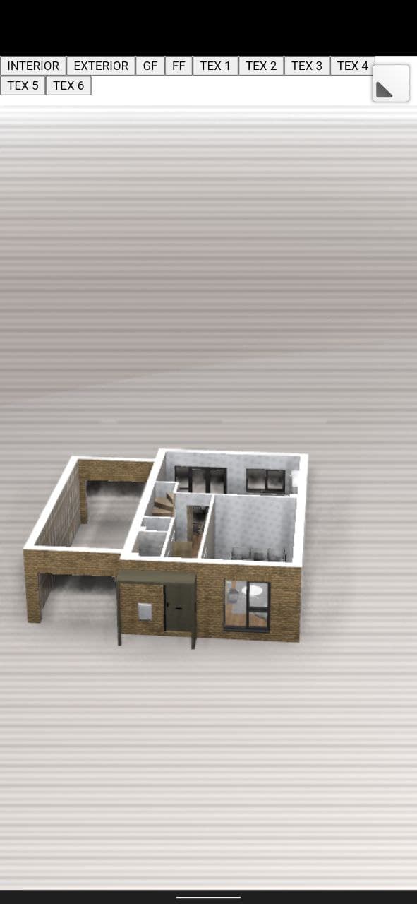

    These artifacts only appear on mobile (5 different devices tested, iOS and Android).
    #46047
    Eugene Zos
    This shows only on the mobiles, PC (Chrome, FF) and Mac (Safari) are fine.
    As soon as I turn off Ambient Occlusion, everything is working fine on mobile. Also on the mobile, the antialiasing is pretty horrid.

    I came to a point where I just enable AO in any of the bundled apps and there is the same effect on mobiles. Is this a bug?
    #46591
    Any update on this?
    Hi, these artefacts look similar to the ones reported here: https://www.soft8soft.com/topic/ao-issue-on-mobile-device/.
    They should be fixed in the upcoming verge3d update (next week most likely).

    The fix should be available right now with the new pre-release version: https://www.soft8soft.com/topic/verge3d-3-9-pre1-available/
