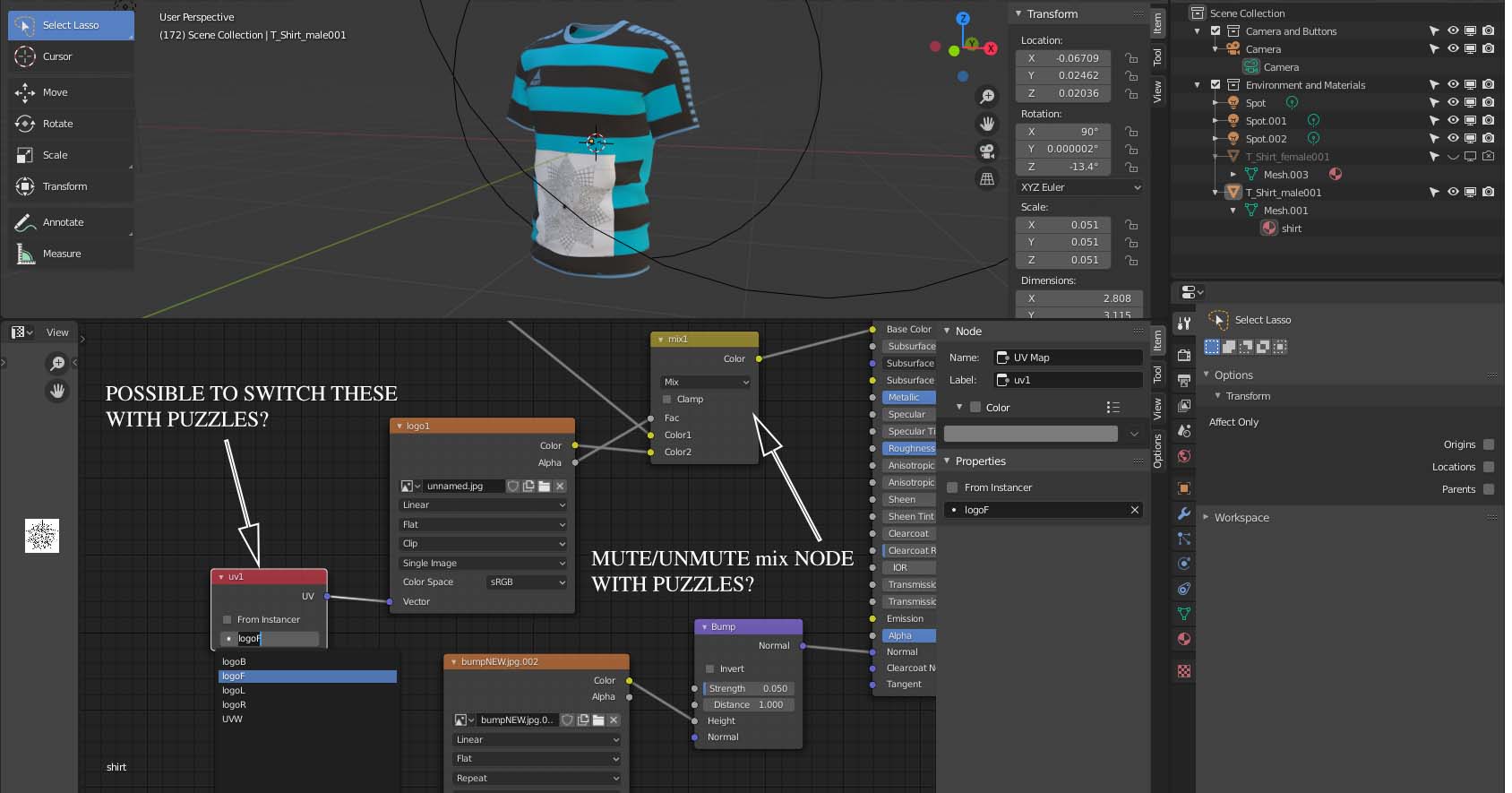

    Can you please help with Further questions (please view the attache image)
    1 – can i mute/unmute a mix node from puzzles? if yes how?
    2 – can i switch UVW from within the puzzles? if not whats the alternate?
    thanks in advance.
    #33103
    You can connect a value node to it and change it’s value from one to 0 woth Set Value puzzle
    You can create two (or more) UVs and connect them to mix color node and connect a value to it’s facter and change it with puzzle from 0 to 1, so only one will work.

    Thank you Guys,
    everything working as intended (for now) :yahoo:
