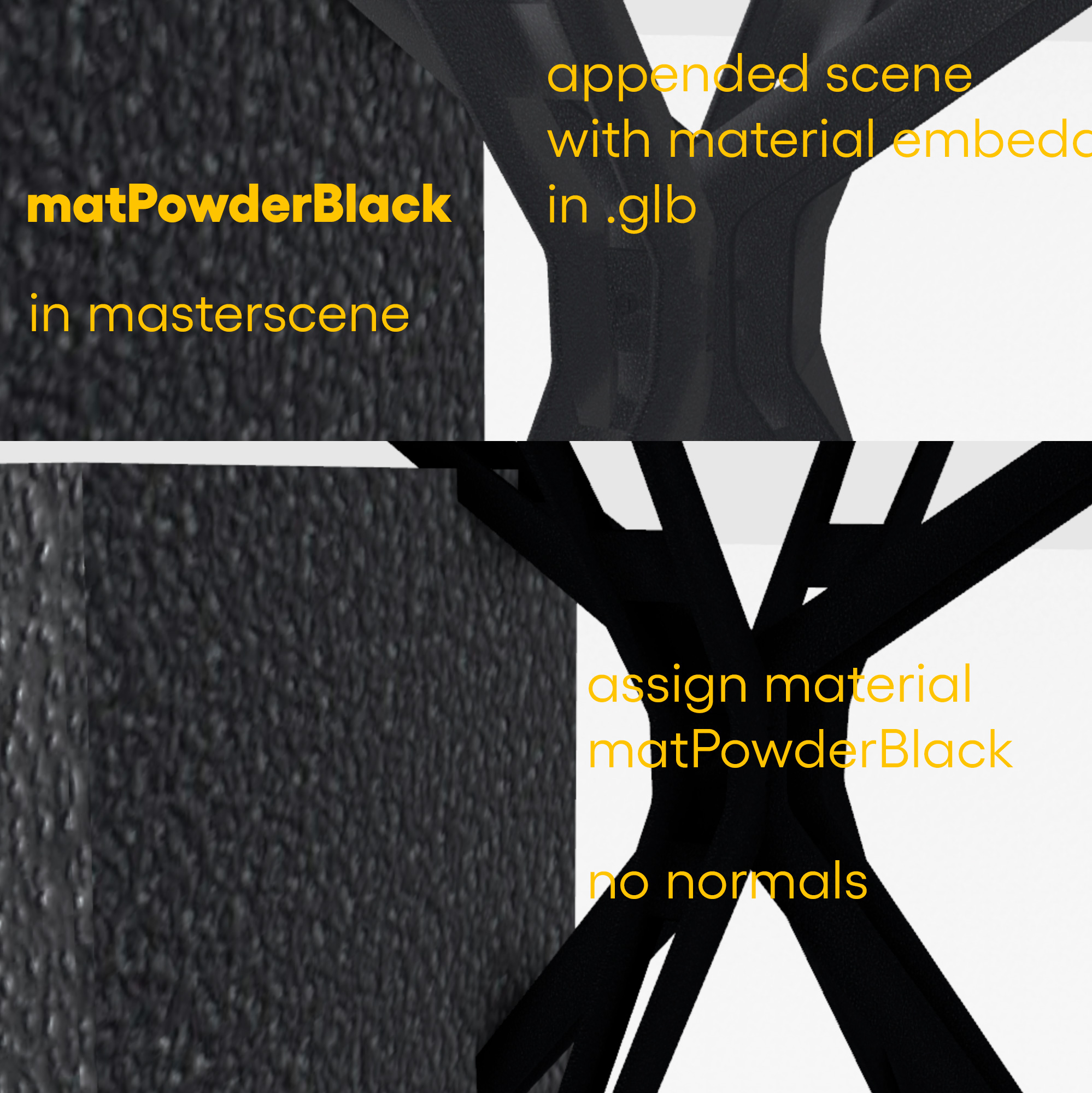

    I have a masterscene with an embedded powdercoat material (‘matPowderBlack’) assigned to a dummy-object.
    When appending an object to the scene (meubar_tablefoot.glb) with the same material embedded into the glb (tablefoot.glb), the material shows on my object (top half of the picture)
    However, when I assign ‘matPowderBlack’ to the tablefoot object, the normalmap doesn’t show

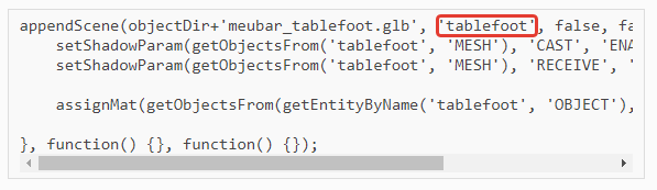

    appendScene(objectDir+'meubar_tablefoot.glb', 'tablefoot', false, false, function() {
        setShadowParam(getObjectsFrom('tablefoot', 'MESH'), 'CAST', 'ENABLE');
        setShadowParam(getObjectsFrom('tablefoot', 'MESH'), 'RECEIVE', 'ENABLE');
        assignMat(getObjectsFrom(getEntityByName('tablefoot', 'OBJECT'), 'MESH'), 'matPowderBlack');
    }, function() {}, function() {});
    Any idea what I’m doing wrong?

    The most likely reason:
    I suppose the mesh in the appended scene is also named as “tablefoot”? Without the example itself it’s hard to say more.
