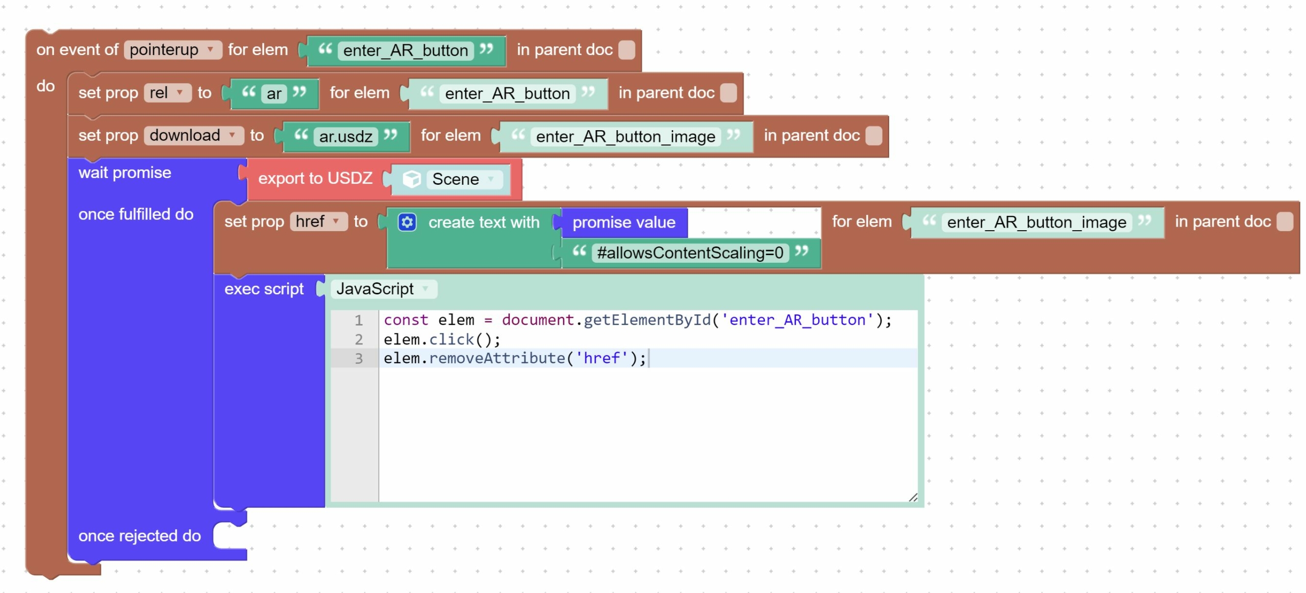

    As I see, nothing changed since the lust screenshot ))) First, change set prop alt to set prop rel. Then move puzzles to the last slot and run them on you desktop/laptop. The downloaded file must be larger than 321 bytes.

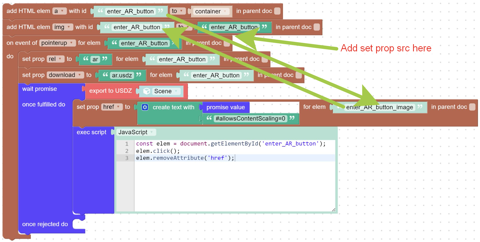

    And why did you replace enter_AR_button with enter_AR_button_image? Do not change id in the puzzles. Just add your puzzles creating <a> and <img> elements before the on event of pointerup puzzle.

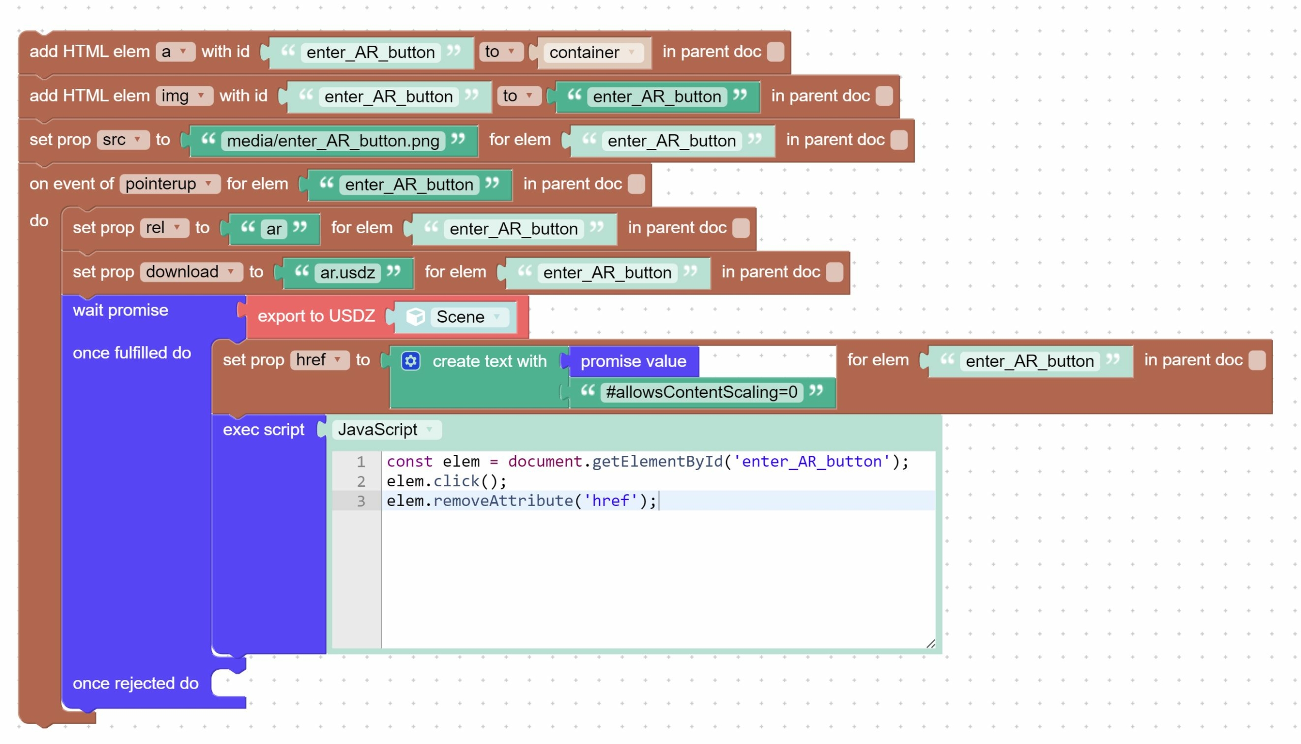

    I have uploaded the files in the link below. The puzzle see appendix I have. But it doesn’t work? I don’t see a button..

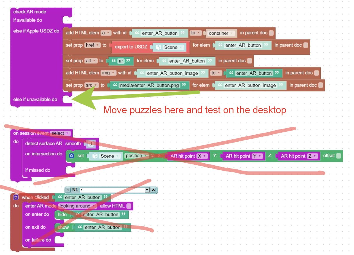

    And move (or duplicate) the puzzles into the else if unavailable do slot to make them work in the desktop browser.

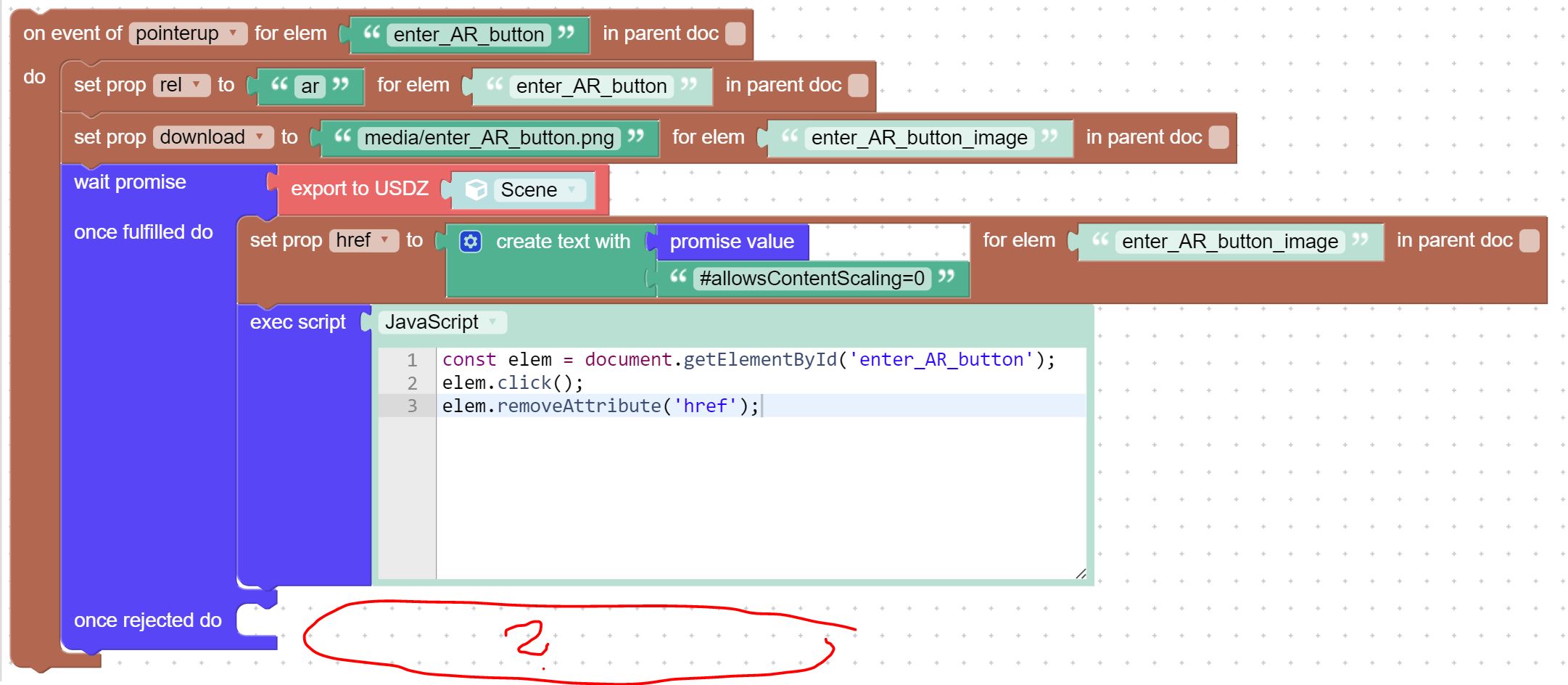

    Here is my puzzle. I don’t understand : And move (or duplicate) the puzzles into the else if unavailable do slot

    Look at the screenshot here https://www.soft8soft.com/topic/ask-wordpress-woocommerce-ar/page/2/#post-57211
    And make some changes

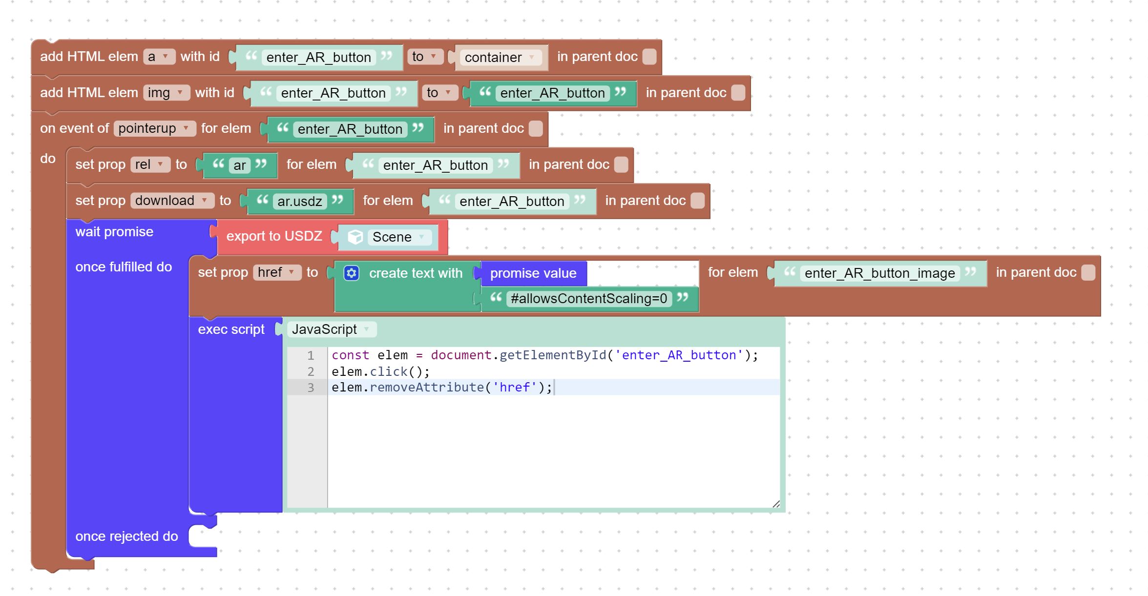

    Here is my puzzle. I hope I got it right. But I don’t see an AR button in the iPhone
