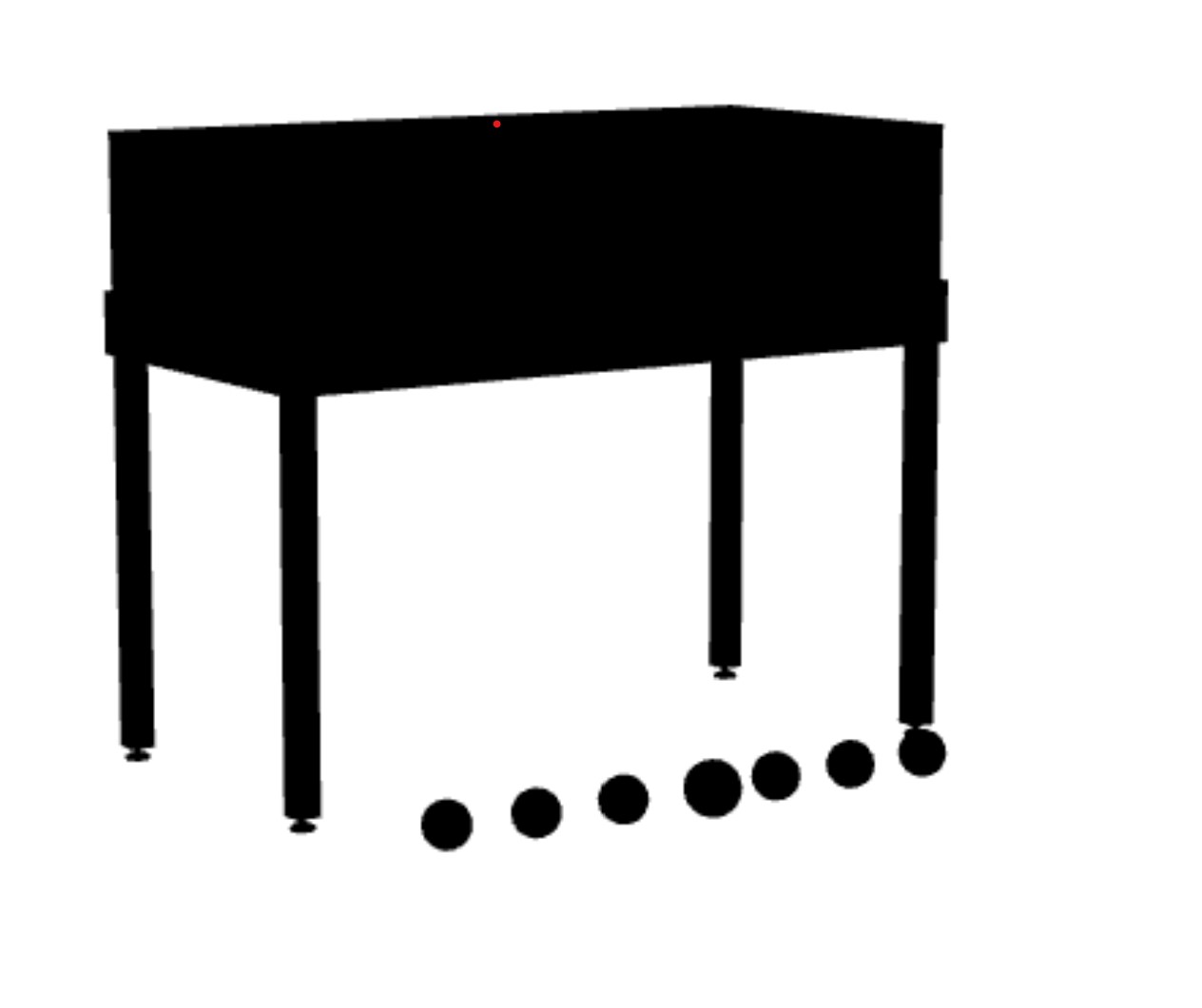

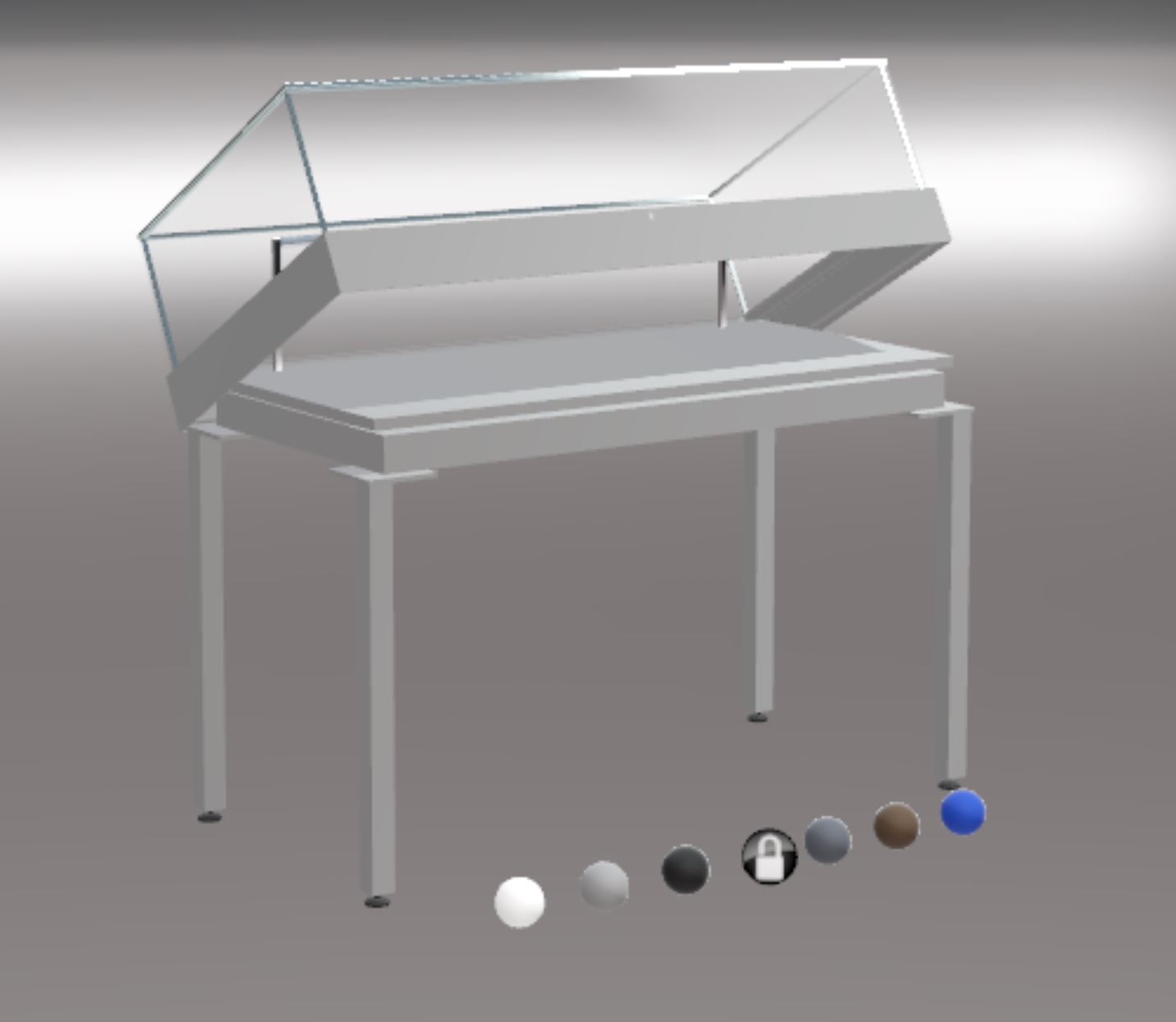

    #56546
    Gabriel Malzer
    Enclosed two pictures of my problem with the materials in 01 picture you can see the object on the html page. in 02 picture you can see the directly opened gltf file or how it is visible at sneek peak why is it that the objet is only black?
    #56548
    Gabriel Malzer
    #56562
    I’d suggest the scene is unlit (and the background is transparent. otherwise it would be black too). Or maybe worldMaterial is absent. Try to add this puzzle
    #56590

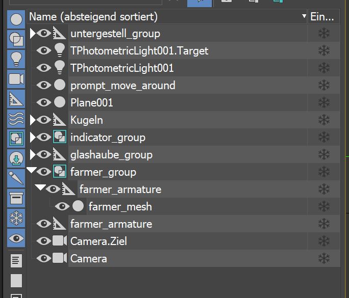

    Gabriel Malzer
    I use the example “augmented reality” from you. here I have inserted unterestell_group and glahaube_group. so that this becomes visible in ar mode, what do I have to do here? I can’t get any further with the ar right now..
    #56594
    In the Augmented Reality demo the world material is black and gives no light. The farmer itself has an emission map and so it’s visible in the darkness. In the Blender version the only light source is inside the farmer group (it gives shadows).
    If this group is hidden or removed there are no light sources at all. Thus, as I’ve said, the scene is unlit. Just add some light to your scene…

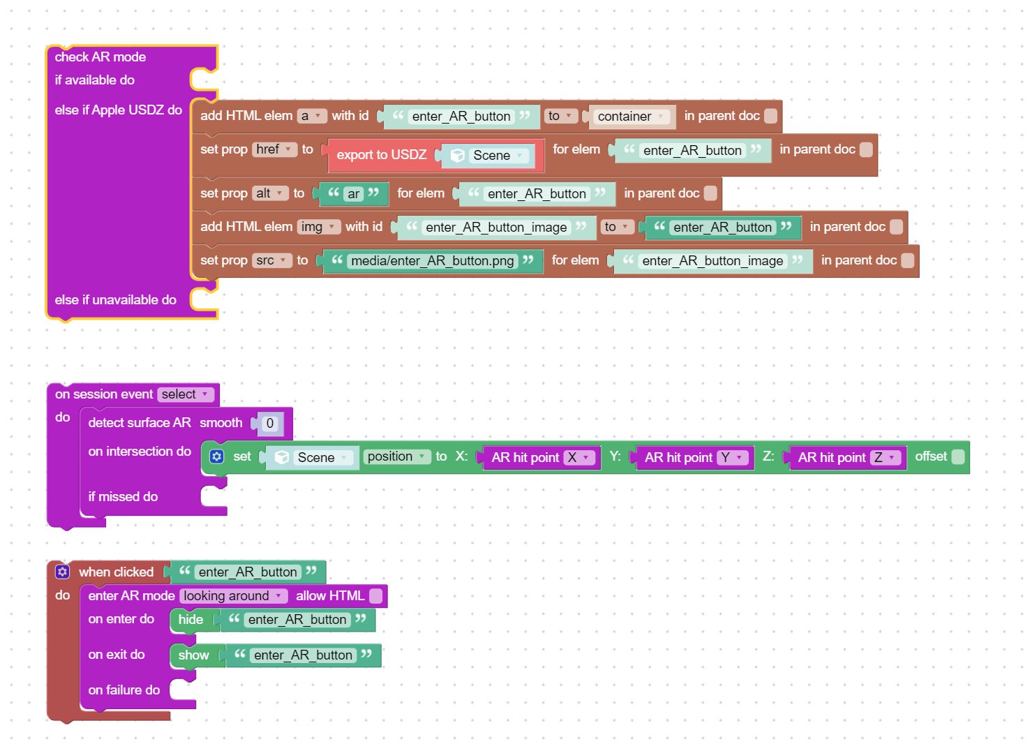

    Gabriel Malzer
    Hello,
    I still haven’t managed to integrate ar. Here is the link in the woocommerce
    https://vitrine.de/glasvitrinen/ar-tischvitrine-saturn/
    Enclosed also my puzzle. What else am I doing wrong here?
