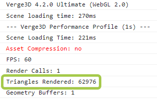

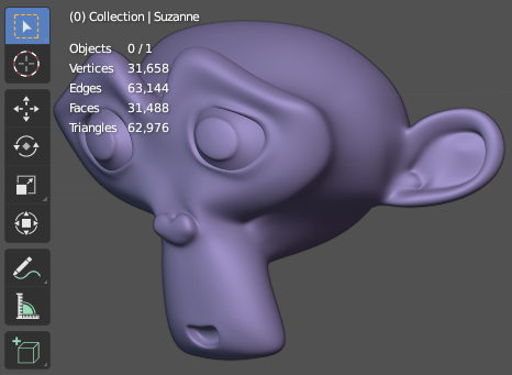

    10 default Suzannes it’s less than 10k triangles (9680). There is no much sense to use any compression in this case. The effect will be noticable with 50k and more triangles and DRACO beats with no loss (161kb vs 700kb=>1,43mb).
    LZMA beats if you have several non-instanced copies of the same mesh. But if you have a complex scene with a lot of different meshes or those copies are instanced…
    DRACO compressed with LZMA gives even more impressive result. Especially with non-instanced clones.
