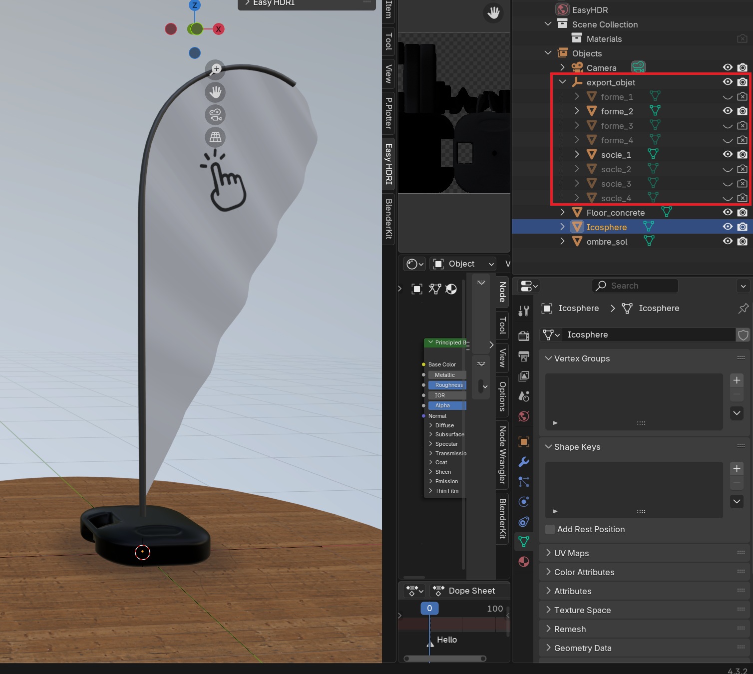

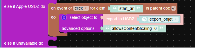

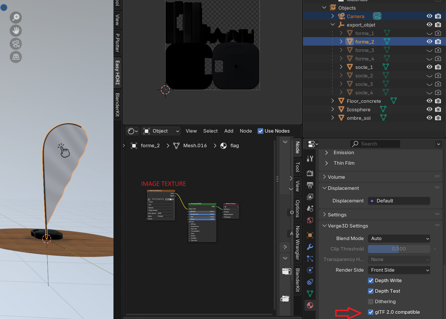

    gestion
    Hi Kdv,
    I just bought your addon too but I can’t make it work.
    I can export my object in augmented reality with android, so I guess the issue is not coming from Blender.
    Here is my project. You can configure your object and export it in AR.
    https://demos.figurative.fr/plv_drapeau/
    Could you have a look at it ?

    gestion
    I did that too.
    It is like it is not even trying to open quick look.
    Nothing happen on my Iphone but AR works fine on android
    #80378
    Send your app to kdv [at] izh [dot] com (in zip). I’ll take a look… And you should have been tested the standard puzzles from the official demo to make sure they work for you before buying…
