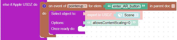

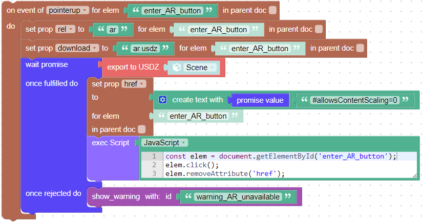

ParticipantThis set of puzzles should work properly. Only shape keys are not supported.
P.S. Don’t use
on event of clickotherwise you’ll catch an endless loop ))) Useon event of pointeruporon event of pointerdownPuzzles and JS coding. Fast and expensive.

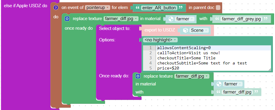

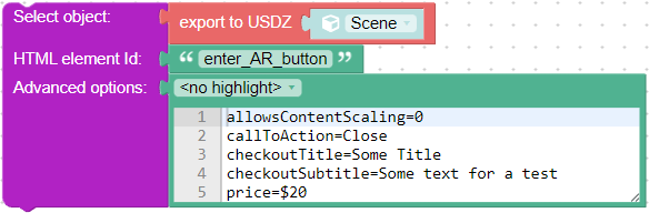

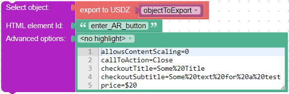

ParticipantAdded “Advanced options” text field for AR Quick Look URL options. You can find available options here.
For several options you can use the multi-line text editor. Spaces are allowed.
Prefered format
Get it on Gumroad

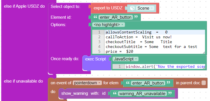

ParticipantReworked the plugin a little: removed the built-in event listener. Now it requires the
on event ofpuzzle to work. Do NOT useon event of 'click'!
And now the plugin puzzle can be placed inside the
once ready doslot to run exporting only after some action has been finished.

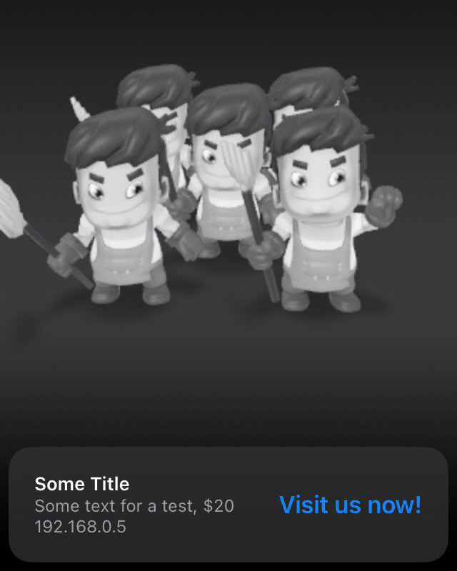

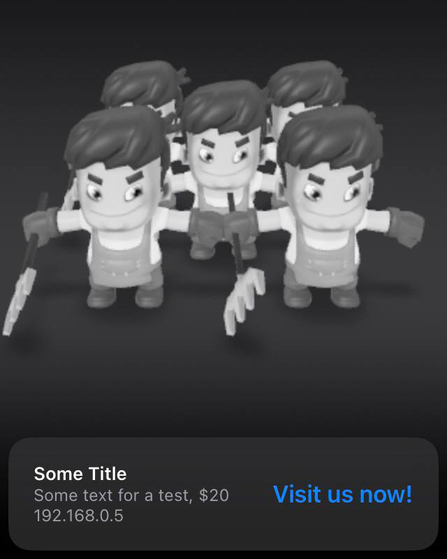

2023-01-11 at 5:28 pm #59506kdv
ParticipantYour demo does not show animated morphs in AR mode. I only see static models
the USZD exporter doesn’t support animations. It exports static models only (see the first post of the topic). For animations use the Apple’s special software…
Does the morph export apply to AR?
that’s the main feature and it works fine. In my demo the farmer’s animation is converted from the original bone animation to a shape keys animation. Every mesh in the scene has 140 shape keys.
See the difference. With no morphing all meshes are in the T pose.
