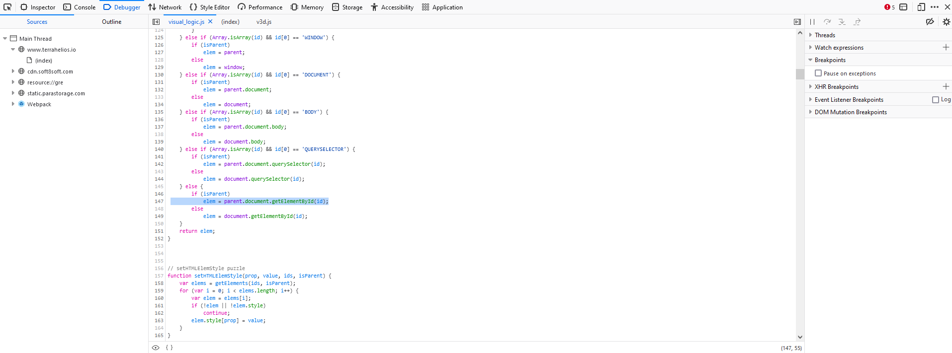

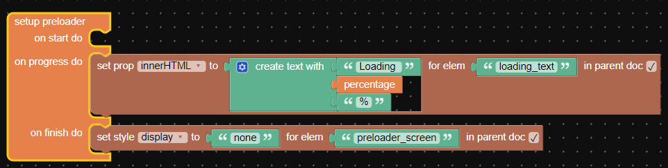

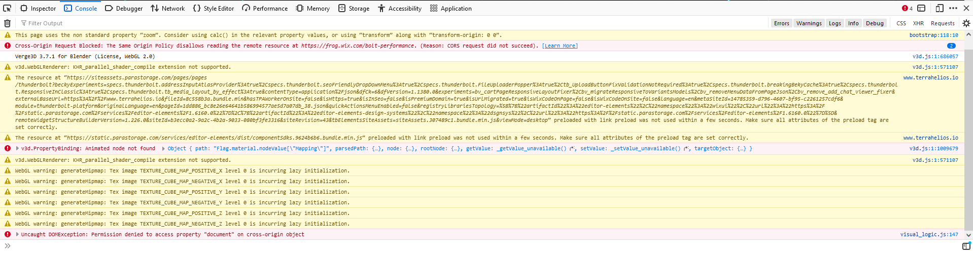

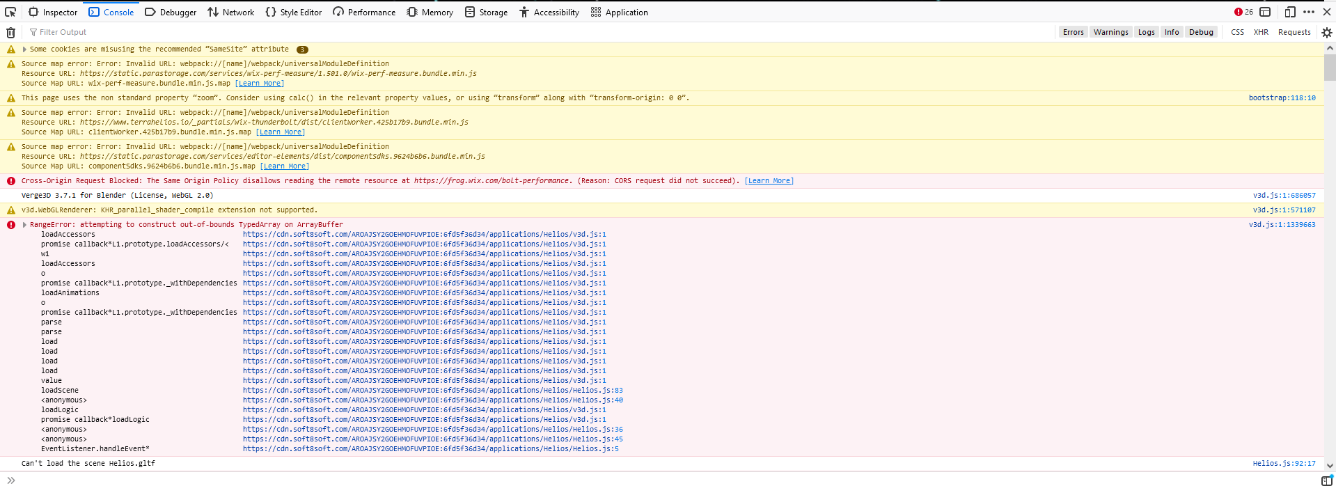

My app had no issues being embedded into my website until I added a custom preloader. My app works fine when loaded in verge3d (app loads after preloader finishes loading), however when embedding it to my website, it stays stuck on the preloader screen. Below I have attached the website’s console log and a picture of the preloader puzzle I used from this tutorial https://www.youtube.com/watch?v=aUOlSgaPoXg.

xeonCustomerHi ccoul,
Since I can’t directly see the issue you are having I can only point to what you may want to try based on the images you provided.
There is a cross-origin domain reference error. Depending on what is causing this and how your html page is set up it may just be aborting the load and timing out and thus not loading the verge content. There is a Learn More text link in the Console you will want to check out.
The puzzle reference may need “in parent doc” checked if you creating that div there.

CustomerThanks for the response. So my html, preloader graphics, and verge assets are on Soft8softs server and I am embedding them into Wix. The hmtl runs perfect on Soft8Soft’s server and produces an error when loading on Wix.
After making small changes I’ve come to the 2 errors I’ve attached below:
-v3d.PropertyBinding: Animated node not found
-Uncaught DOMException: Permission denied to access property “document” on cross-origin object
The thing is, I’ve already successfully embedded the app without the custom preloader before, so idk why it is stuck on the preloading screen now. I’ve also attached the line highlighted by the debugger in the visual_logic.js file below.

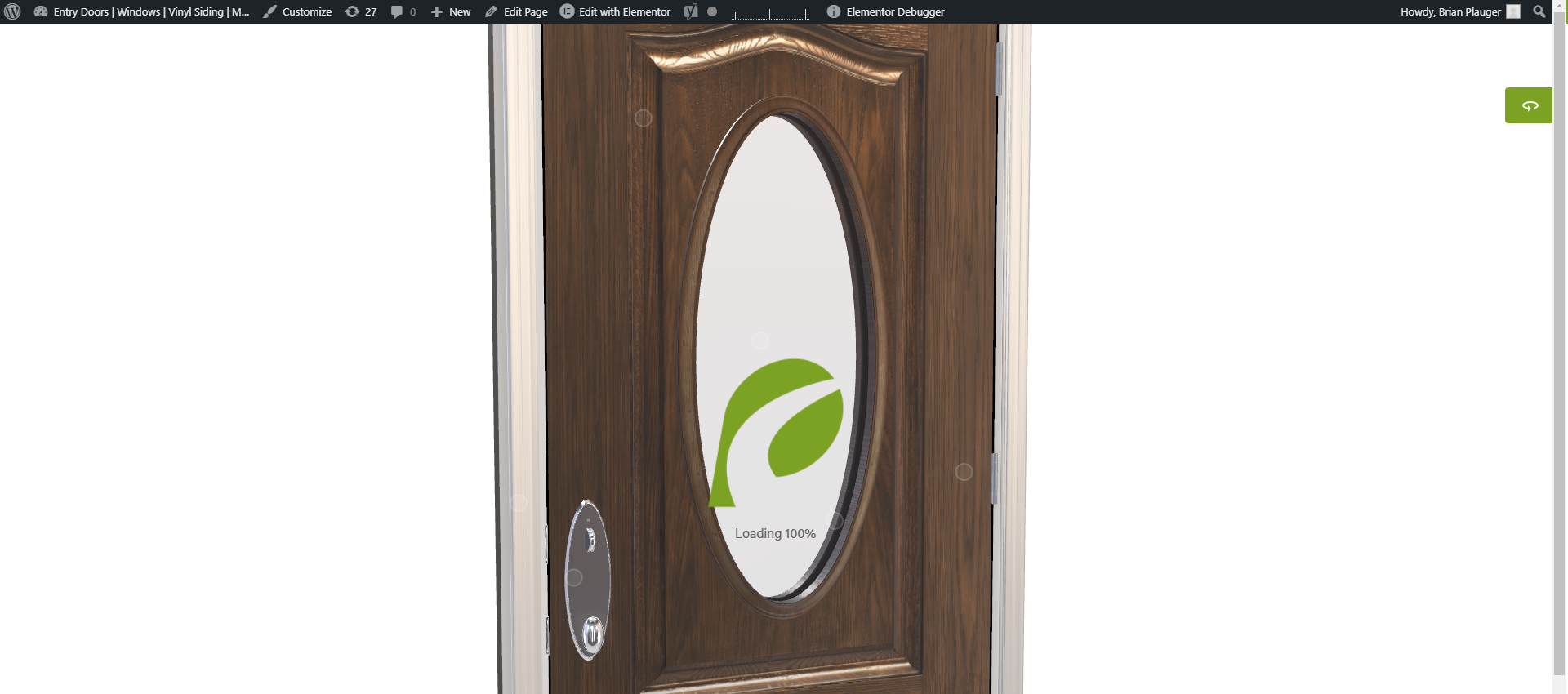

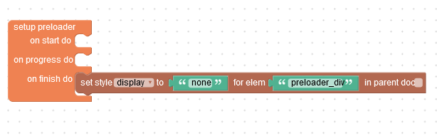

CustomerI am having the exact same issue. When navigating to the .html file on the server, the custom preloader runs perfectly. But when I embed it with shortcode on a page, the preloader refuses to hide after loading. It doesn’t even acknowledge or append the div style.

harisCustomerThis problem is happening because the logo is maybe outside of div that are setting display: none; after it is being loaded
2021-10-11 at 7:31 pm #46055Brian
CustomerSome answers to your questions:
– Yes I am using wordpress.
– The preloader runs perfectly on the local server, and the “html” file uploaded to wordpress runs perfectly, the problem exists as soon as I use embed it on a page. It completely fails to append the style ID to “display:none” The preloader runs fine but simply never hides itself when finished loading.-The issue is not that the app fails to load. It loads just fine, it just doesn’t set the ID to “display:none” when in an iframe.
-I searched countless times in the console and I don’t see any errors.
