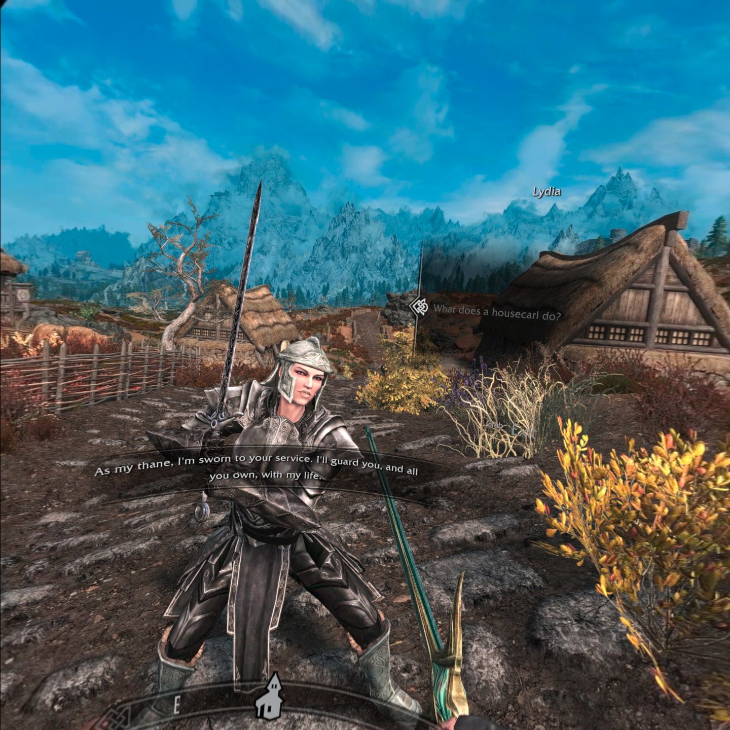

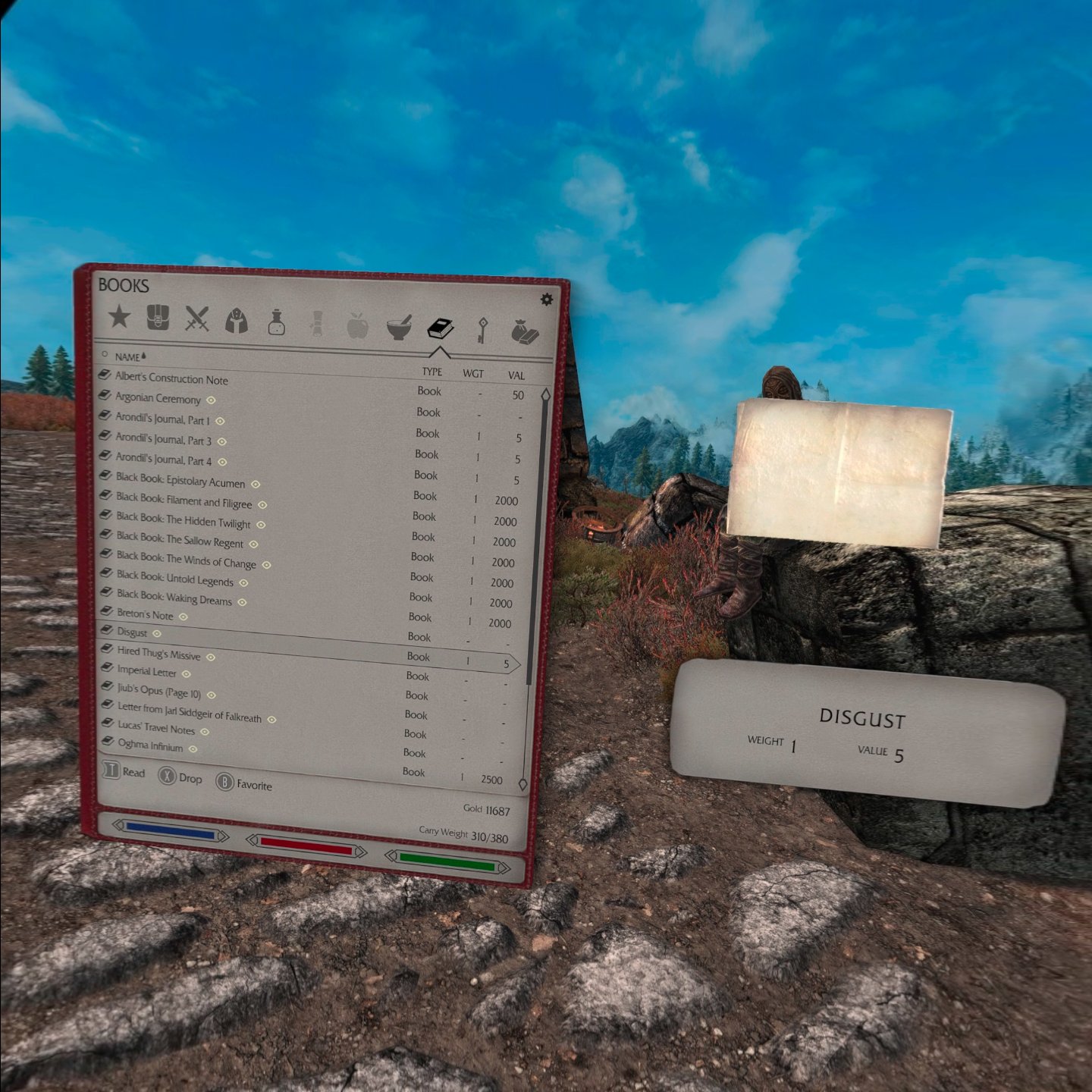

    The point is that in VR in any case you’ll have to use mesh-based system for annotations :unsure: Even in PCVR and native VR games they use textures on meshes to show text messages or control elements.

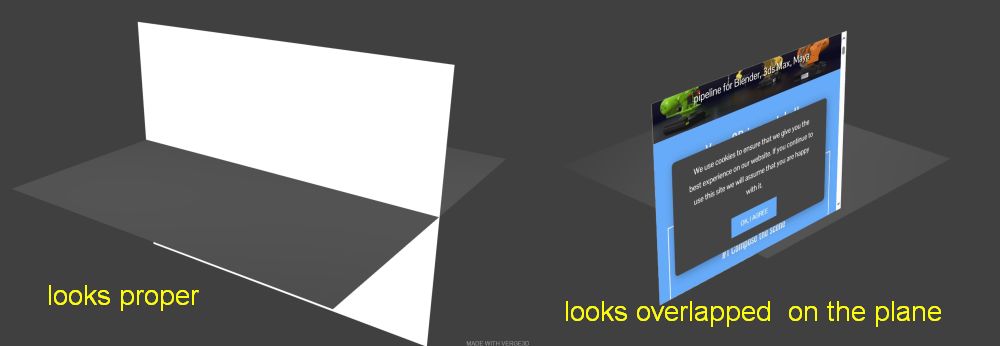

    2. Overlapping on geometry as seen in attached image. I tried changing material modes a few times.
    It just remains always visible ))) Annotations should be always visible :unsure:
    This one is not really convincing to stay always visible. If I walk out of a house the TV screen will still be seen through walls. This sounds like a limitation or a unresolved bug.
    If we see the equinox tutorial it shows how to hide annotations when they are going behind to avoid the unnecessary clutter in UI.
    #74426
    Yes, indeed. Here you can do nothing with CSS3DRenderer :unsure: That’s how it works I suppose. Maybe it’s possible not to render the back side, but the front side will be always visible. But you can use raycasting and show that plane only if no object is between the camera and that plane…
