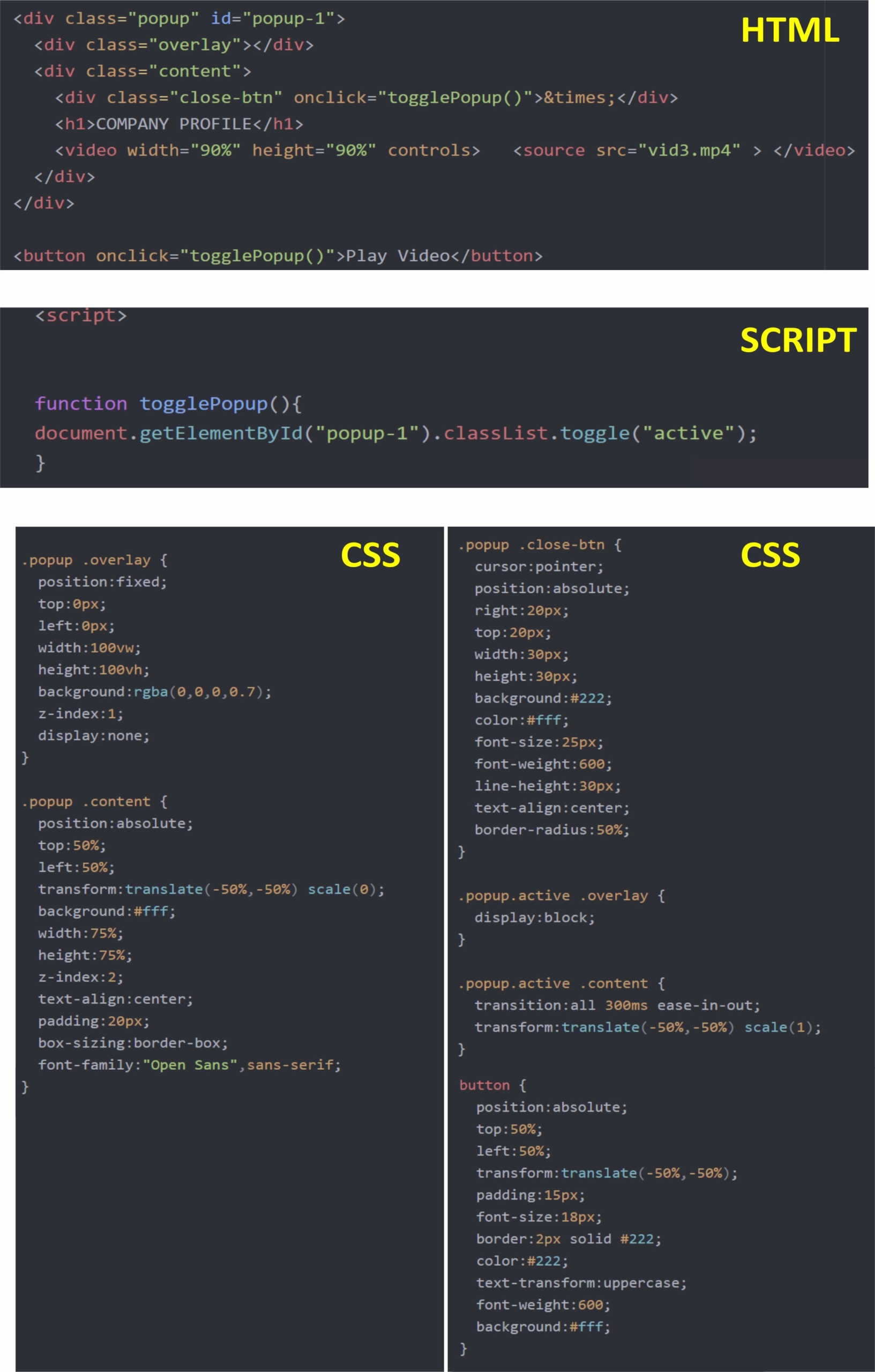

But i want to know if there is any way so i can make my annotation as per below link. Like when someone clicks on an annotation I will open in the center of the page, and have a close button.Because when I shared a link with some people, and they played video, the first question was how to close the video.
Ref video link:https://www.youtube.com/watch?v=VAfyl3JdvGA
One more question, is it possible to add blinking animation to annotation as shown in video.
2020-09-04 at 10:05 am #32408
Mikhail LuzyaninStaffThis was created not using annotation puzzle and it’s a combination of geometry that look directly at camera (like it made in Scooter demo) and html elements that showing and hiding on click on that object. So you just need to make a layout of the windows that you need to show and hide and then change it’s Display param on click of any object in your scene.

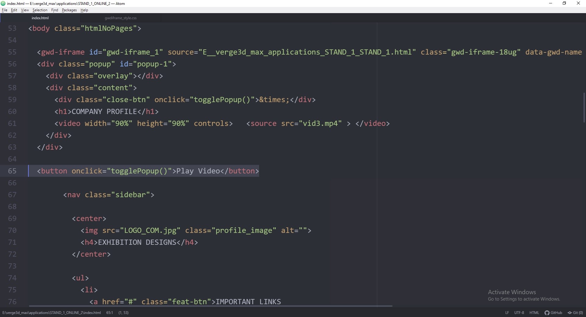

CustomerHi, @Mikhail Luzyanin
As per your suggestion , I managed to add one button to my project, which functions perfectly as I want. attaching project link and screenshot for your reference. If you please guide me how to add this onclick function to my annotation, this will be a great help for me, to complete my project.https://cdn.soft8soft.com/AROAJSY2GOEHMOFUVPIOE:4a0017f51a/applications/STAND_1_ONLINE_2/index.html

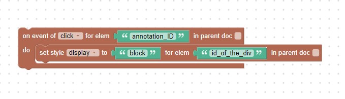

Mikhail LuzyaninStaffThe code will look something like this.

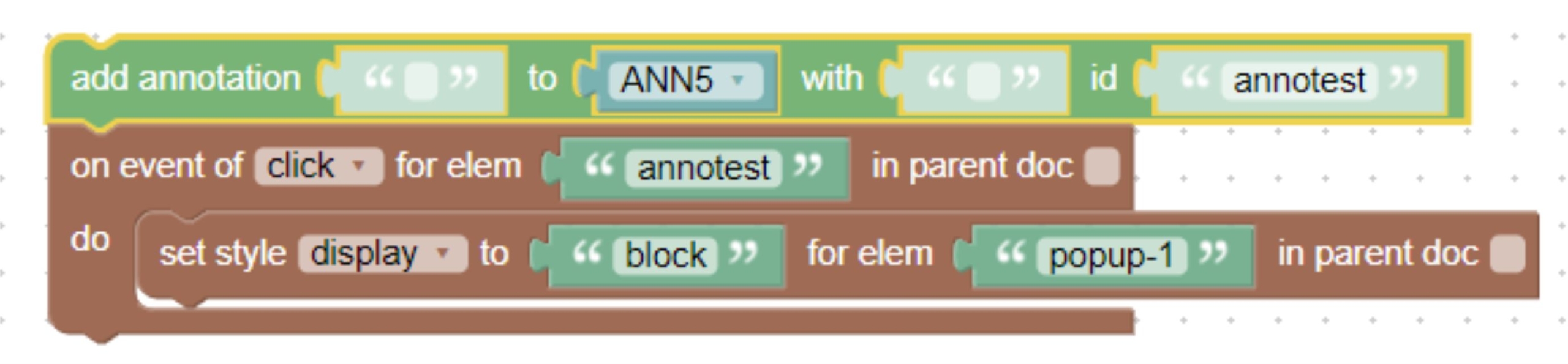

2020-09-10 at 7:51 am #32656vivektrivedi478
CustomerI tried but it’s not working
2020-09-10 at 7:57 am #32659
Mikhail LuzyaninStaffTry to set “in parent doc” for Set style element.
2020-09-10 at 7:58 am #32660vivektrivedi478
Customeralready tried
2020-09-10 at 8:20 am #32661
Mikhail LuzyaninStaffDifficult to say without seeing the project. If you can please upload it somewhere and put the link here.

2020-09-11 at 6:22 am #32714
Mikhail LuzyaninStaffI’ve manually changed Display of this block and seems the layout is broken, try to fix it them may be this setup will work for it.
