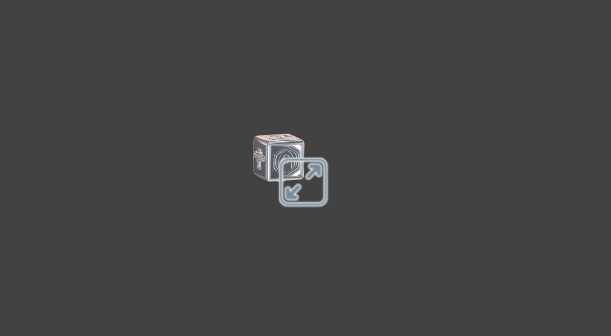

    how to put a close button in annotation dialog box.
    attached a reference image.

    the stock annotation may be too simplistic to implement that close button feature. However, you can add your own HTML element to the app and make it behave as an annotation using bind element puzzle
    #14418
    Crunch
    bipin, it might seem overwhelming but you are going to need to learn the basics of html and CSS.
    I would recommend https://www.w3schools.com
    I stuck with it for the past few weeks and its paying off. Here is a quick demo of what I think you are trying to do
    https://cdn.soft8soft.com/AROAJSY2GOEHMOFUVPIOE:e22b7f5039/applications/anndemo/anndemo.html
    Click on the cube to bring up a custom html element, the X button will close it.
    1.) Go over to the initiation tab (not the main tab*, I have found it best that if I am going to create any HTML elements via Verge3d app it is wise to create them in initit tab versus on the fly in the main tab. Tip: If you don’t want the html element(s) to appear on startup without any user interaction, set the display type to “none”.
    2) add a new html div element (see the screen shot)
    3) set the innerhtml tag to this (cut and paste what is below into field)
    <button id=”xcloseybutton”style=”float:right””>×</button> <h3>The Popup Annotation </h3><p> This is where you can add a much more robost annotation using custom HTML! </p>
    4) give the element a name (“alittlewindow” in this example)
    5)set the display style to “none” (this makes it hidden when you first launch app)
    6) in the main puzzles window… see the attached screen shot.
    A couple of pointers, the “&times” text in the button field is actually a code for an “x” symbol.. you can read up on this on the web https://wesbos.com/times-html-entity-close-button/
    The background color is “rgba(201, 76, 76, 0.3)’, that last number, the “.3”, is the opacity. Experiment with changing around the values .. it helps you learn. All of this looked like it was written in Greek to me when I first started learning Verge3d a few months ago. Now I am figuring things out and its getting really fun. Good luck!
