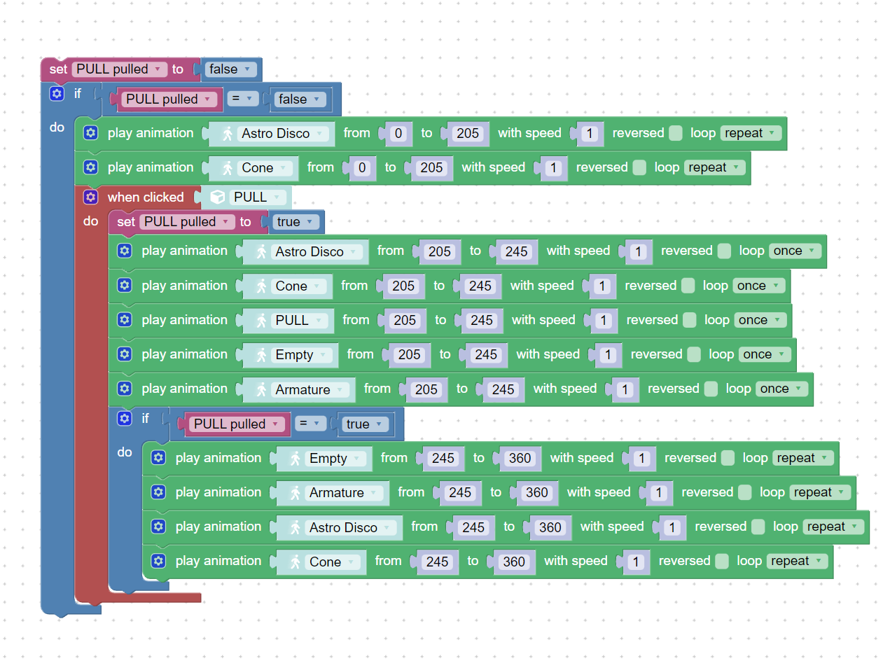

    I am hitting a wall working through an issue right now, and hoping you can help. I have created a scene in Blender with objects and a total of 360 frames of animation across the objects.
    I am looking to have someone start the app… have frames 0 to 205 play on repeat.
    Then if someone clicks a button… frames 205 to 245 play a transition
    Then… remaining animation loops frames 245 to 360.
    I know this is probably simple, but I have tried so many iterations of ‘if statements’ and setting my own variables during and before the click action.
    I have a attached my latest puzzle formation. The button action is pulling a lever. I have named a variable ‘PULL pulled’. Set as ‘false’ to start. When the object ‘PULL’ is clicked… ‘PULL pulled ‘ is true and kicks off the subsequent animations. Right now animation 0 to 205 plays constantly regardless of click, a click successfully initiates frames 205 to 245 (except for overriding the animation of the objects involved in frames 0 to 205), and frames 245 to 360 never play.
    Any help would be amazing!!!

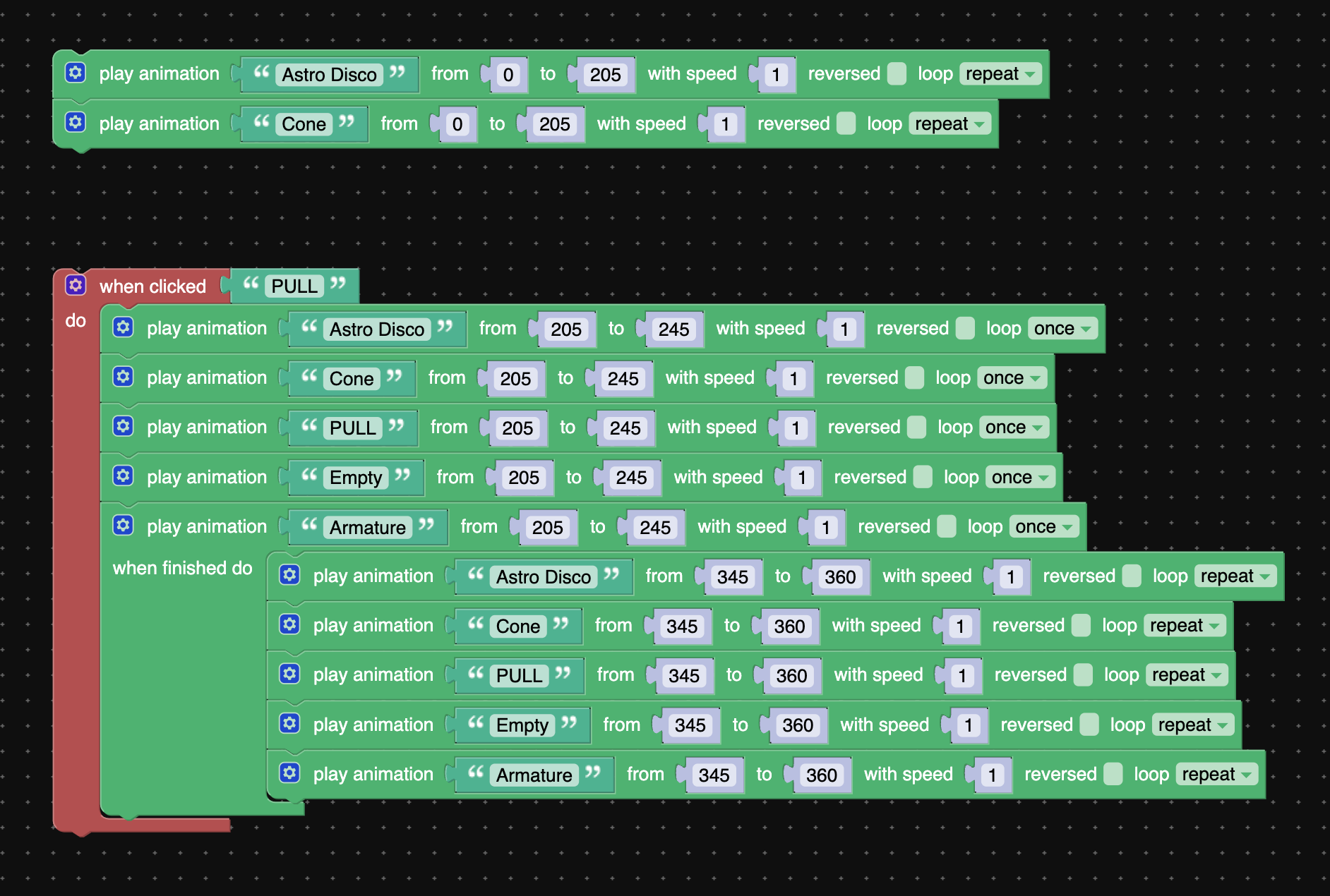

    #63199
    You may want to reorganize your puzzles a bit and take advantage of the When Done function in the play animation puzzle.
