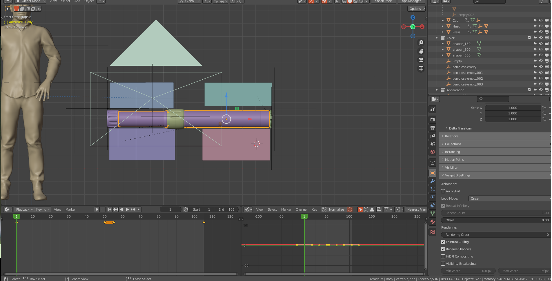

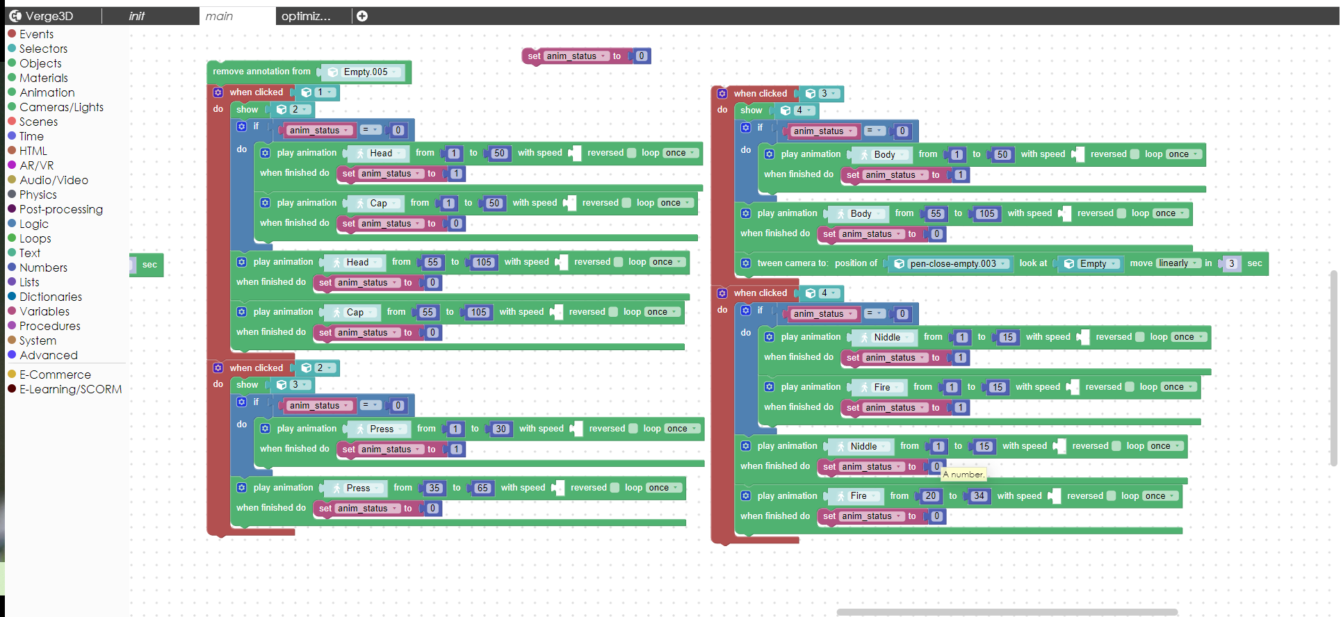

    I have a problem with animation. Hopefully I can understand by watching the video. When I click the button it is well animated. But when I click the button 4, the animation comes from the back to the front. But when you click again, it goes from front to back. When I click on button 4 the pen will move from its position towards the human model. It is doing the opposite without doing that.

    You have some of the puzzles that run the animation on the same objects at the same time, so sometimes one of them works, some times another. You need to make more clean structure when one aniamtion owrks when onother.
